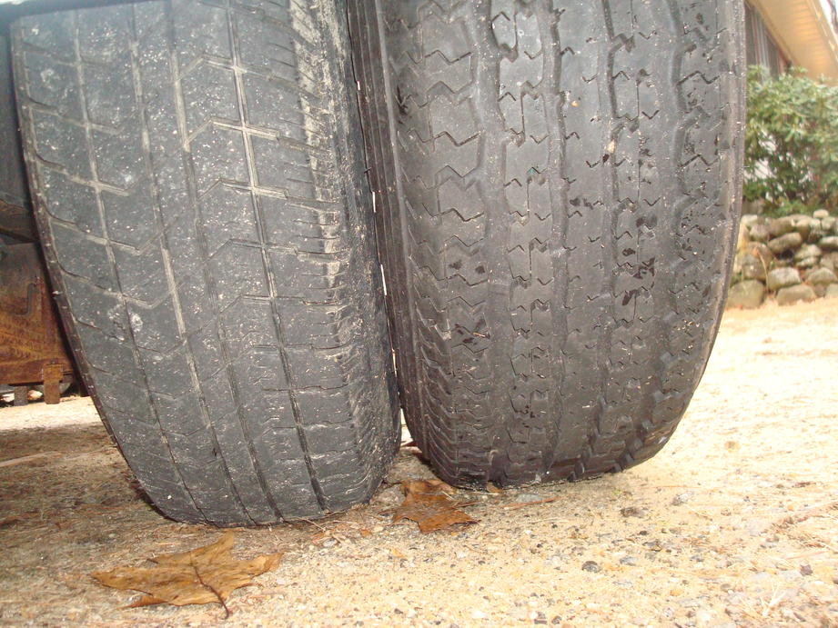

Both tires are 205/75-15 however the left one has weight on it and the other does not.
The tire on the left (a 40psi max tire) clearly shows that it not only appears to be more narrow, but the contact patch is smaller.
The tire on the right (a 50psi max tire) very clearly shows that it is wider and will provide a larger contact patch.
Same load range.
Two different mfg's, both tires belong to the same vehicle and all I had to do was walk out to my driveway.
With all due respect, if you want to see the respective contact patches of each tire with vehicle weight on them, you are going to have to come over and swap wheels. I have already put enough effort into this conversation.
I appreciate the banter but it is a known fact that different tire mfg's will have different contact patches even when using all the same criteria....size, vehicle weight, etc.....and it is only because of how they all assemble their tires.
UM....WRONG....
Width does NOT equal contact patch. Contact patch is the total area. In other words draw an area AROUND the tire it touches the ground. But on a tire that's not mounted...you have to be careful because there could very well be area's inside that are NOT touching.

UM....WRONG....
So, what you're suggesting is that a 195 has the same contact patch as, say, a 335?
Going on that notion, I suppose that's why we all see high-performance cars using econo-box sized tires since they offer the same amount of contact patch and therefore, grip.
As far as the tires pictured, the "skinny" 205 typically contacts the very center treads while the "wider" 205 contacts straight across.
Obviously the same amount of contact area. ;)
I didn't say that....Did you read the article I posted.
Read the article..and read what I said....
width NOT equal to contact patch....
width AND depth = contact patch....
You're just applying width.
