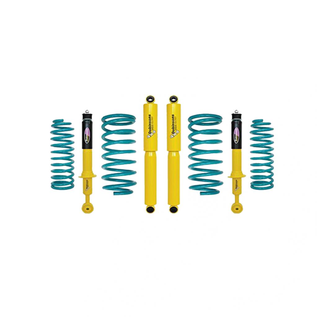

Hey folks,
Has anyone had experience with the Dobinsons 2” kit?
From what I understand, they are highly regarded in AUS, but still new to the US market so there isn’t much info / reviews for the 3rd gens.

Here are the specs for the front and rear
Front
Model: GS59-222
Type: Twin Tube
Valving: Digressive?
Extended: 18.31
Collapsed: 13.19
Travel: 5.12
Rear
Model: GS59-225
Type: Twin Tube
Extended: 20.87
Collapsed: 12.99
Travel: 7.87
I can see the rear travel is slightly greater than the Bilstein 5160, but haven't been able to confirm travel on the fronts Bilstein 6112. I'm stuck in deciding between Bilstein vs Dobinsons. Anybody have experience based recommendations either way? I've had a mechanic speak to the smooth ride of Dobinson's, but other than that I haven't heard enough Dobinson's user feedback.
