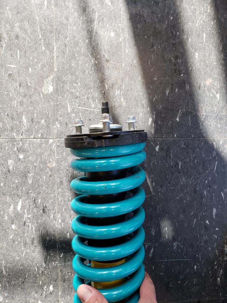

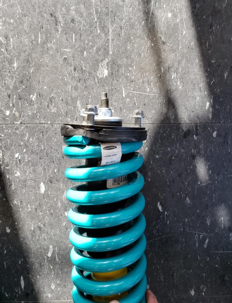

I attempted to assemble the front Dobs twin tube/yellow shocks with Dobs 134s springs and Dobs tophats with AutoZone rent a tools spring compressors and I just couldn't do it. I dropped them off at a local shop and they installed them but the top hat isn't even/level. Is this supoosed to be normal and will correct itself after installed and loaded.. See pics.
UPDATE per Mike at Exit:Yes, the coil puts pressure on the top mount when it's not mounted in the car, but as soon as it's bolted in and weight is put on the coil, it will settle down properly and straighten up.

looks funky to me, is that a dobs top hat ?

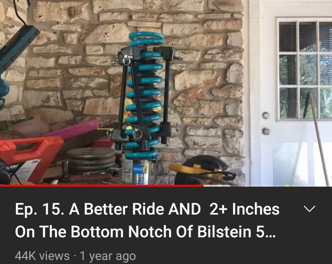

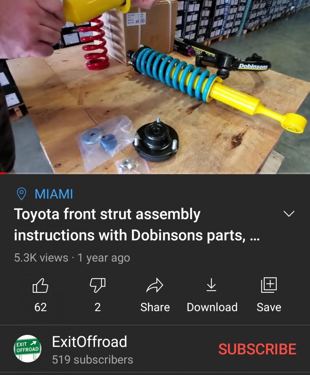

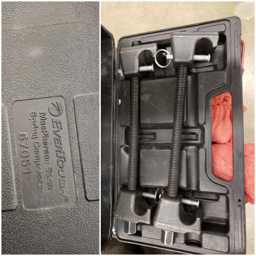

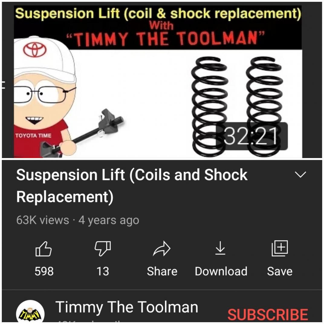

These are rental spring compressors I used. After seen the coils compressed, there's no way the retaining hooks/clamps would have come out after compressing them, they were already difficult to put in unsprung. In addition, it made it difficult for the shock cover to move and slide, it got pinched and jammed up. I just saw a video of a guy using 3 and had to crowbar the compressor clamps off. Which ones did you guys use for the Dobs springs?
Yes Dobs top hat.

Yes Dobs top hat.

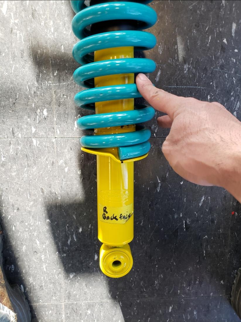

Once you put the vehicle on all 4 tires the coil spring presses even harder against the top hat/isolator. What does the spring at the bottom of the strut look like?
Seated in the pocket.
