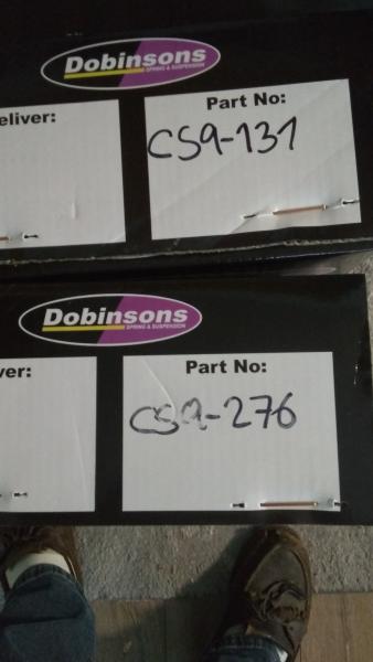

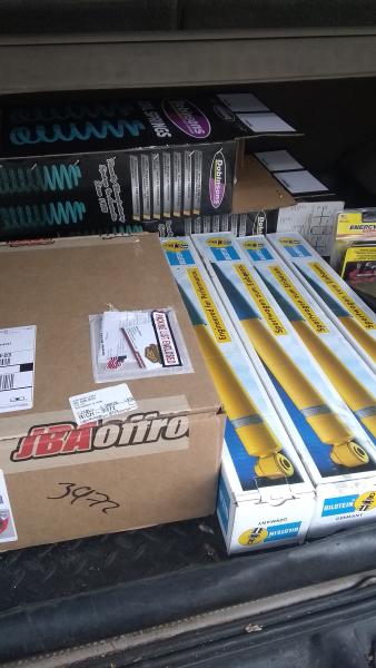

I replaced my old coils (Performance Products 2" lift coils and Bilstien 4600 shocks) because the ride had deteriorated to the point my truck drove like an empty 1ton P/U. They were over 10years and 100,000 miles old. These felt really good when newer, nice and firm but not harsh.
So I went with Dobinson C59-131 and C59-276 coils (10% firmer than stock) and Bilstein 5100 shocks.
My truck drives the same as with my old set up plus the truck seems to roll more on turns. The ride is very stiff, not firm. I can feel a wet toothpick on the road and every rut or bump. I was hoping they would be a little softer with new shocks and 'light' duty coil springs. Not happy with them.

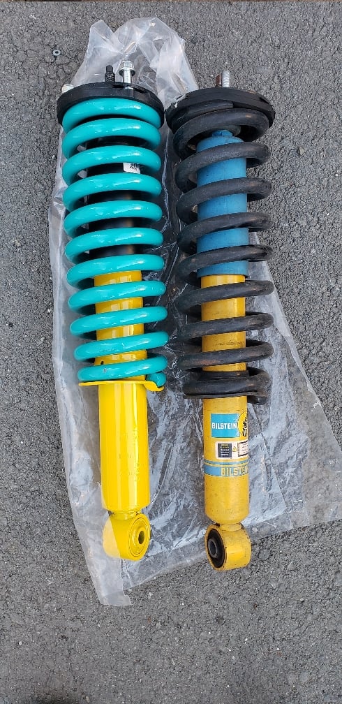

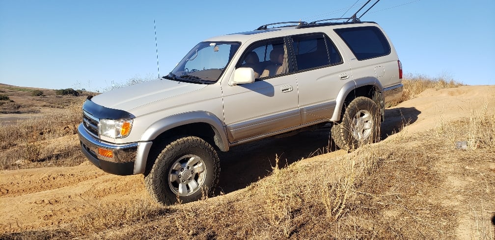

Pictures cuz every one wants pictures.
Frt~23.5" frt hub center to bottom of fender. Rear ~25" hub center to bottom of fender
This is lift setup I had prior to installing the new coils and springs. center of hub to bottom of fender was ~23.7" front and rear.

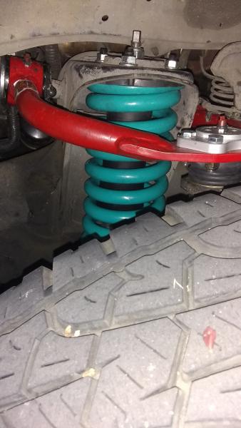

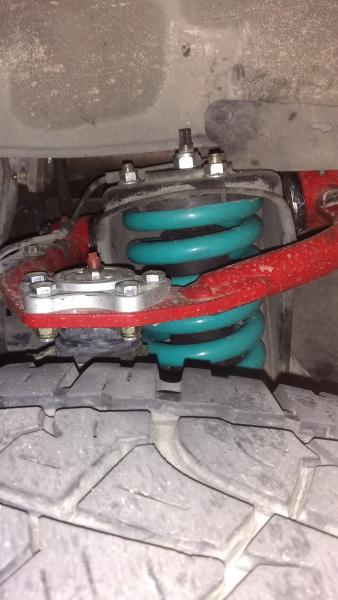

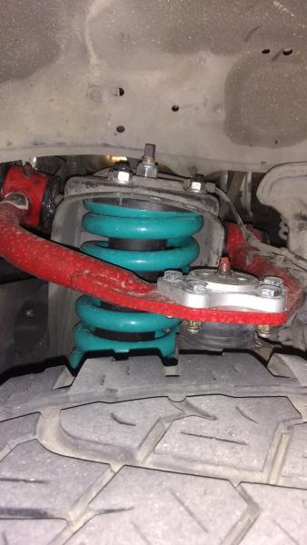

What do you mean by assembly orientation? I was told by Dobinsons there is no difference in sides and my truck might need a right side spacer to compensate for the extra weight on the driver side. My truck did not need one, it sits level. But they didn't say anything about spring orientation.
Here's my driver's side.
My passenger side.
Interesting, mine were labeled Passenger and Driver written on the box. I had to call this morning and tell them about the top hat/lower shock eyelet being out of alignment to fit into vehicle. Dobinson's assured me that the components are the same on each. But they were off in assembly.
Ended up going to a shop to use there soring compressor and rotate correctly to fit into vehicle. Turned a few hour project into a day and a half. [emoji2363]

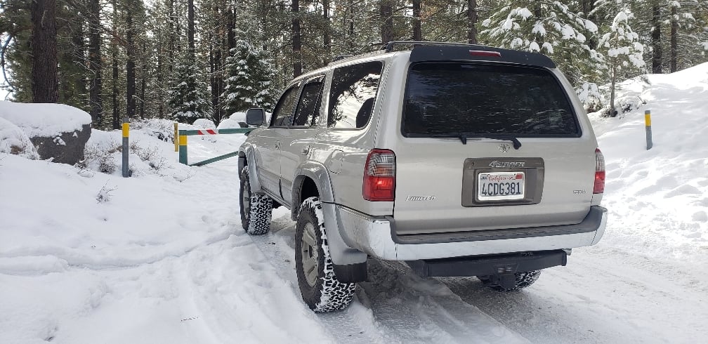

I'm nearly 2500 miles on them in a month, lol. Putting in work on and off road. I'm really happy with the product. One of my biggest concerns was how they felt/handled on washboards. Night and day difference! Even at higher tire psi. I am curious though, how much more flex/travel/articulation I may get out of longer sway bar end links and/or panhard bar drop bracket. I've read, up to another 1" of travel, but I haven't been convinced yet either way.
As far as needing the strut packer or whatever it's called to fix the "Toyota lean", I opted not to and it's flush even in front. My first measurement was nearly 1/2" lower in the rear driver side compared to the passenger rear, but that could've been on a full tank gas. As far as I'm concerned it sits pretty damn level, or negligible to the eye. I'll post some pics on/offroad, but I don't like how some appear to show up and others don't on this app.
Feel free to ask any more questions you may have. I wish Dobinson's would credit me something on future purposes for their mistake on assembly, but I was told that it's "normal" to have to make some adjustments. They should state that online and/or upon ordering.

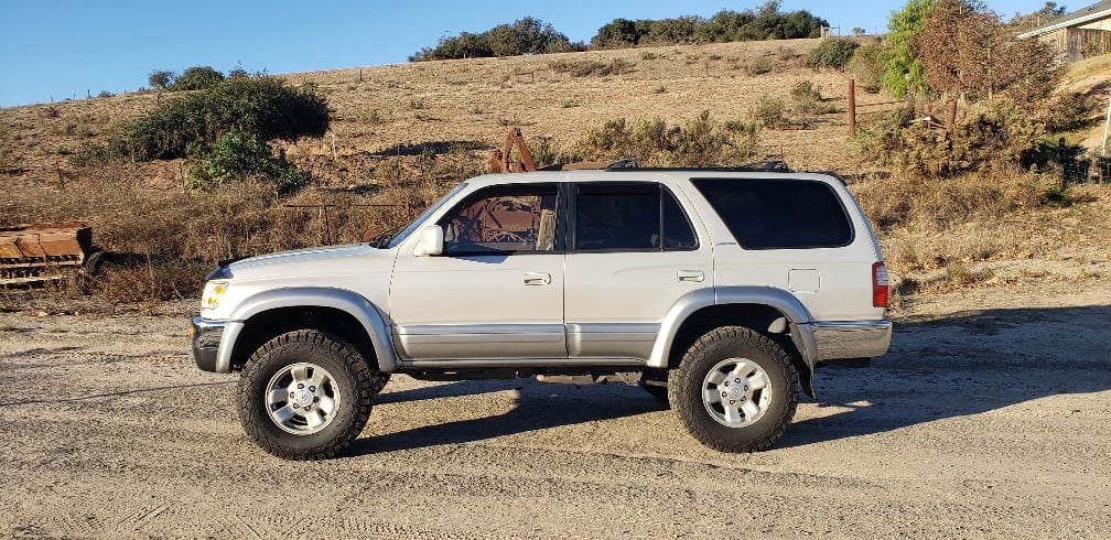

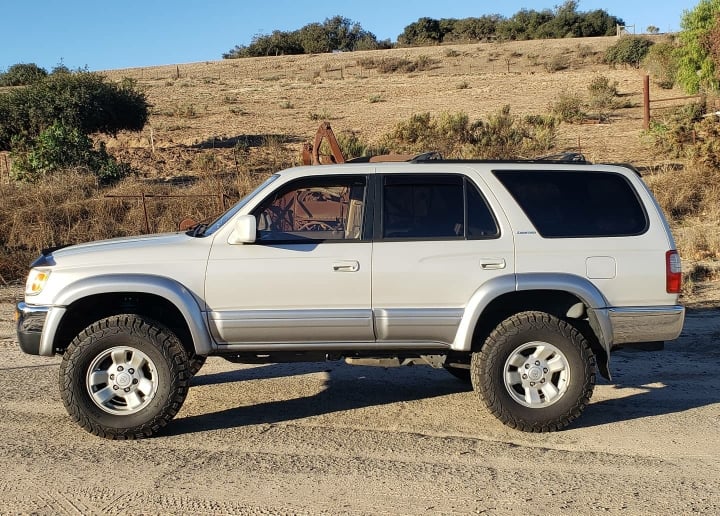

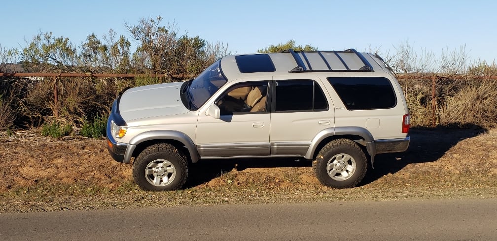

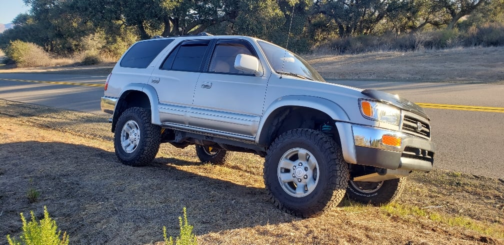

Very nice rig [MENTION=609620]cheezPoof_4x[/MENTION]. Love those wheels too, something about the old school design. What size tires? Ever considered spacers spacers (1.25s/+)?
I really do like the wheels! I know the 5 spoke are desirable and I too wanted them when shopping for the vehicle, but damn these have REALLY grown on me. I'm not in a big rush to upgrade, mostly because of cash that can be averted to some other things higher on my list.
I have actually thought about wheel spacers to give that wider stance(I like the look), but I have a couple concerns:
1) wheel rub on the stock fender flares
2) I'm not sure if the wider stance is better or worse for offroad traversing.
3) quality of the spacers themselves for durability and any effect it may have on ride/tire wear.
I'd consider it more if I could fine a quality set that is less 0.5-1". [emoji2375]

[MENTION=643737]da_dre[/MENTION] UPDATE...to confirm the front coils are the 238. They are labeled on the box(in Sharpie) "238/222" with "26391" underneath it.
Sent from my SM-G965U using Tapatalk
Thanks man.. The 222 is the 4runner specific shock #.
