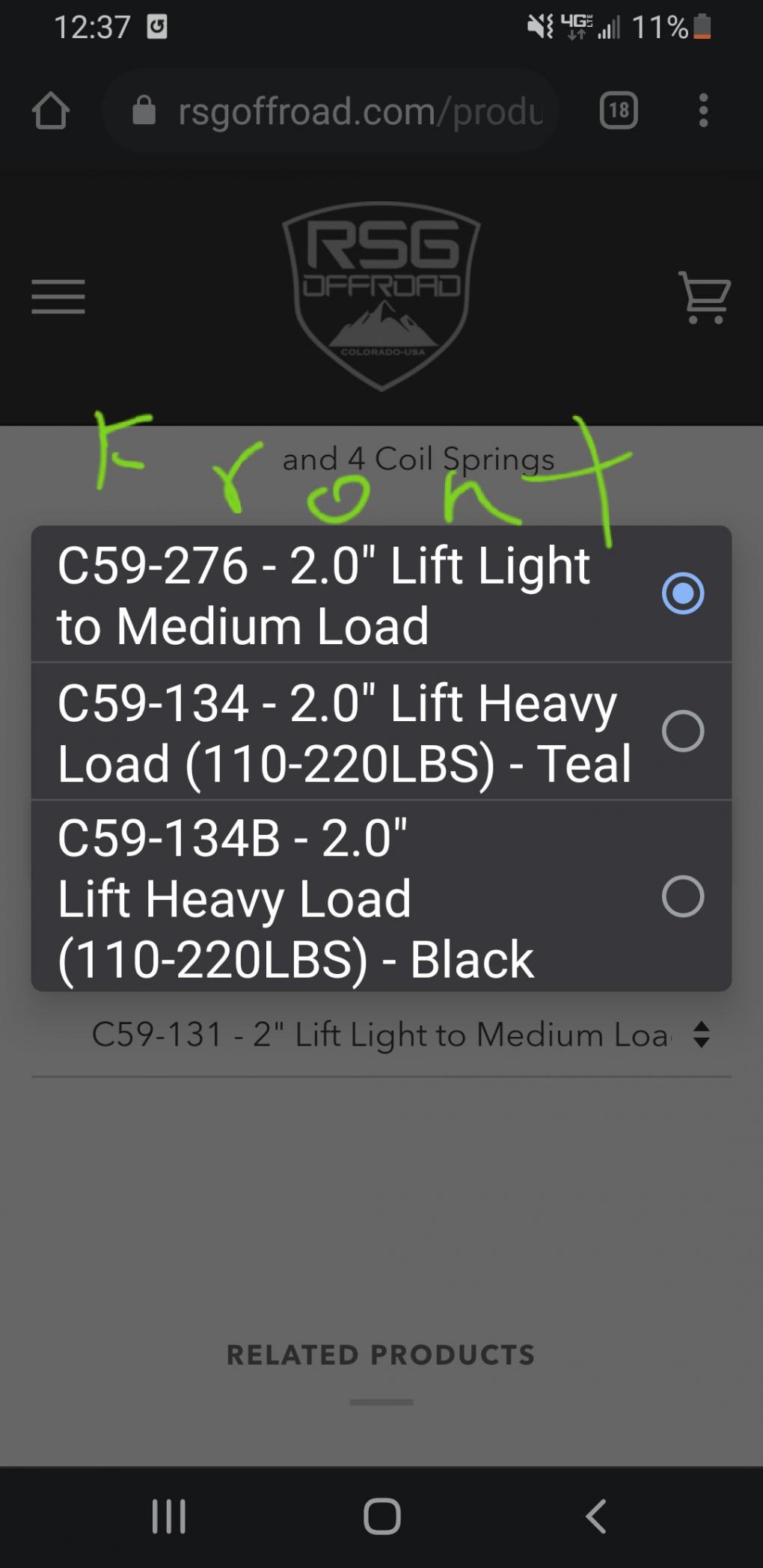

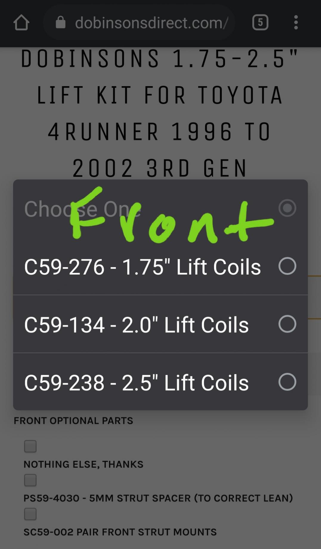

Part # options/descriptions for 3rd gen front coils seem to be different on all sites.
FRONT
C59-276 (1.75" lift) Dobs. com
C59-276 (2" lift light-Med load) RSGoffroad. com
C59-276 (2" lift light to medium load) Exitoffroad. com
C59-134 (2" lift) Dobs. com
C59-134 (2" lift heavy load 110-220LBS) RSGoffroad. com
C59-134 (2" lift heavy load 110-220LBS) Exitoffroad. com
C59- 238 (2.5in lift)
REAR
C59- 131 (2in)
C59- 137V (2in 220lbs load)

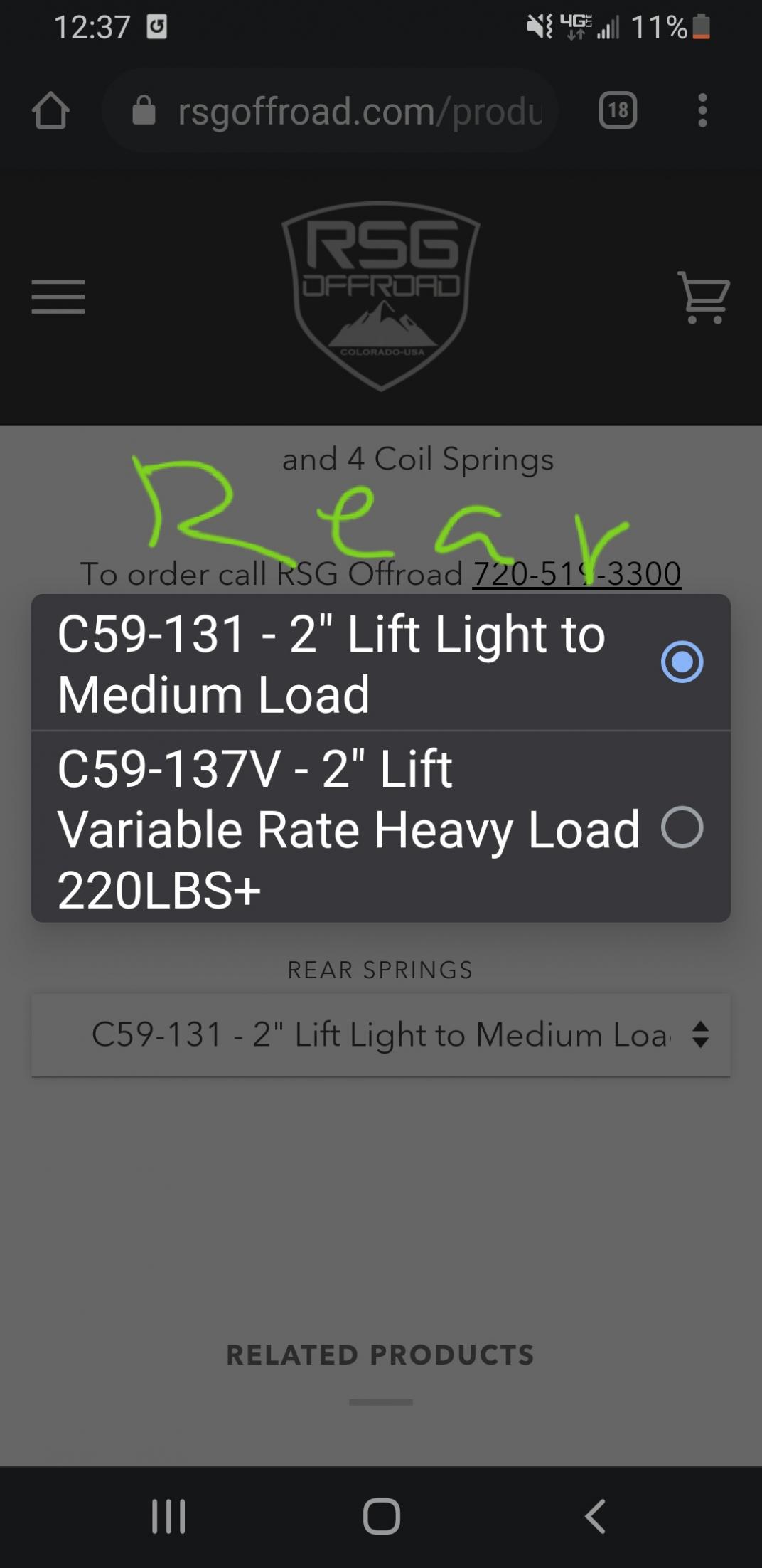

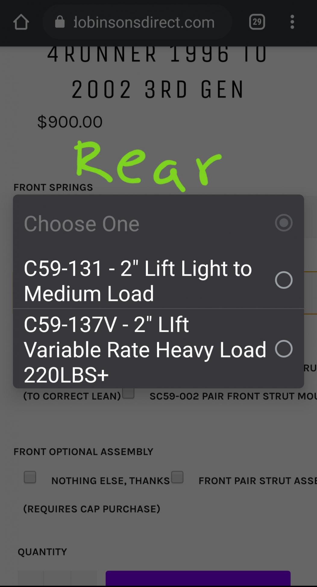

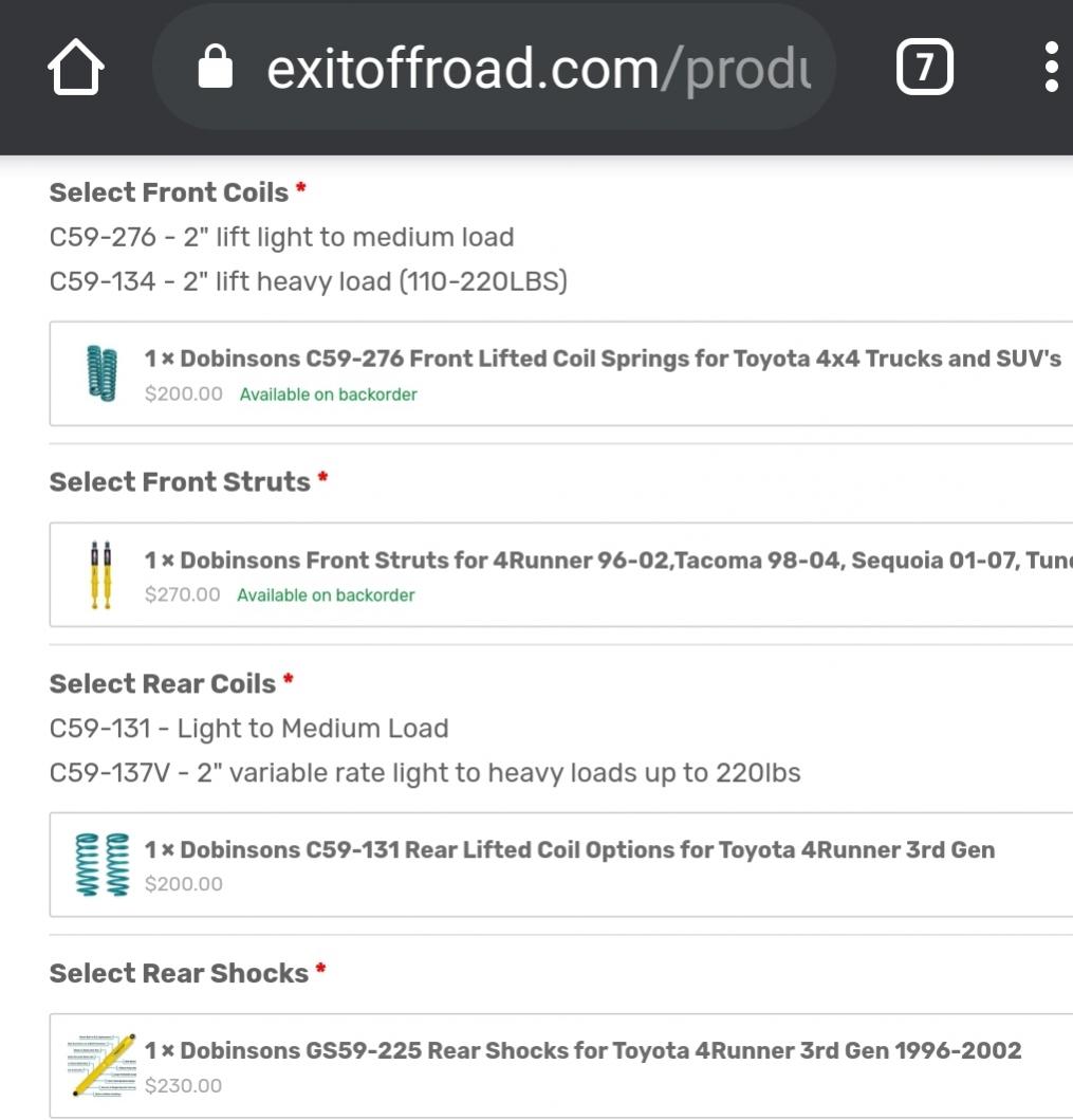

I will not run any front or rear bumper/armor. I don't want Bilsteins, I want a full Dobs set up (not IMS/black ones). Can anyone with an ALL Dobs set up and their experience provide their insight on 276 or 134 springs for the front to achive a 2" (slight rake or level is okay) lift with REAR C59-131? Will the 134 he harsh due to less travel?

More info of options and descriptions

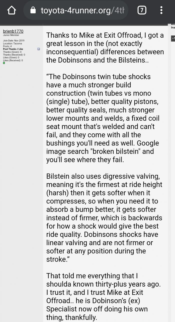

Bilsteins vs. Dobinson's shocks info for those with the same dilema or question.
http://https://www.toyota-4runner.org/4th-gen-t4rs/269801-help-me-decide-dobinsons-bilstein-shocks-2.html
But then reading this leads me to believe that twin tube is not going to offer comparable performance next to a mono tube outside of daily driving applications:
Monotube and twin-tube - KYB Americas
Twin tube design seems to only offer greater protection offroad, but at a cost of performance. I guess depending on the frequency you'll be hitting the trails and with what kind of load will ultimately determine what you want to end up with in relation to your budget:
Shock Absorbers for the Offroad – Shock Surplus

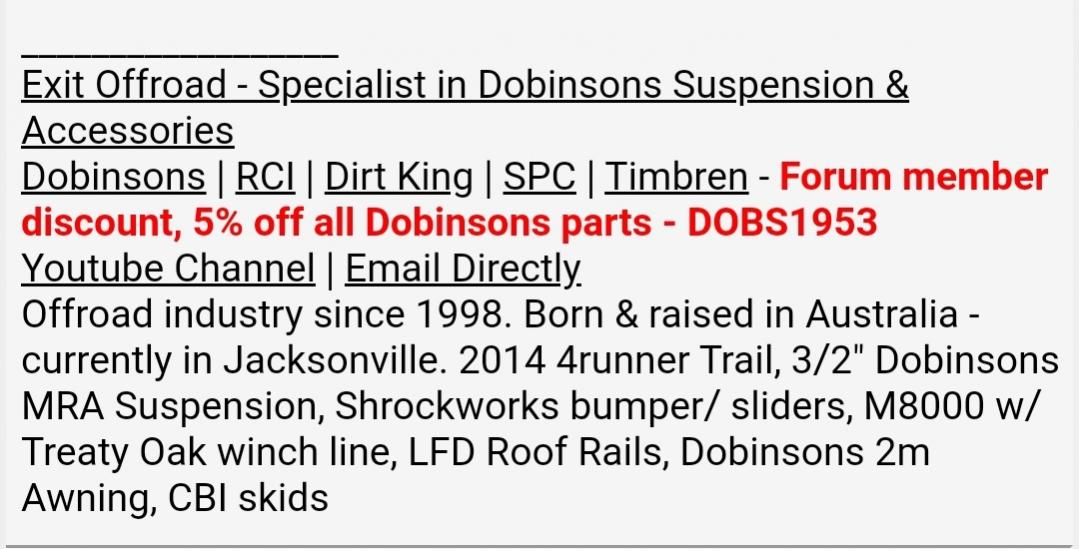

Sharing: forum members coupon code for Dobinson's from Exit.

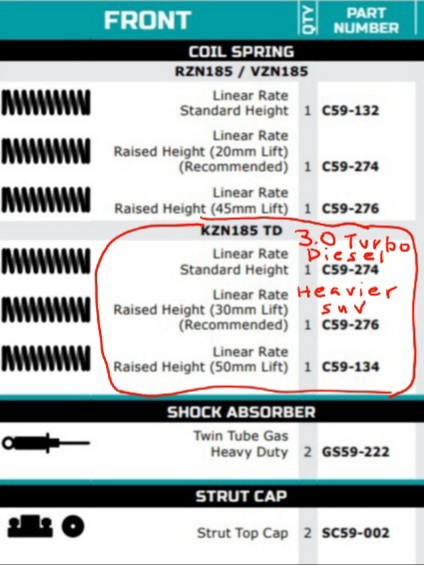

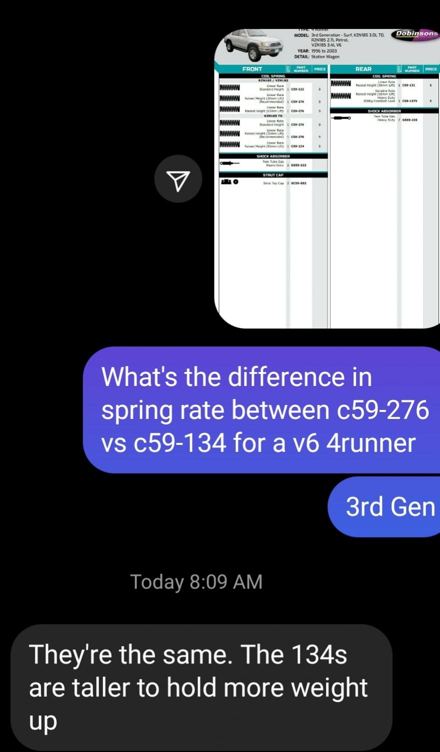

Sharing: from a credible Dobs vendor about spring rate differences:
[MENTION=643737]da_dre[/MENTION] can you download that image to repost it here? I can't read the writing, but I'm interested to know. Thank you
Sent from my SM-G998U1 using Tapatalk

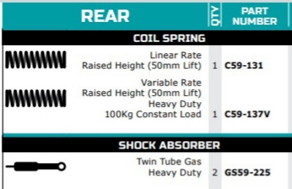

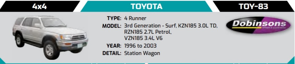

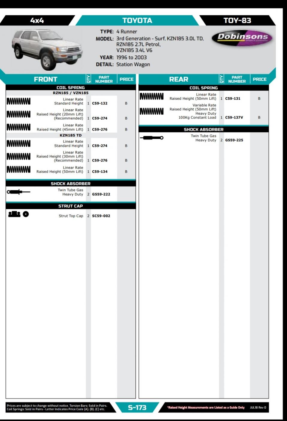

These images?, if so, it's from Dobs catalog. I cut the sections up and zoomed them in. 2.7 and 3.4 motor vs 3.0 Turbo Diesel results in diff mm/in. lift due to weight of motors.

Bit confused, I had read, and some pictures look like the springs are progressive ( which I lilke) then some look like only the rears are progressive.
