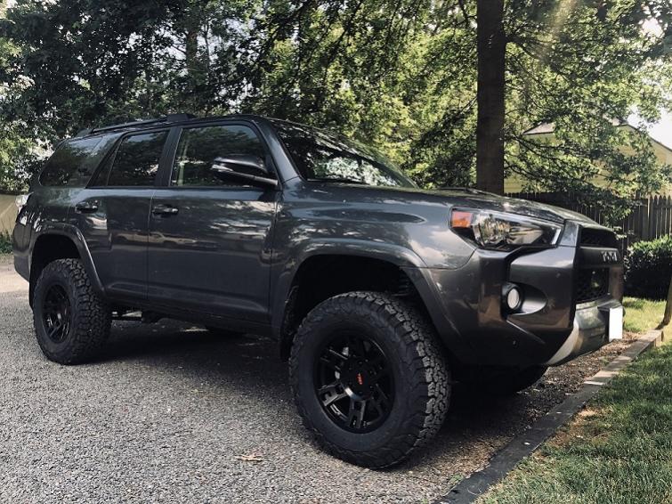

Got my setup installed. Ride is much improved. 2.5 front and 2 rear looks perfect to me, bigger than it sounds. 285s with 1.25" spacers fit perfectly with a little trimming on the bumper and removing the front mud flaps. No BMC!
Front C59-302 / GS59-700
Rear C59-725 / GS59-70
JBA UCAs
Nitto Ridge Grapplers passenger rated, nice and quiet but difficult to balance.
Overall, thanks to everyone in this thread, especially Mike.

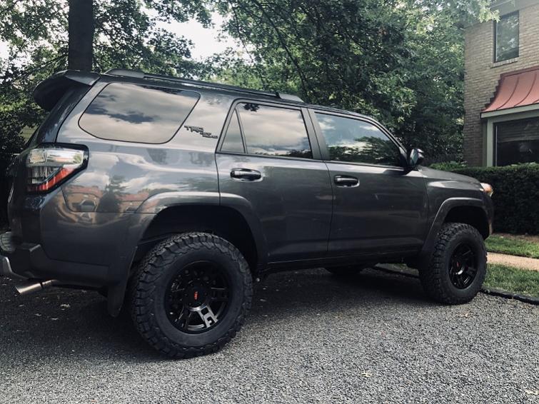

Threw my kit on last week. Dobinson twin tubes w 302 coils (2.5") in front and 505 coils (1.5") in rear. Rides so well. No KDSS, nose dive and body roll significantly reduced, takes small and big bumps better than stock and way, way more responsive. Doesn't feel like a marshmallow anymore. I put 275 KO2s on with FN FX 0 17x8 0 offset wheels, and I'll have to push the front fender liners up an inch or so since there's rub in reverse, but that's due to the aggressive offset compared to stock wheels.
This is a great kit for a great price and super simple install. The trickiest part is just getting a buddy to help get the axle way down for 1.5" lift coils to fit in there. Everything else was super simple. Took about 3 hrs with jack n jack stands.
Mike was awesome to buy from and answered all my questions. Couldn't be happier with this kit.

I have the same setup arriving tomorrow. I hope mine ends up just like yours. That is exactly the stance I’m looking for.

That looks great!! Same color as mine.
Looks good with that combo of wheels and tires too. Almost time for me to get new tires, so I've been watching closely what everyone else has been using.
