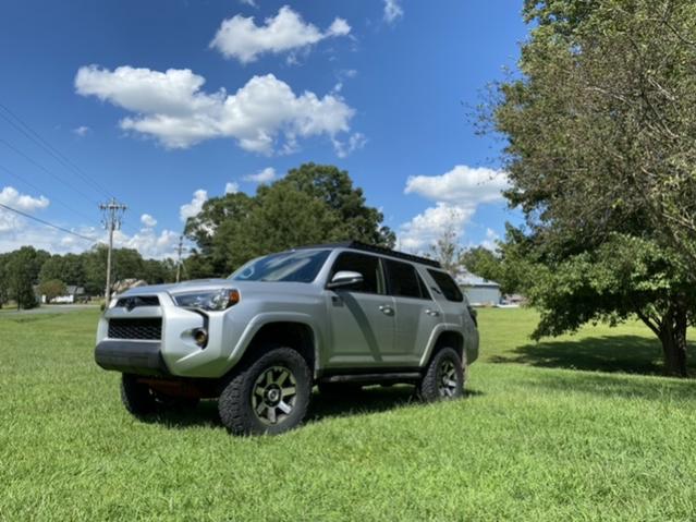

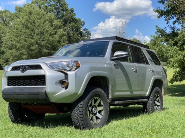

Hey Mike, finally got the IMS setup installed and I have to say, I’m impressed in the first 130 miles I’ve put on it (all highway coming back from the shop).
I got a great wheel balance and good alignment to do that sure helped make her ride smooth.
Quick question, I didn’t see them on your site but I need some adjustment wrenches as mine didn’t come with any? I did have you guys install and set everything up so I’m not sure if they were or weren’t supposed to come with them or not?
Anyways, here are some pictures!
The wrenches should have been included with the shipment, as they come with the IMS struts. They're black, should have been 2. Send me an email, reply to your order confirmation and I can track some down for you.
Truck is looking great, and glad you're happy with the results!!
