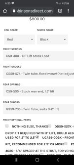

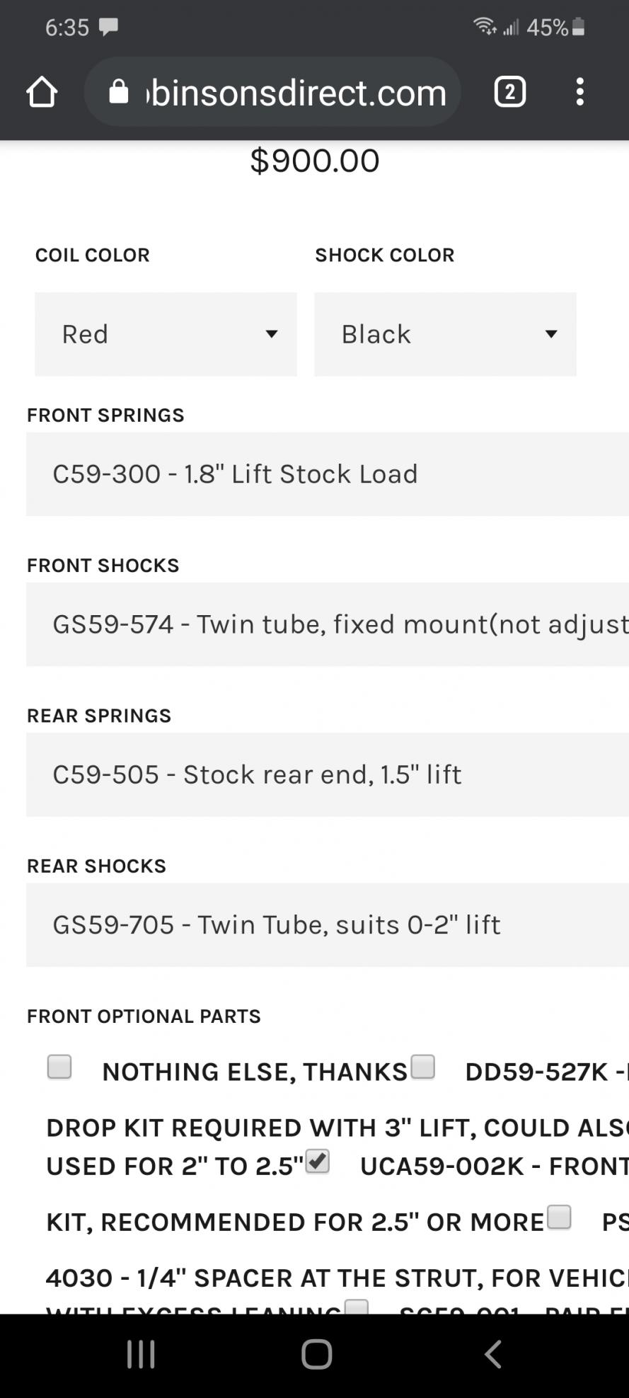

Been all over this forum since I got my 2020 SR5. The picture attached shows what I end up with. Now my question and concern is about the front GS59-574 extended shocks... would that make the ride quality a little more harsh?? This truck is my daily and unfortunately living in Florida I can't really offroad much if at all . I mainly got the vehicle for road trips a couple times a year and getting it in a trail here and there if I get the opportunity. Because of that I want to keep it as conformable as possible for my daily commute. The reason I end up with that setup is because it gives me the exact ride high I'm looking for and in reality I don't plan on adding any permanent heavy equipment for the time being.

Harshness will come from the stock UCA's not having a lot of travel left in them when it's lifted close to 3" up front with that combination. You'll want to look at upgrading those at some point to help with that and also to get your alignment caster into spec as well.

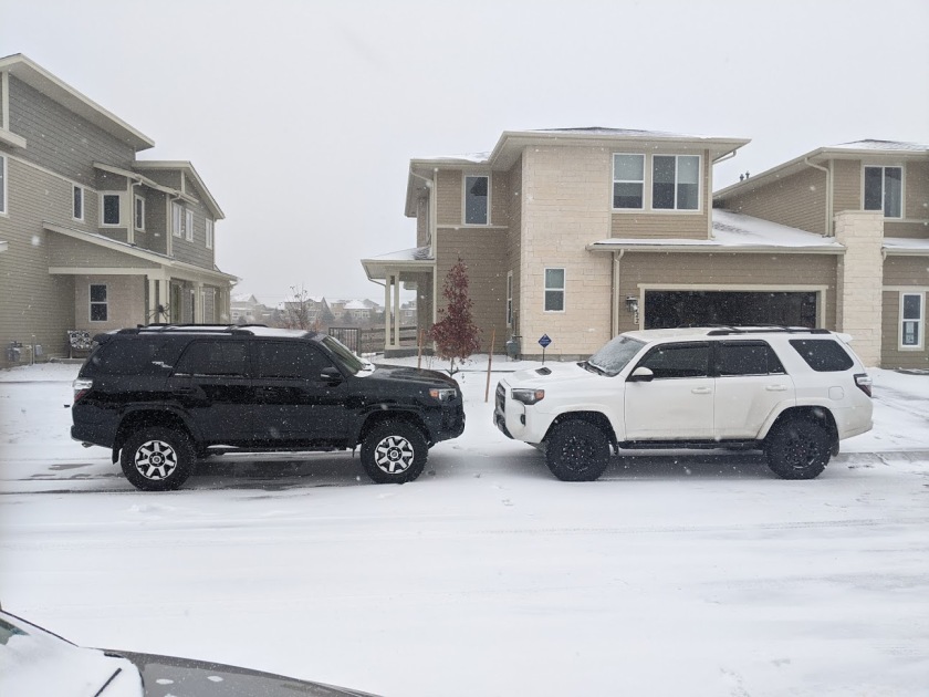

In this photo the black truck has 302 front coils and 725 rear coils (325 coils with a built in 15mm offset for KDSS lean). The white truck has 302 front coils and 505 rear coils.
