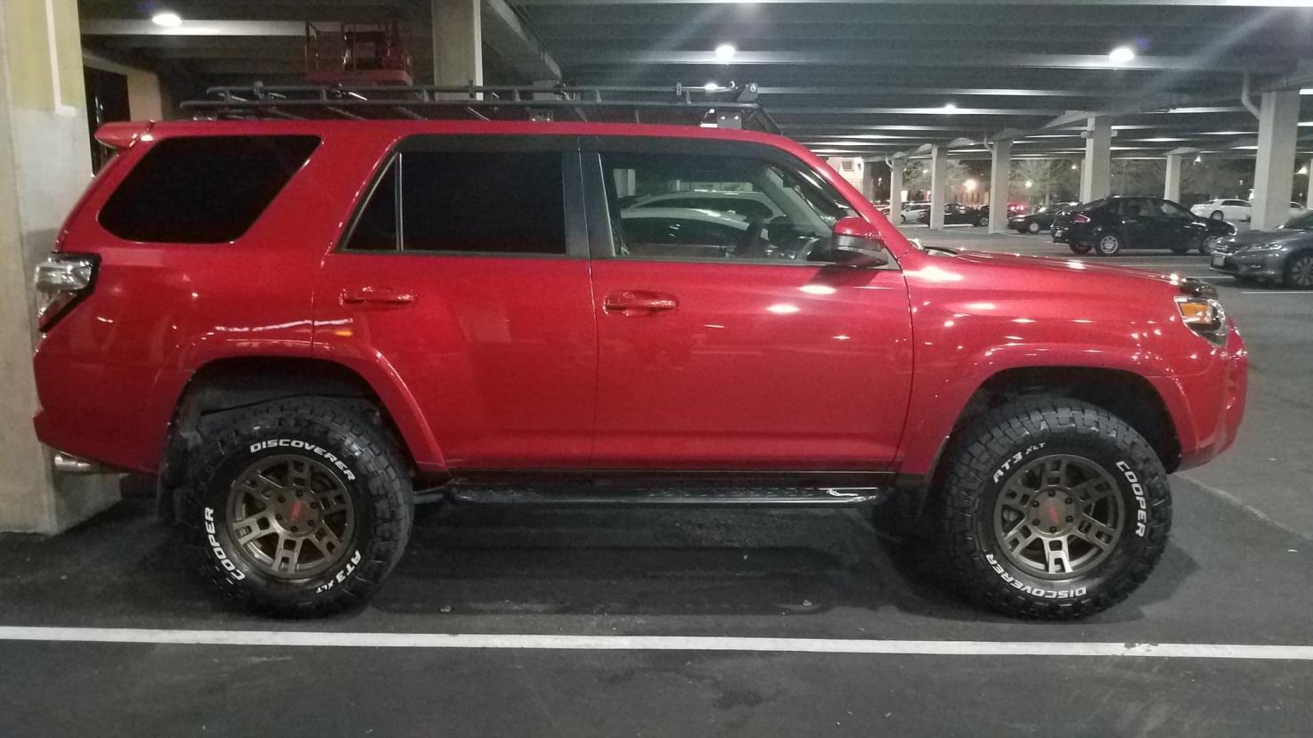

I know you addressed it to Mike, but I’d liked to share my experience. I have the same trim 4runner, 3rd row as well. I went with the 302s, 2.5” fronts and 505, 1.5” rear paired with Bilstein 5100s. Stock UCA, no diff drop. 285s with Fn Pro X wheels installed in 2016. I do carry additional weight, full skids, rack, sliders, and full size E load spare. All seven seats occupied (our family makes them small too. Lol) and small travel bags loaded into the rooftop carrier, I’ll get some squat, I prefer rake. As the kids are growing slightly bigger, I just changed out to the 327s for 200-400 constant weight. I feel it rides better, but I will be changing the rear shocks since it seized on the lower bushing on the the driver side during install of the rear coils. I have UCAs and diff drop in the garage, just never installed them, alignment was good, no wandering. The picture attached is with the original setup no people inside. I hope it gives you an idea, but without the additional weight and riding around town with just people, no heavy mods use the 325s for the rear and the comfort feature.

Thanks for the info and photo Nicakdemus! I'm leaning towards a similar route as yours now. And at least now I know I can just upgrade springs if I do decide to start adding more weight the ride.
