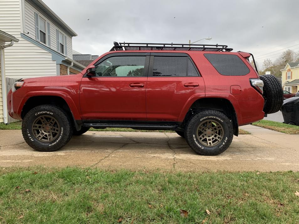

Shout out to Mike...Great customer service from the first time I reached out...
I ordered front 238 coils for a 1" lift in front, but maybe ended up 300s as I got a full 2" on both sides in front. 599s out back gave 1"

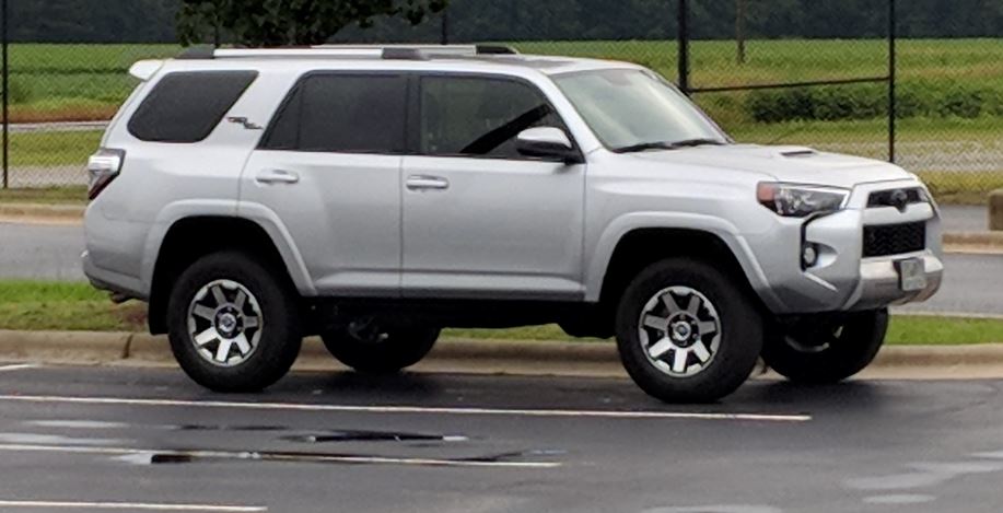

Finally posting having installed last month. Love how it drives compared to my previous setup (6112/5160). Should have gone this route out the gate.
- Dobinsons IMS Front Struts & Rear Shocks
- Dobinsons C59-300/C59-599 Springs
- SPC UCA
Didn't take any pre/post measurements unfortunately.
1st pic: 6112/5160 (1in preload in front and stock rear springs) and 265 Falken AT3Ws
2nd pic: Dobinsons setup listed above, SPC UCAs, and 265 Falken AT3Ws
3rd pic: Dobinsons setup listed above, SPC UCAs and 285 BFG KO2s
Thanks Mike for talking me through the options and providing good instructions on how to do this myself. The KDSS steps you provided actually helped get rid of lean that I had my previous 6112/5160 setup.
