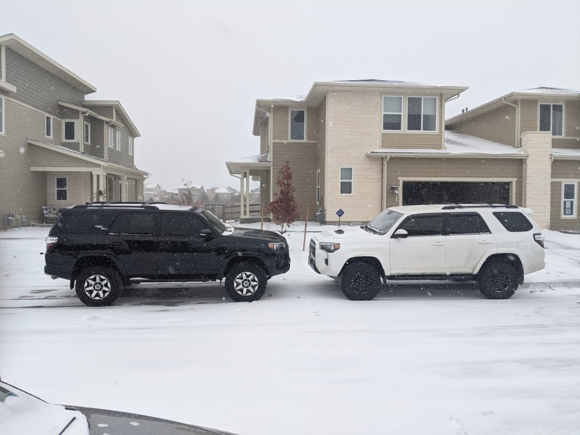

That's a good combo - relatively the same to what this white 4Runner has (he the same coils but has MRA shocks). The black 4Runner has similar proposed shocks (IMS, standard length + comfort rear) and front coils but with 325 eq. coils in the rear(discontinued kdss lean version).
The front lift on both these trucks measures out a hair over 22" center hub to fender. The rear on the black truck is about 0.65" higher than the white truck. Hope this helps!
Tire size, black 4Runner = 255/80R17 (33.1"x10")
Tire size, white 4Runner = 265/70R17 (stock)
Thanks for the picture, that definitely helps, as well as some confirmation that my choices may work. I currently have stock size as well so it is nice to see too. These upgrades are a slippery slope haha.
