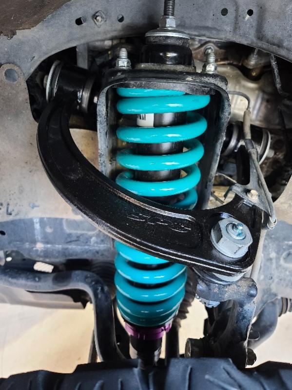

I went with 2.5/1.5 C59-302/GS59-700 front and C59-505/GS59-701 rear. The fronts gave me exactly 2.5in and the rear ended up giving me 2 inches. Wish I would've known the rear would give me more because I would've went with 3 in front for levelish lift. Not really a fan of the way it looks.

After a few hundred miles, I'm at 3.5in front and 3in rear total lift. In that pic, the springs hadn't settled and it was around 4in front and 3.5in rear. The back will go down more after I install a drawer system and put recovery gear in it.

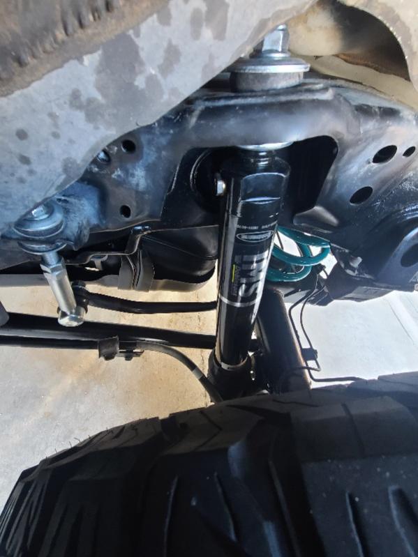

I have 59-505's on backorder to correct the rear end on mine. I have Eibach 1" and they looked great until I added a drawer in the rear.
I'm hoping with the added rear weight, I will get around 1.25-1.5 (assuming your measurement of 2" is not settled)

It's settled at 2''. So yeah, you'll probably get around that if you have added weight. Unless the 505's you get don't exactly give you 2''.

Got my suspension all installed and Mike advise was spot on. The stance is perfect to what I wanted with a slight front rake. Thanks for everything and will post pics shortly.
Pics as promised.
