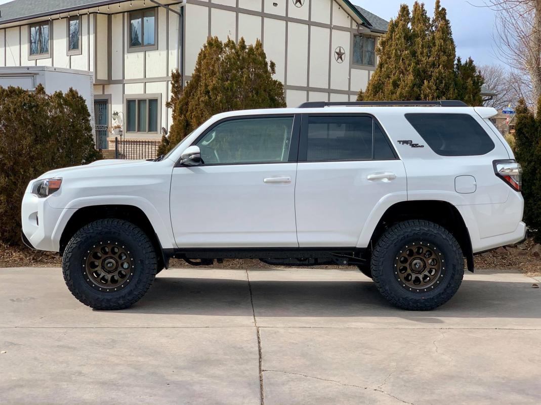

I went with 2.5/1.5 C59-302/GS59-700 front and C59-505/GS59-701 rear. The fronts gave me exactly 2.5in and the rear ended up giving me 2 inches. Wish I would've known the rear would give me more because I would've went with 3 in front for levelish lift. Not really a fan of the way it looks.

I went with 2.5/1.5 C59-302/GS59-700 front and C59-505/GS59-701 rear. The fronts gave me exactly 2.5in and the rear ended up giving me 2 inches. Wish I would've known the rear would give me more because I would've went with 3 in front for levelish lift. Not really a fan of the way it looks. Might have to swap out the fronts..... FML
Honestly I think it looks fine. I prefer stock/factory rake anyways. Once you load stuff down you'll be happy you had some rake so that you're not ass down. Before you swap out springs I'd let it settle a little. I thought my rear was way too high in the beginning but it settled a bit and the rear came down just a smidge. Plus when I'm fully loaded there is still some rake and I'm fully supported in the rear without bottoming out. Give it some time and then reassess.
