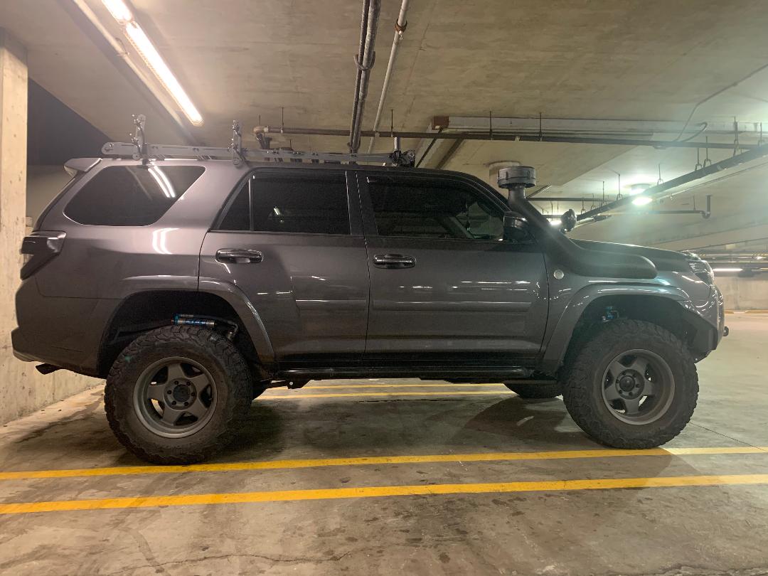

OK so just real quick, because I haven't had it back long enough to get offroad or drive much, but the IMS system is badass!
I'd spoken to [MENTION=148378]Crikeymike[/MENTION] to help me come up with a system to fit my desires. He delivered and then some. The 302/574F and 327/701R setup he recommended is very smooth riding on the road, even when some of the roads are pretty bad (normal for out in the country in South Louisiana). Even with the 285/70 C load at 40psi (vs stock 265/70 SL at 30psi), it rides smoother and more controlled than my stock ORP suspension. Then add to that, he upgraded my UCA's at no extra charge because he wasn't sure when the Dobinsons UCAs would be in... you can't ask for better customer service anywhere.
Hoping to get it offroad and check it out (including measurements and just the slightest bit of trimming) in the next few days, before having to go back to work. This is just a quick pic I shot after getting it back home.
