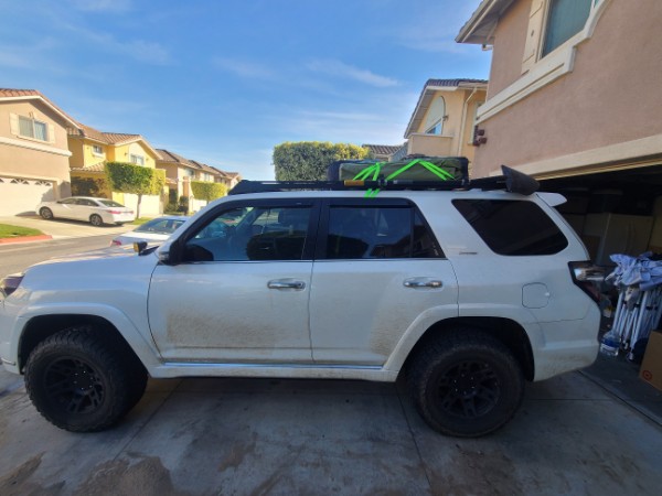

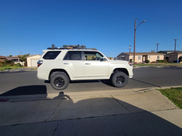

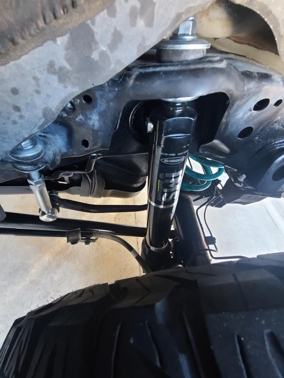

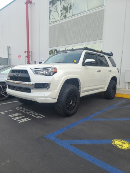

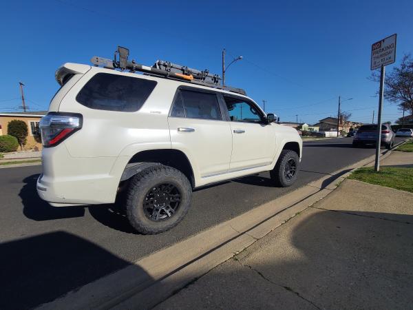

Thanks for the awesome pics.. I have the same IMS setup coming to replace the same Daystar-spaced XREAS as yours.. How does the IMS ride compared with the XREAS?
Not even in the same planet. IMS ride super smooth, like butter. With XREAS and spacers you feel alot more springy when on the gas and brake, this is probably due to the preload on the coils, but with the IMS setup feels alot more like a good suspension is suppose to feel. I noticed the difference right away going over speed bumps in my neighborhood. With spacers feels more harsh especially when your rear tires roll over the bump and coming up and over the bump, you feel your coil tension release and slam the asphalt like as if your shocks can't dampen the spring load. Mike was able to give me the exact specs I needed to achieve my 3/2.5 lift and he was spot on.
Also I installed it myself and deleted all the XREAS including the pump, and hardlines and it was not hard at all, just a little time consuming. Let me know if you'll be attempting install on your own and let me know if you have any questions.
