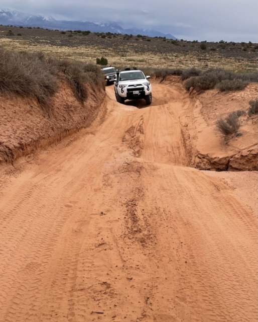

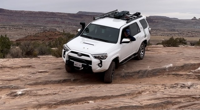

302's up front and 505's in the back for 1.5" is more common. Yes, the 325's are 2" with a 3rd row and like 2.25" without it.
With 2.5" front and 1.5" rear, you'll still have about 1" of rake which is enough for most people.

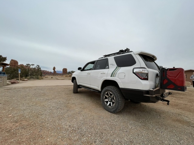

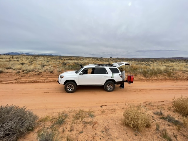

Moab tested, Mrs. Bigdaddy approved.
Lots of flexing,
500-700lbs loaded in back,
hours of time going 30-40mph on corrugated roads,
600+ road miles.
Happy as a clam with my Dobinson’s setup.

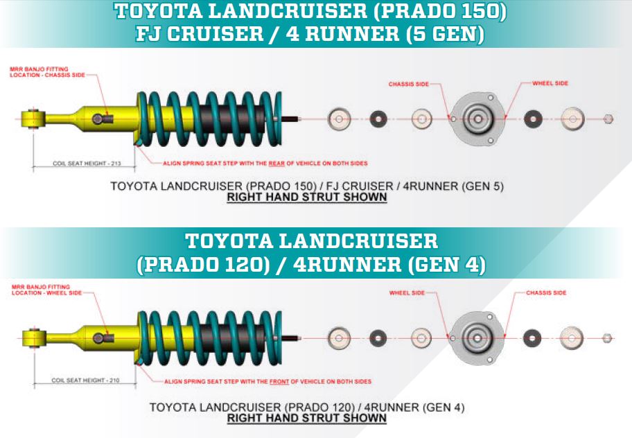

I have a 5th gen 4Runner with GS59-700 and accidently installed one of my strut assembly with the lower spring seat step facing the front of the vehicle. Will this cause any problems?
286532d1519170779-dobinsons-5th-gen-t4r-suspension-options-lots-choices-strut-assembly-sequence-jpg
Mike,
It should be fine. The sway bar link should still clear it

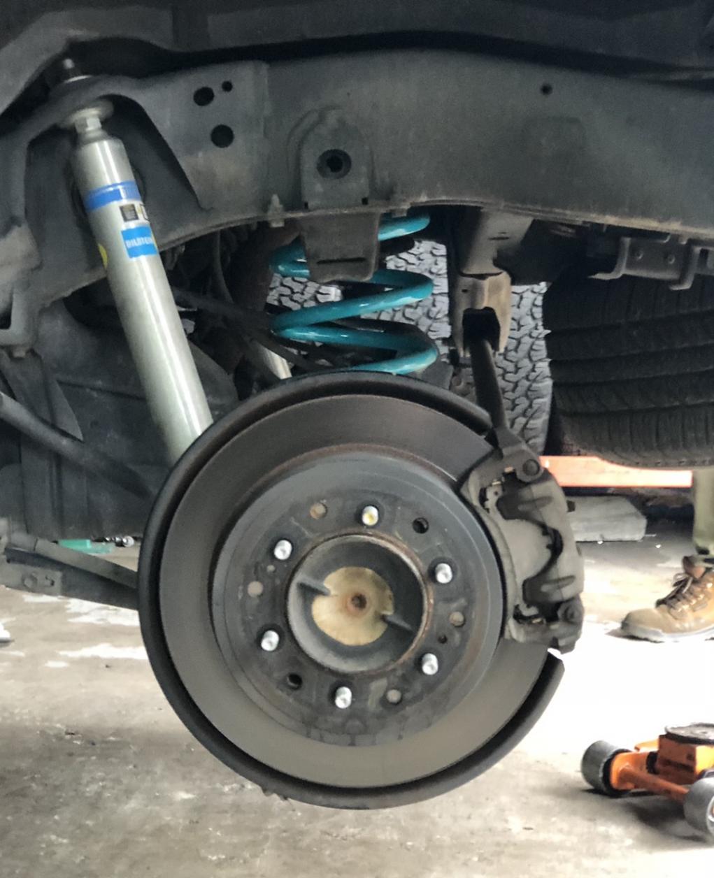

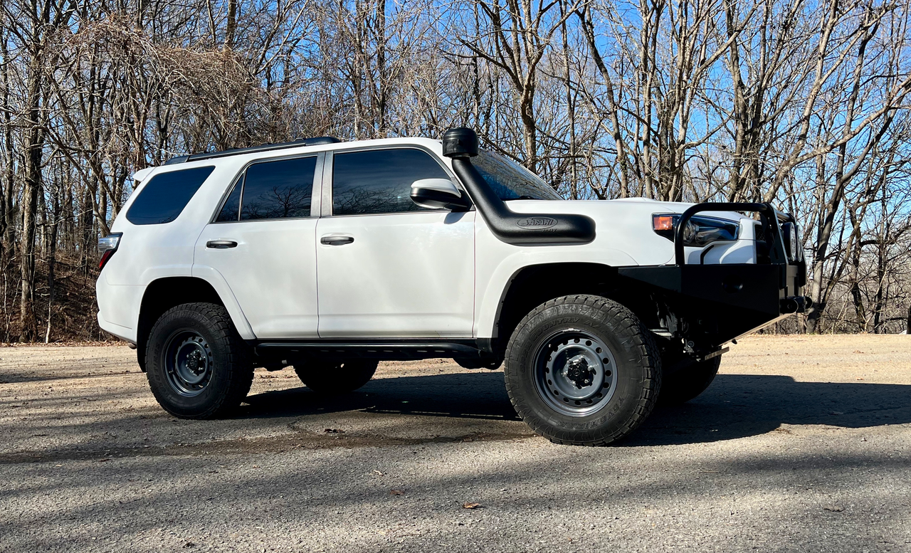

Thanks Mike! My 599’s arrived on Christmas Eve, installed them today.

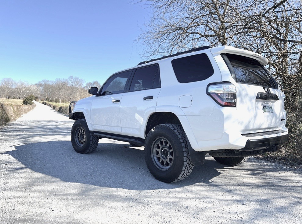

Stock 2018 SR5P “XP”
Next: Springs and shocks replaced. I am 23.6 hub to fender with the 599/701 in the rear combo. Front is roughly 2” (slightly under 22” hub to fender) with the 300 springs with 700 shocks. 275/70R17 BFG KO2s. Slight rub on mudlfap when articulated with 1/4-1/2 turn of the wheel.
Added the 1/4” spacers (1/2” at fender) to passenger and driver side taking lift up to roughy 2.3”. Also added Dobinsons UCAs. 275s did not rub at all with this setup for me.
Same setup with 285/70R17 KO2s. Rubs on mud flap exactly like the 275s did prior to adding strut spacers. Not bad at all but all prob see if I can mod the mud flap to stop it. The front has been fine so far. I’ve been able to get it a little articulated and it has handled it well but I don’t think I have been in a situation where I’ve had it maxed out with the 285s
Hope this can maybe help someone out with their research
Edit 1/8/22:
I ended up removing the front mud flaps. Not totally necessary but it would rub a little and figured my sliders (when I get around to getting them on) will help protect the paint a little.
I am also not an expert on these things but it looks like the fender liner has already been done on the XPs that come with the pro wheels (see below). It doesn’t rub on the road even under heavy braking / sharp turning and off-road was able to get as articulated as I could and didn’t have any issues there either so it has been working out well so far with the 285s and my setup.
Pic was taken before the 285s and strut spacers but did the same washout with the 285s this past week with no issues.
