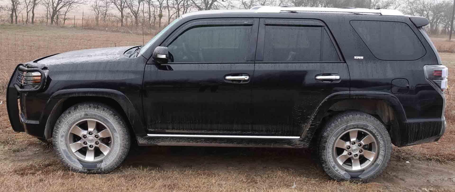

I'm running this exact setup on stock sized Falkens and it has been great. The tires do look a little small due to the wheel gap sometimes but i don't care personally. I will say that the rear is pretty high, higher than expected, but again i'm fine with it. See pic, it's not the best one but it shows where i'm at after a year of running on the setup.
Side note, even if the 4r looked terrible with them the ride of the IMS suspension would make up for it 10x. It's firm but smooth over bumps. I cant describe how much i love driving it.

I like my stock sized tires with my Dobinson’s lift.
- Cheaper,
- lighter,
- in-stock @ most tire shops(already had to replace one after getting shanked by huge piece of metal right before Moab trip)
- My OEM spare (stock location) would work in a pinch, allowing me to carry two spares if i get a 2nd swingaway carrier on my Victory4x4 bumper.
- Hasn’t held me back so far on offroad trips we’ve taken.
- More room in wheelwell for 100% tuck during flexing.
Looks? Don’t really care, nor do i care what others think. :)
