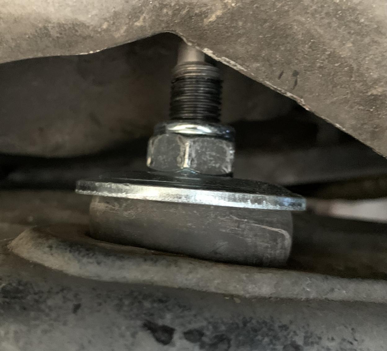

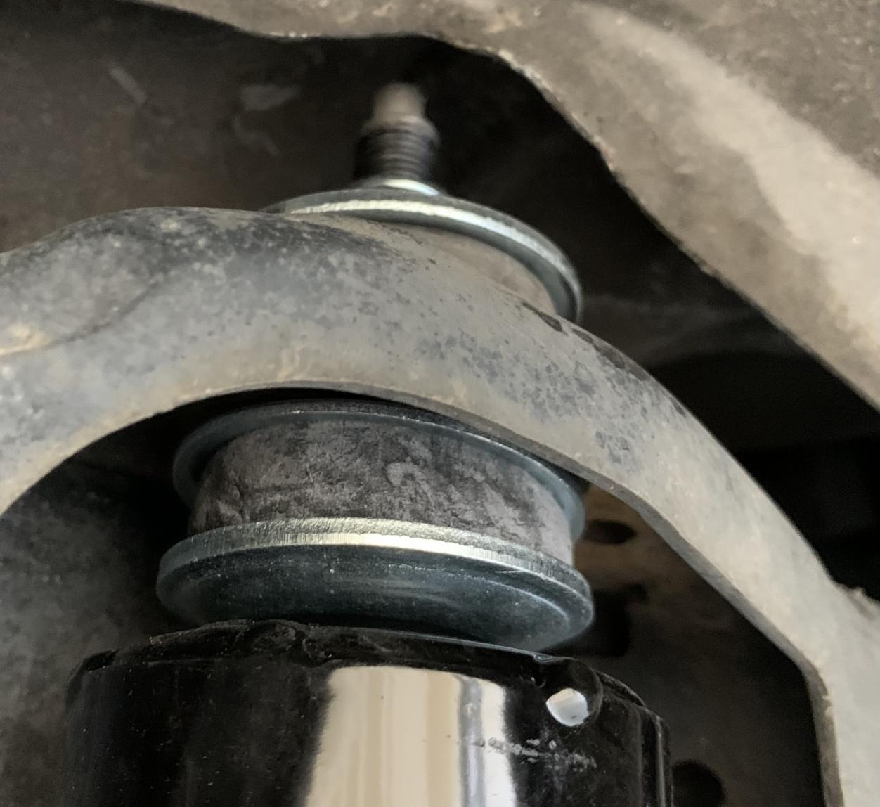

Do these bushings look tightened down okay? This is for the rear shocks.
