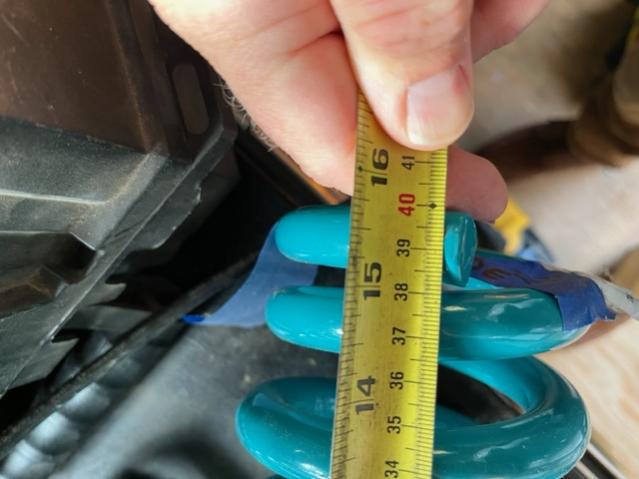

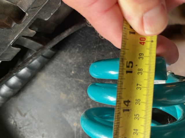

I have a 2023 4runner and I am getting ready to install my ims coilovers and it looks like my springs are different heights. I did search and found a post about a bad batch of springs? both have the same tag and part number.
They're made on the same machine, several hundred at a time. You have to rotate them to exactly the same position to measure each. If one is slightly taller, it's from power coating and the heating. Put that taller one on the driver's side. IMS are height adjustable, so you can compensate there too.
It's been 5+ years since there was any issue with off height coils, and that was 2 pairs I think.
Thanks. One is 39cm and one is 40cm. THey are probably a couple years old. I bought them for a rig I ended up selling before i installed them. Getting ready to buy a set of the ims 50574s from you this month to take advantage of your sale.
