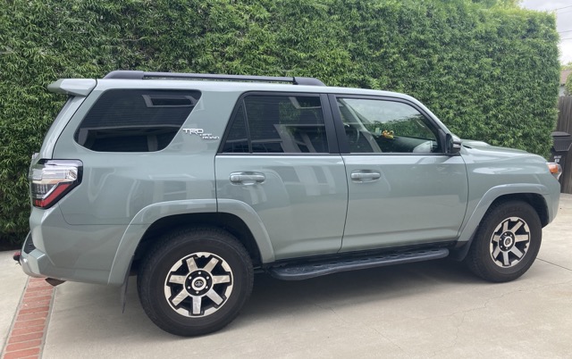

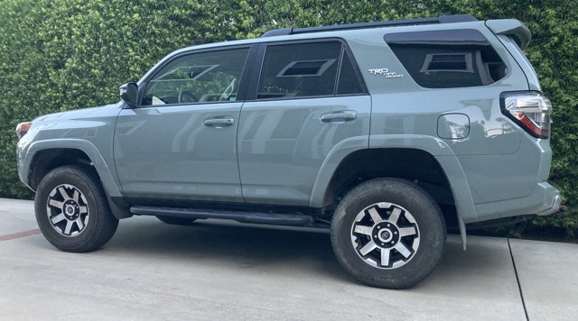

Finally upgraded the stock suspension on my 2018 TRD ORP after 7 years! (6 New England winters).
I wanted a slight lift and a “Pro” ish stance:
- C59-238 Front Lifted Coil Springs
- GS59-700 Front Struts
- C59-323 Stock Height Rear Coil Springs
- GS59-701 Rear Shocks
Mike @ Exit Offroad was great to deal with and answered all my questions. I used his YouTube install video, AZ Overland’s Bilstien video, and the Toyota manual for torque specs.
I replaced the hardware (though not really necessary), rear stabilizer bar bushings, and will replace the engine splash guards (OEM) this weekend after noticing a couple small tears.
The yearly Woolwax sessions definitely helped keep the rust at bay. The front passenger side lower control arm needed some good persuasion (and cursing at) to swing down "freely". I’ll see how my alignment goes but managed to get the cam tabs back to their original position. I’ve read those cam bushing sleeves are notorious for seizing up.
While in the air, I loosened the upper and rear control arm bolts and re-torqued when on the ground to adjust (reset) the bushings.
Measurements (no added weight other than OEM rock sliders @ 70lbs total):
- Stock Baseline: FD 20”, FP 20”, RR 22”, RL 22”
- Pre-install: FD 19 1/2”, FP 19 3/4”, RR 21 3/4”, RL 21 3/4”
- Post-install + 5 mile pothole laden drive: FD 21”, FP 21”, RR 22 1/2”, RL 22 1/2”
Against baseline, I got 1” lift in the front and 1/2” in the rear, which matches Exit Offroad’s description. I’ll take measurements again after alignment and a good long drive.
Really feels good now, much more responsive, less roll in the turns, and not as jarring when hitting those potholes.
Will add back the 120 lbs of a tool box, misc, and recovery gear that’s in there year-round. Then There's the occasional camp trips with a roof box, awning, road shower and a single mountain bike on the hitch. I’ll measure each scenario.
Late summer, early fall they'll get the Woolwax (and Woolwax Drywax) treatment, so for now I'll enjoy the bright clean yellow ☀️ and teal :)
Thanks again [MENTION=148378]Crikeymike[/MENTION]!
Image is after install (wasn’t able able to get a good before shot)

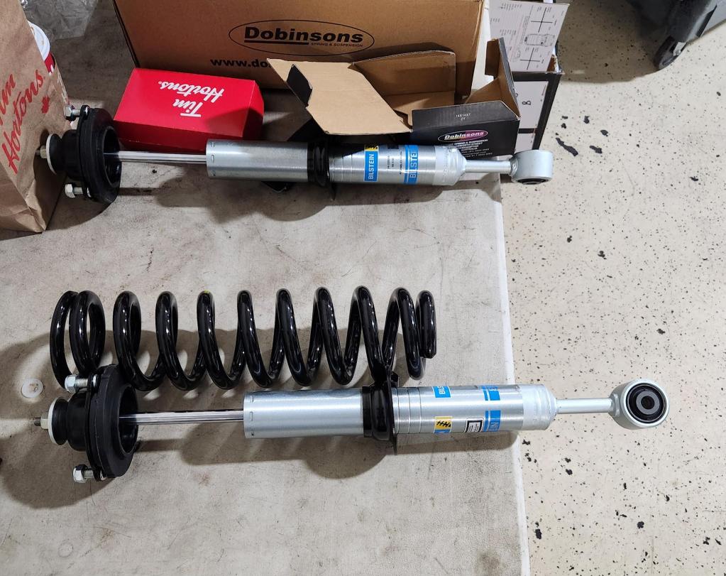

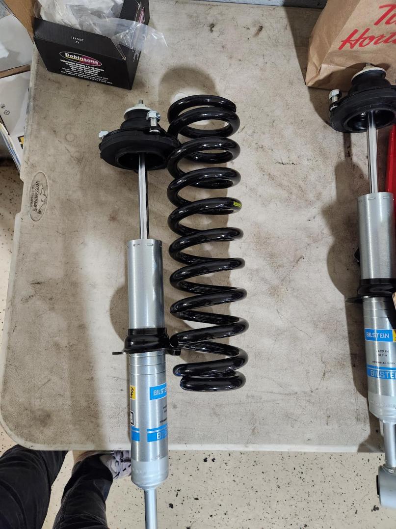

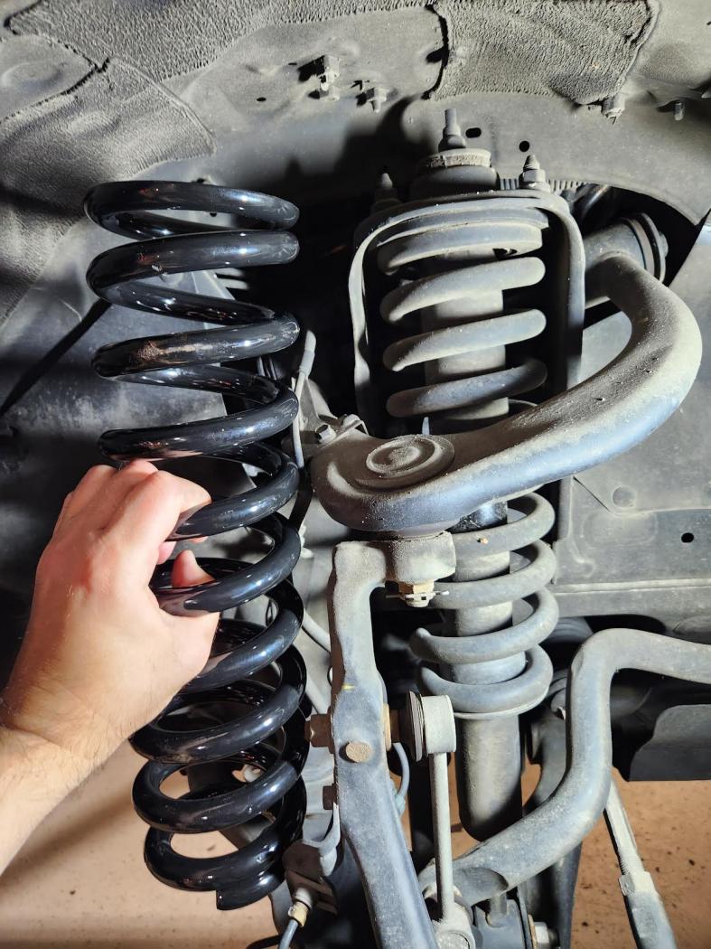

Mike, Im running some problems and I had a horrible day today. I ordered all the parts last week and was super excited to put it together but then I realized my Dobinson (C59-302) didn't like compressing it too much. I do not know if I did it wrong or not but I will try to explain this better with pictures.
what you see here is my Bilstein5100 at the highest groove setting and when I tried to compress it to fit, it is technically impossible because it doesnt compress enough. even if it did, there wouldn't be any room for it to bounce.
1)if I go to the lowest groove setting in Bilstein 5100, would Dobinson spring (C59-302) fit and still give 2.5" lift in the front?
2)or should I go at the highest groove setting (like it is in the picture) on Bilstein 5100 and use the stock springs since it is much shorter than the Dobinsons?
3)or maybe you tell me where did I make the mistake?
I really don't want to send return the parts to them and wait for a refund or change withe something else etc. if I absolutely have to. Do you think there are ways I can make this setup work?
Kindly appreciate your help.:sobbing:
Use the lowest perch. You're not thinking about it properly. You either preload stock coils or use lifted coils with no preload
