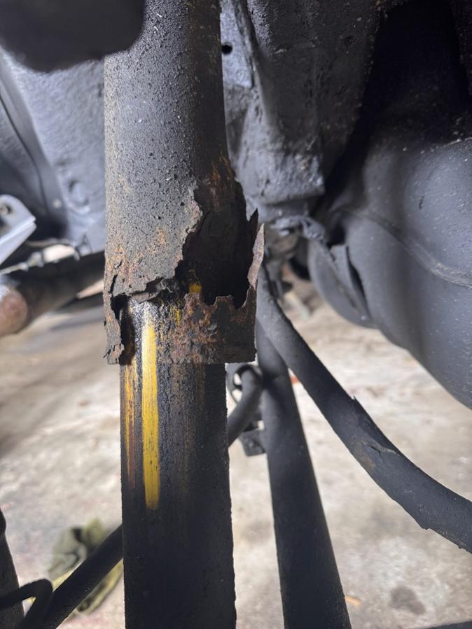

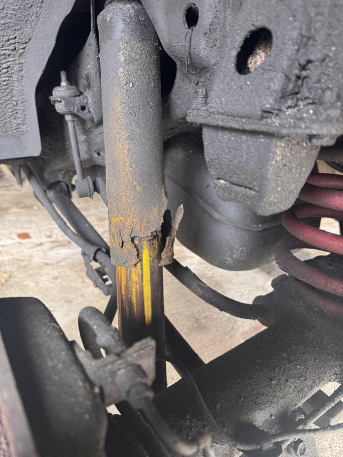

So I bought and installed these in February of 2017. It's been through eight years of salty winter in the northeast and this is how they look today.
All things considered, I think they have done pretty well. The Bilstein's and others I have had didn't last nearly as long in the rust department.
To be clear, these shocks still work, they are just rusting out.
Figured I'd update.

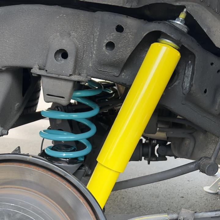

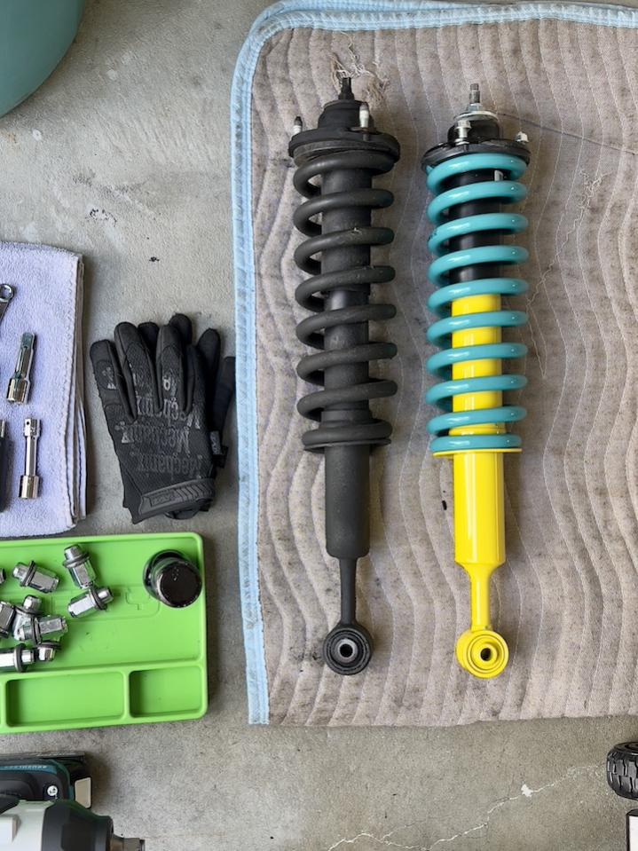

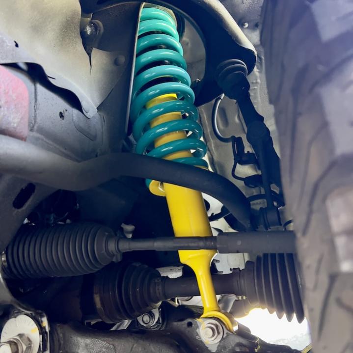

Finally upgraded the stock suspension on my 2018 TRD ORP after 7 years! (6 New England winters).
I wanted a slight lift and a “Pro” ish stance:
- C59-238 Front Lifted Coil Springs
- GS59-700 Front Struts
- C59-323 Stock Height Rear Coil Springs
- GS59-701 Rear Shocks
Mike @ Exit Offroad was great to deal with and answered all my questions. I used his YouTube install video, AZ Overland’s Bilstien video, and the Toyota manual for torque specs.
I replaced the hardware (though not really necessary), rear stabilizer bar bushings, and will replace the engine splash guards (OEM) this weekend after noticing a couple small tears.
The yearly Woolwax sessions definitely helped keep the rust at bay. The front passenger side lower control arm needed some good persuasion (and cursing at) to swing down "freely". I’ll see how my alignment goes but managed to get the cam tabs back to their original position. I’ve read those cam bushing sleeves are notorious for seizing up.
While in the air, I loosened the upper and rear control arm bolts and re-torqued when on the ground to adjust (reset) the bushings.
Measurements (no added weight other than OEM rock sliders @ 70lbs total):
- Stock Baseline: FD 20”, FP 20”, RR 22”, RL 22”
- Pre-install: FD 19 1/2”, FP 19 3/4”, RR 21 3/4”, RL 21 3/4”
- Post-install + 5 mile pothole laden drive: FD 21”, FP 21”, RR 22 1/2”, RL 22 1/2”
Against baseline, I got 1” lift in the front and 1/2” in the rear, which matches Exit Offroad’s description. I’ll take measurements again after alignment and a good long drive.
Really feels good now, much more responsive, less roll in the turns, and not as jarring when hitting those potholes.
Will add back the 120 lbs of a tool box, misc, and recovery gear that’s in there year-round. Then There's the occasional camp trips with a roof box, awning, road shower and a single mountain bike on the hitch. I’ll measure each scenario.
Late summer, early fall they'll get the Woolwax (and Woolwax Drywax) treatment, so for now I'll enjoy the bright clean yellow ☀️ and teal :)
Thanks again [MENTION=148378]Crikeymike[/MENTION]!
Image is after install (wasn’t able able to get a good before shot)
