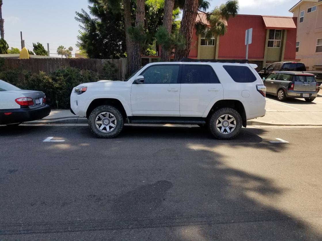

So I don't have a shot of it fully loaded, my brother needed my tent and my fridge broke so the last trip I took was with a cooler and a cot+awning combo. This is a good 250lbs lighter than my normal trip load but it hardly sagged.
My "unloaded" weight is the armor, two full fuel cans, and a minimally stocked fridge; with this the springs maintain a good forward rake which I prefer. Without the fuel cans and fridge the rear sits very high.
For reference, the GX in the background is on the same size tires (285/70/17) with OME mediums. He's got a small drawer system in back but otherwise minimal gear inside. Other shot is unloaded.

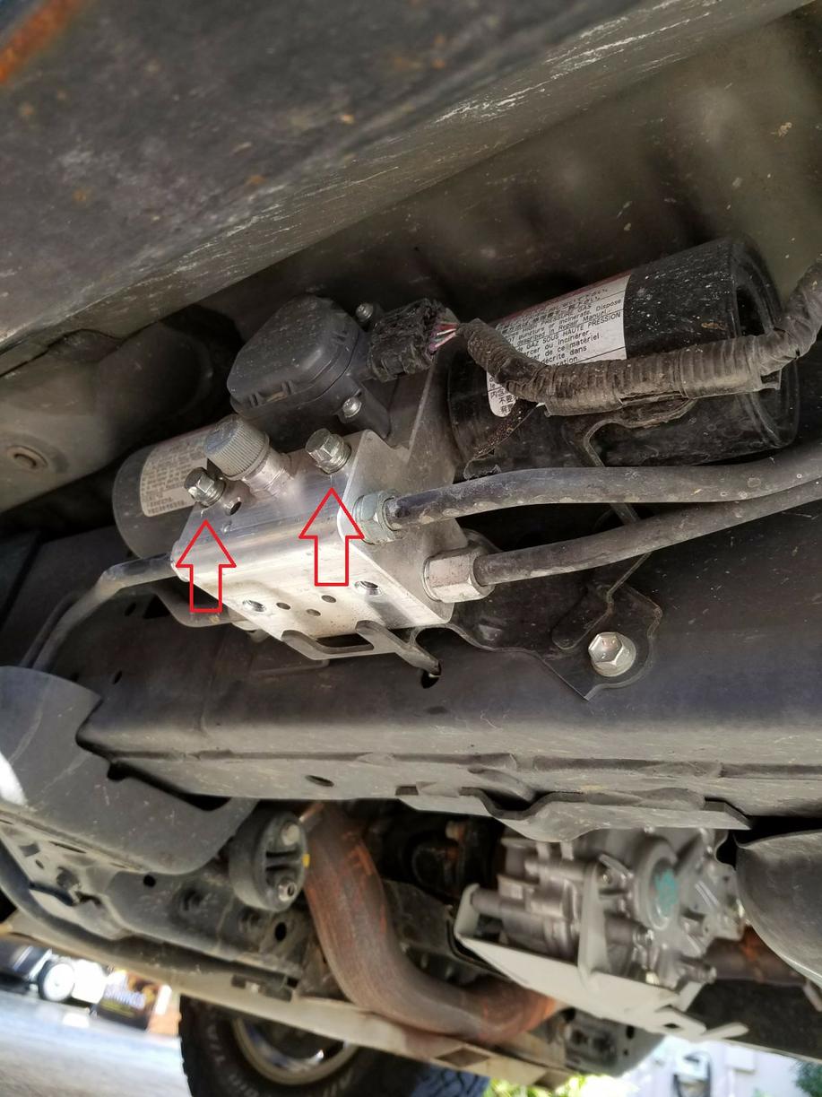

Need help fixing a lean after lifting a vehicle with KDSS, this video can help you understand how to push the hydraulic cylinder back up, and take out the lean that the hydraulics is pushing into the vehicle after lifting.
https://www.youtube.com/watch?v=xtURdW66WM4
Yeah, I know it's a 200 series land cruiser, but the process is the same. The valves are just 10mm heads instead of 5mm allens, but are still under the US driver's side seat against the frame rail, covered with a protective cover. Photo attached of the 4runner valve system, with cover removed, and the 2 bolts pointed at.
Just be sure to mark the bolts before you start, and don't rotate any more than 3 full turns each, or you could have to head to the dealer for an expensive service to the KDSS system.

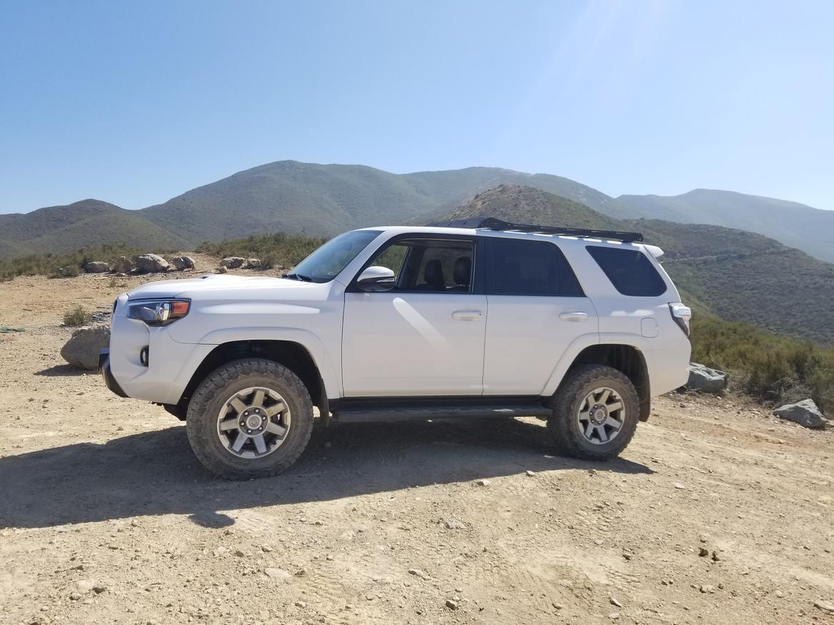

Installed c59-300 In the front and c59-723 along with dobinson struts and shocks over the weekend, rides exceptionay better then stock on and off road. No noticeable lean with the taller passenger rear springs.

Very nice!! Came out super level, right!?!
Glad you like it, but also jealous that you threw those parts in then went up and drove over mountains to test it out.

It actually has a slight rake, just not as much as stock. It's just the way I wanted and exactly as you reccomened. 2nd pic is at a angle. Thanks for all your help Mike.
