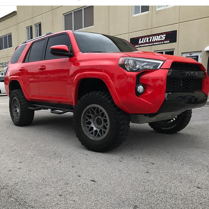

We have the C59-448 and C59-675V on this 4runner, but they're on our MRR shocks and the front is adjusted up just a little higher than the 3" mark.
