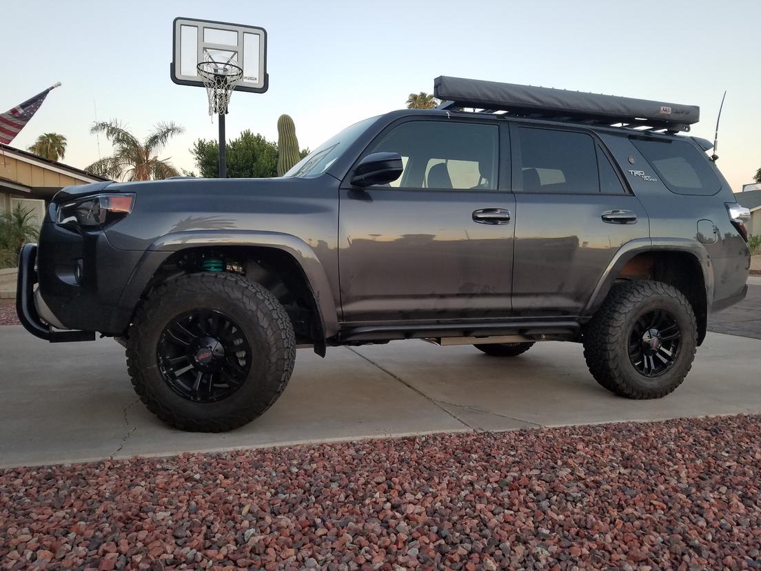

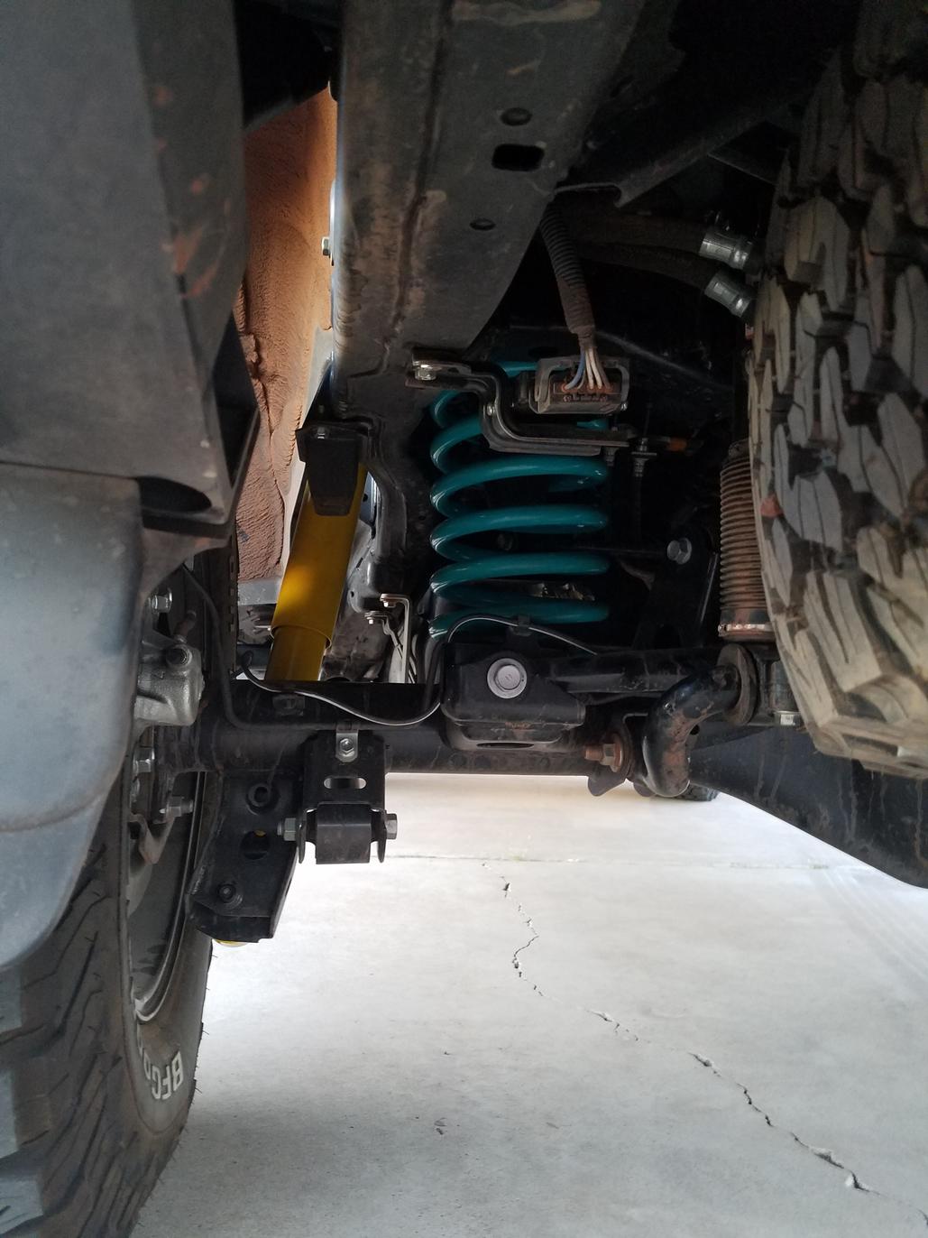

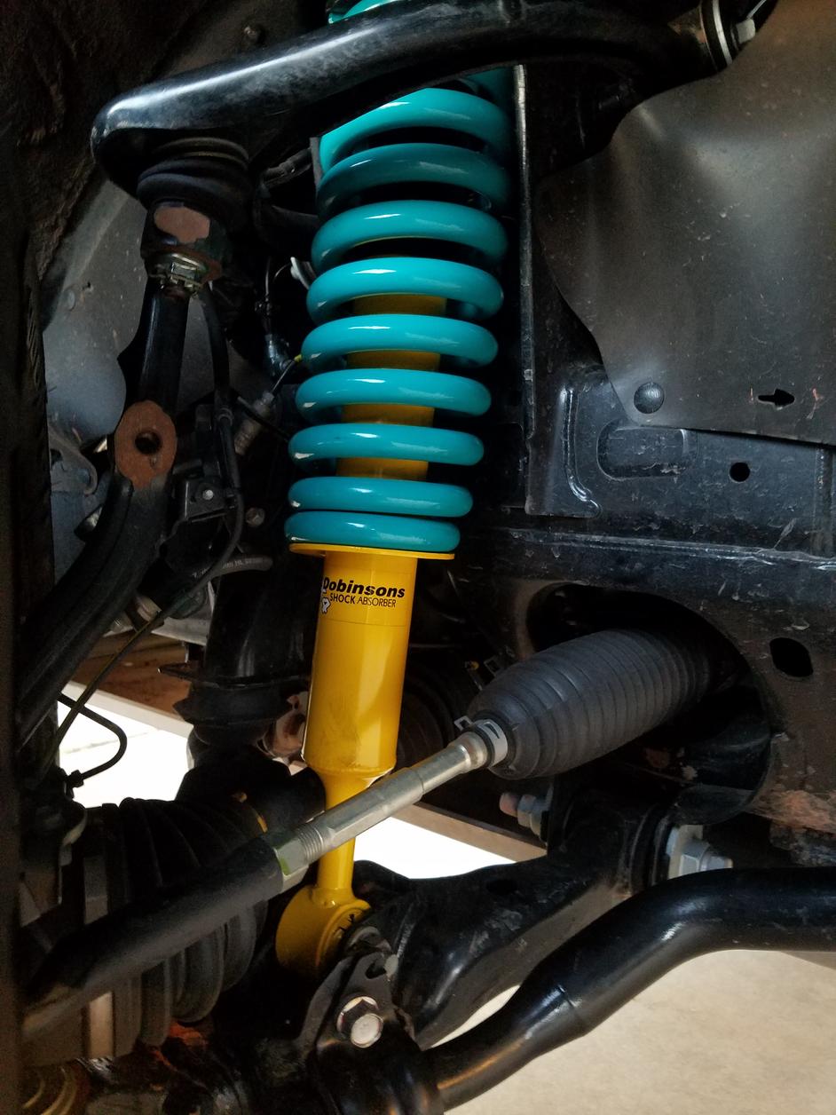

2016 Trail Edition with KDSS- I just thought I'd post before and after pics of my Dobinsons set-up;
C59-314 x 1
GS59-574 x 2
DD59-527K x 1
C59-725 with KDSS x 1
GS59-701 x 2
Final Measurements-
front- 24"
rear 25"
Before-
[/url][/IMG]
During-
[/url][/IMG]
After-
[/url][/IMG]
[/url][/IMG]
My new 2" lift with Dobinsons suspension. Great customer service! Mike will help you with any configuration you want. Easy transaction and very quick shipment for the lift kit.
Looks so sweet! Mine is being put together now--I can't wait!! What did you go with? Did you replace the UCIs?
You are spot on about Mike. He took time to answer all my questions and help customize my order.
Just finished installing the lift. Now off to get an alignment.

I didn't replace the UCAs. The alignment didn't change and no adjustments were needed.
Looks great! :thumb:
Now I know what it would look like on my truck right down to the Sliders, aluminum skid and everything, minus the 3rd row. Did you go with the 700 struts, 701 rear shocks, 300 front springs and 325 rears or do you have kdss?
Mine is a TRD Off-road with KDSS

I saw the kdss in your first pic after I posted. Thanks for the part #'s. Are you running 275's?
