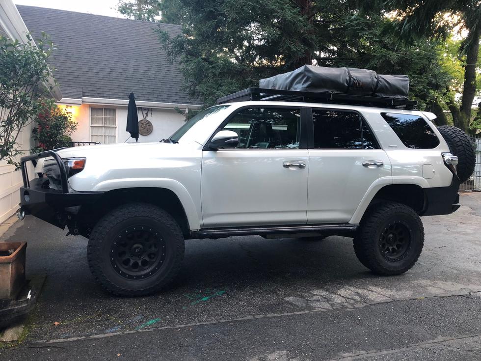

C59-701V Ride Height Update
Here's some current numbers Mike, hub to bottom of fender averages out to about 24 5/8ths right now. C59-701V rear coils with rear bumper, 10 gallons of gas on the carrier, and rtt. Got a couple things in back but otherwise relatively unloaded. Tall but smooth!

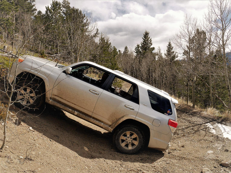

Finally got out to properly test out my Dobinsons setup off-road (I don't wheel in the snow - too many heart-stopping moments over the years). I've been very happy on road - I can see where some might think it too firm for a mall crawler but I've had lots of stiffly sprung sports cars so I like it. Way less body roll and dive, firm but smooth. But off-road they were AWESOME. Over big rocks there's way less swaying around and when there are not rocks and just washboard and pot holes the Dobinsons suspension just smooths everything right out. We were just floating along chasing side-by-sides down the trail. We're SUPER happy with how it performed.
Weight in the truck were me and my son (we both go about a buck seventy-five), a winch on a hidden mount up front, recovery gear and 160lbs worth of dogs in the rear.
Front: C59-300, GS59-700
Rear: C59-599, GS59-701
Here's a picture so people can gauge the "stance". ;-)
Hahaha, that looks like every trail I've been on in Colorado!!
Thanks for the review. The faster you go, the better it is!!!
