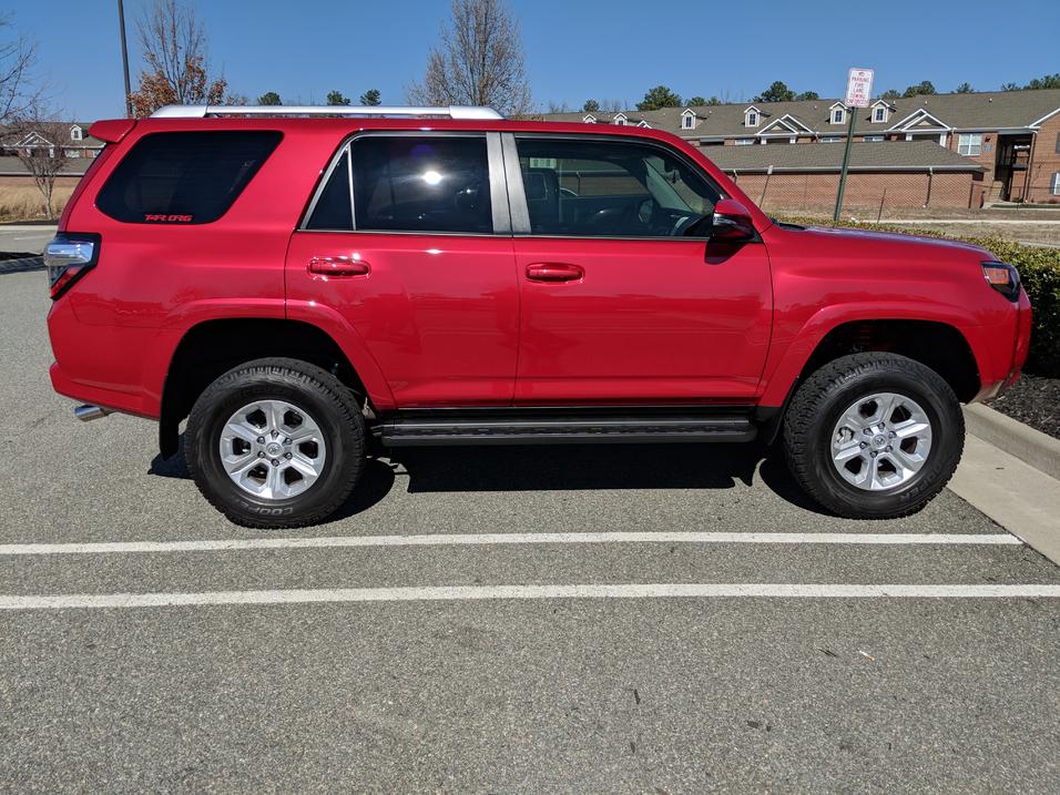

C59-302 in front, C59-505 rear:
Mike helped me decide what setup to run after my Wheelers Off Road coils weren't up to the task of additional weight.
I decided to keep my 5100's for now.
Front: C59-302 with .5" top spacer
Rear: C59-325
Tires are Nitto RG 285/70r17
Wheels are SCS F5 17x9-38
The winch will be installed next weekend.
Ass up
Love all the options and setups. Maybe it’s just me but all of the setup pics I’ve seen look ass high. I’m all for a little rake but it seems excessive. What would be the best setup for level at 2.5”and level at 3” I’m still debating on UCAs and 3” or 2.5” and running it.
My choice (above) in springs was 2.5 front, 1.5 rear. The UCA's were most likely not a 'required' thing as a result of my choice but the front-end handling on the highway is much better.

Looks good but for my liking looks ass high. Knowing that I would do 3 up front

It all depends what your intended usage is.. I've had both level and "ass high" springs bottom out on me on the trail, but I carry the kitchen sink with me when I camp sometimes.
As far as advice, if the rake is that much of a concern I'd get whatever desired height rear you want and pair it with adjustable front coilovers, not clip adjustable but full on, threaded-body coilovers. That way you can pick up the associated spanner wrench and tweak front end ride height to your liking. Most of the 2.5 body coilovers available have full adjustability between 2-3" inches. Dobinsons MRR are adjustable, as are many others. Hope that helps, I think it's a good option if it's within budget.

The trucks come from the factory with the rear being about 2" taller than the front, so that it can carry weight. So you need to lift the front 2" more than the rear to make it totally level, but it's really not advised. If you load up the rear after that, you'll have reverse rake which leads to a poor driving experience.
And without knowing all the weight you add, I can't suggest parts. Check post #1 again. 3" front lift, you need UCA's.
