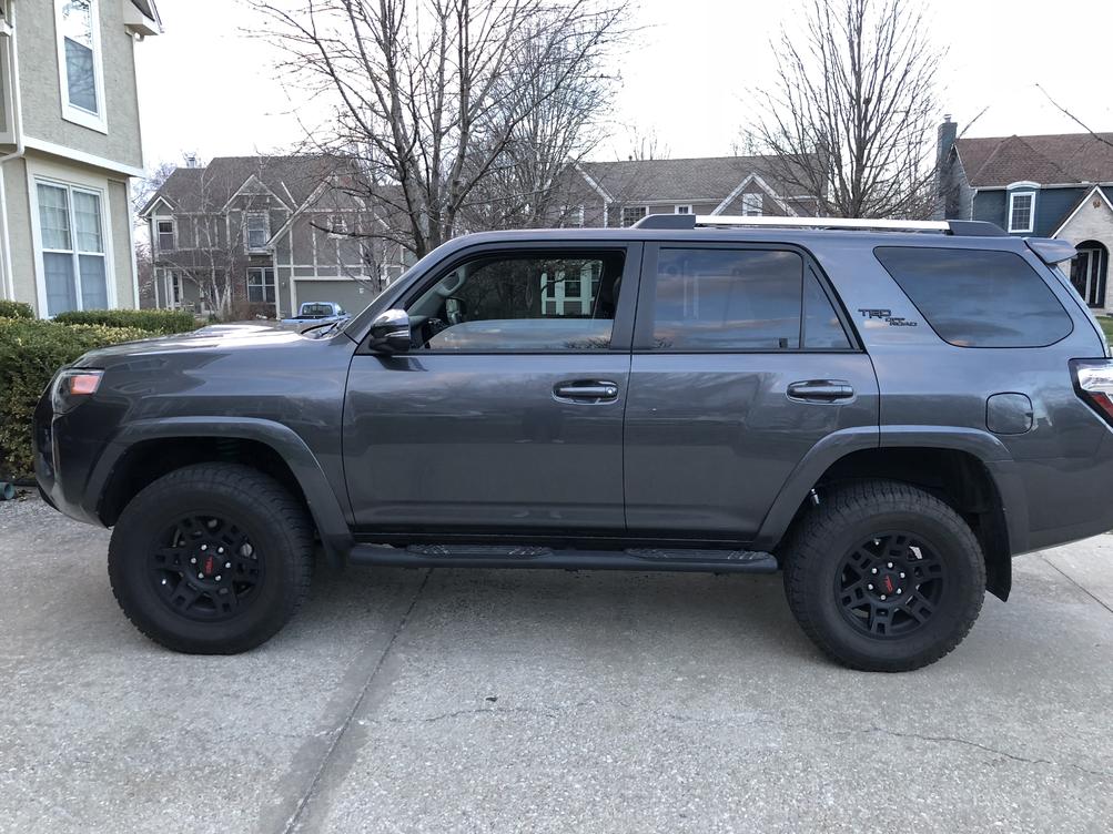

Installed my 5100’s and 300/599 combo. Love it!

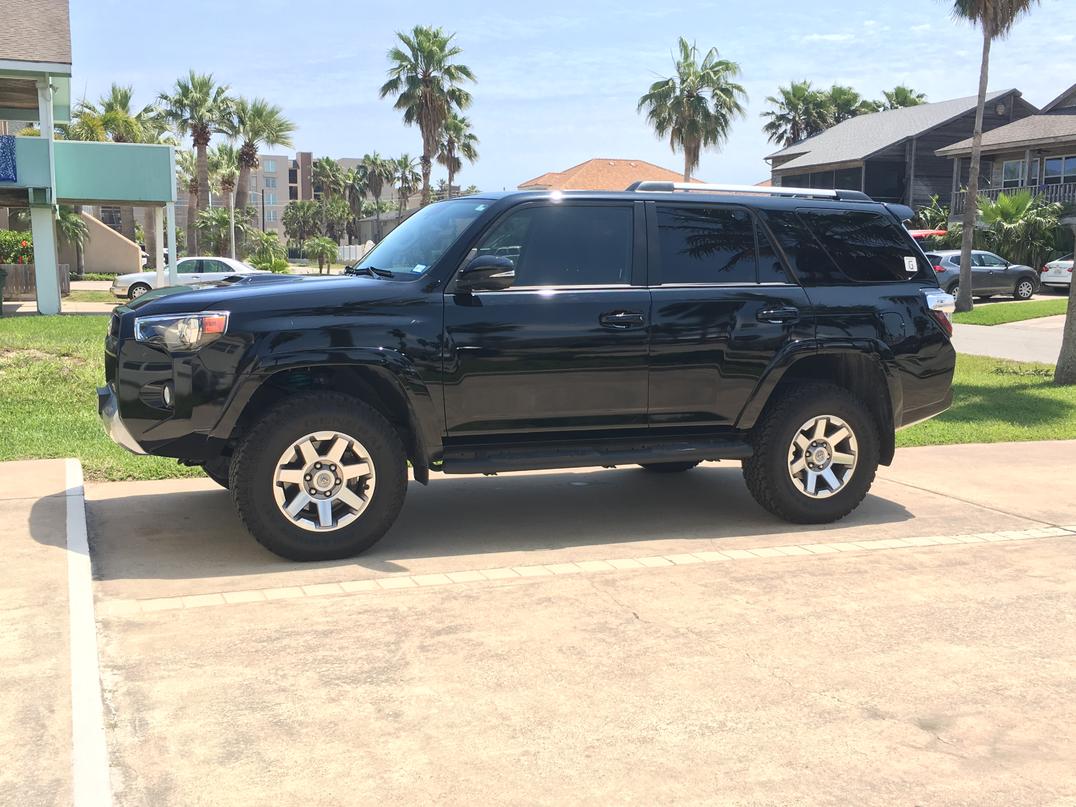

Put about 800 miles on the suspension after installing it last week. Parts list below:
C59-300
C59-599
GS59-700
GS59-705
Stock UCAs
265/70/17 General Grabber AT2s
The ride is much better than stock, definitely less body roll and less nose dive (as expected). I am very pleased with everything. There is about a 1" rake on it, but it's hard to tell because of the slope of the driveway in the picture. I will try to get a better pic sometime soon. Now I just need to decide on keeping the stock wheels or not :D
That looks great and it's affordable - I think I'm going to have to pull the trigger on this combo. Thanks for the inspiration!
Also: What setting do you have your front 5100 at?
C59-300
C59-599
GS59-700
GS59-705
Stock UCAs
This looks like a perfect, simple lift. Could you take some more photos on flat ground from different angles, and directly from the side?
Also, how did your alignment numbers come out with stock UCAs? How does it steer at highway speed?

So I've put a few hundred miles on it and it rides great on the highway, but around town on those bumpy roads it feels a bit less stable than the factory setup. I suspect this is more due to the bilsteins being so stiff. Hopefully they continue to break in and the rear settles more, it still is sitting quite a bit higher than the 1" lift.
Will do! I'll have to take some after work but I will try to get them uploaded tonight. I'll also take a pic of the alignment sheet. Highway driving was very smooth this past weekend as I put about 700 miles on it at 65-80 MPH. Didn't feel squirrely at all.
