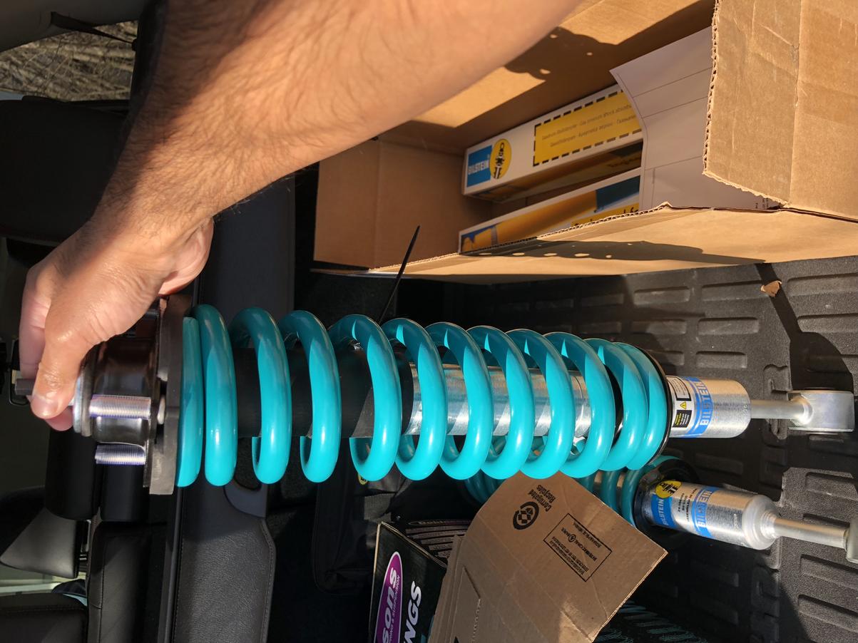

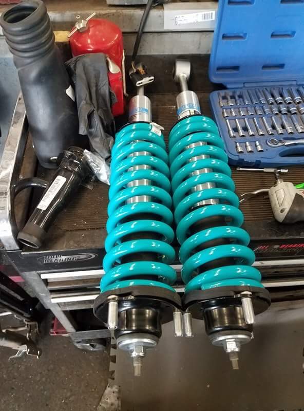

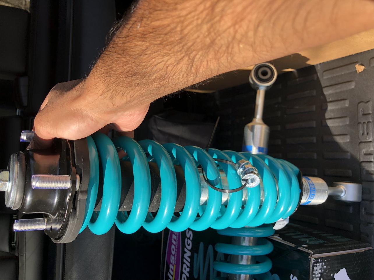

Question about how my springs are oriented on the 5100’s. I had a buddy assemble these for me and am curious if the top stud being slightly off center with the strut bushing/base is going to cause issues or if that isn’t an issue.
Not an issue. Mount them up and, if necessary, you can rotate the strut body to align with LCA. Insert a long socket extension through the eye and tap with a rubber mallet.
Yeah, you'll be fine, the other fella here already gave a perfect response. Mount them up and rotate the bottom mount a fraction if necessary to help it drop into the mount in the lower control arm easier. You don't want that lower mount twisted and under tension while trying to put the bolt thru, if you can help it.
But you're probably already done with the install!! I love that color combo, I wish our shocks were silver!! hahahaha
Haven't done the install yet due to weather but tomorrow is the day I am planning on. What do you mean when you say I don't want the lower mount twisted and under tension while trying to put the bolt through?
Based on what I am reading, I'll mount the top, and then insert an extension into the lower mount and turn it until it lines up and falls into the LCA, is that the correct way of doing it, or would that cause it to be twisted and under tension? I'm going to do the install by lowering the LCA by loosening the cam bolts.
I think you've got it - correct me if I'm wrong, Mike. He just means to rotate it before trying to mount into the LCA to make it easier on yourself instead of trying to just jam it in crooked. Once you get it all mounted up everything is going to settle in and sorta "self-align" anyhow after you hit a few bumps. You don't need to be worried about twisted bushings in this location.

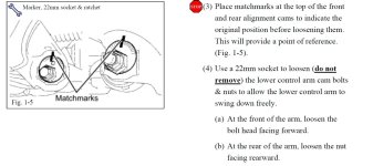

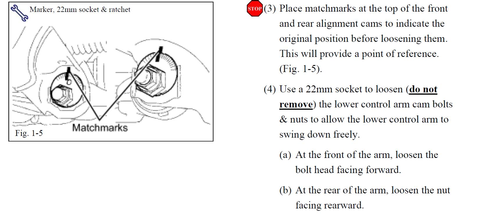

Also, I found the pro install instructions, but am a little confused on the bolts/nuts loosened on the alignment cams. Do I loosen only the single front bolt head and the single very rear nut? Or do I loosen both bolt and nut on the front of the arm and both bolt and nut on the rear of the arm?
Well, the bolts and nuts are connected so when you're loosening one, you're loosening both. In general you want to hold the bolt head and twist the nut, but that's not always possible and OK if not. IIRC it's hard to get to some of the nuts in this case and you'll likely find those instructions to be accurate.
