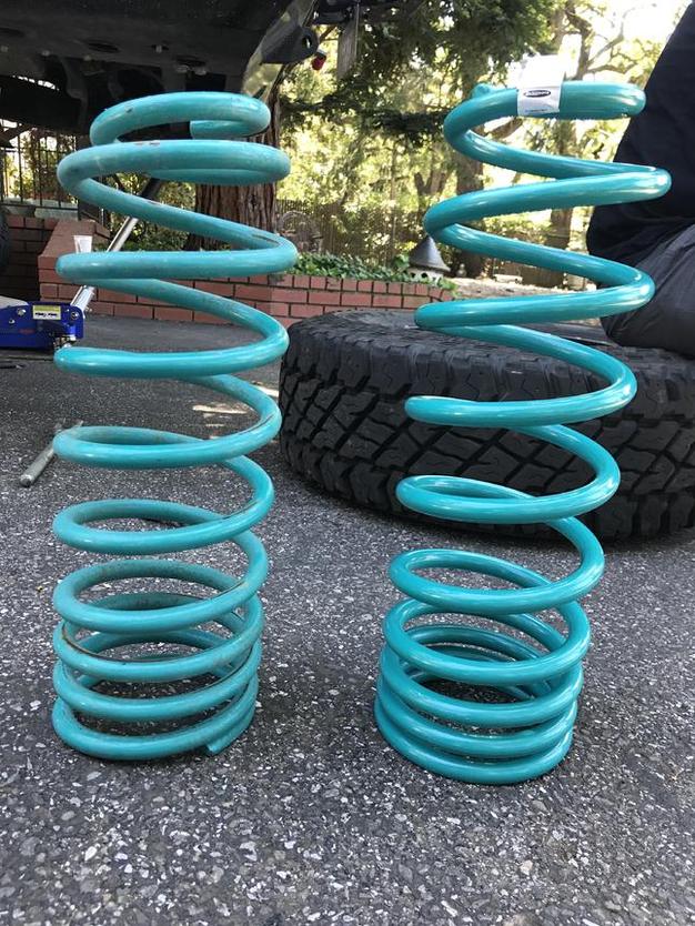

Anyone run the Dobinsons Rear Coil Springs (C59-701V), heavy rear sping, anyone have a picture of the actually spring and pic of their rig have it on?
Here you go. It all depends how much weight you have in the truck though, and what accessories and tire size you have for how it will look. If you have a 5th Gen and don't have at least 600LBS constantly in the back, they're not the coils for you.

Awesome, thanks. Working on bumpers right now. planing on doing a dual swing with tire carry and things. So what if I don't have the weight, will it be a rougher ride? And these spring are designed for your guys' rear upper and lower links right?
It’s not a rough or harsh ride unloaded due to their progressive nature, it’ll just sit tall. Like 4+ inches of lift tall. A few hundred pounds does a lot to level it out.
You’ll want to keep an eye on your weights cause if you lift the rear enough you’ll need to start looking into a double cardan driveshaft and adjustable links.
The baseline is that if you don't have 600LBS of weight, don't put those coils in.
Yes, our rear uppers and lowers will work great with these springs, as well as anyone else's, since they have tons of adjustment in them. You can really tune the rear pinion angle really well with them, and I strongly suggest running the rubber bushings that we supply with them so that you don't get that dreaded "poly squeak".

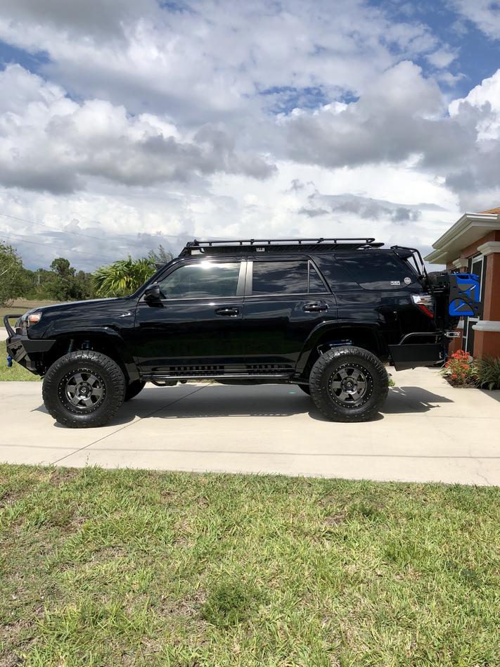

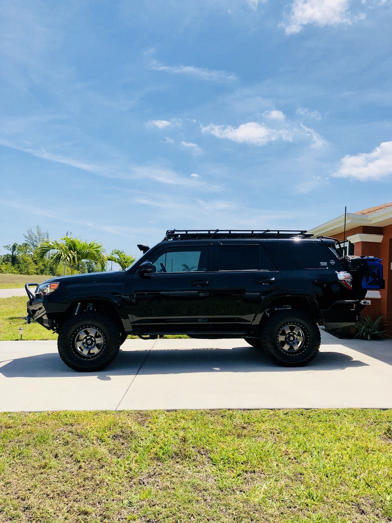

Yesterday I switched from C59-327 rear coils to the 329s after just 450 miles. I under estimated the weight due to my 3rd row seat, rear bumper with tailgate, gas cans, yada, yada, yada. I like a small rake but it went away with the 327s. I thought the ride would be harsh with the change but it rides perfect now. Before and after pics. Sorry for the crappy pictures. I’m no photographer.

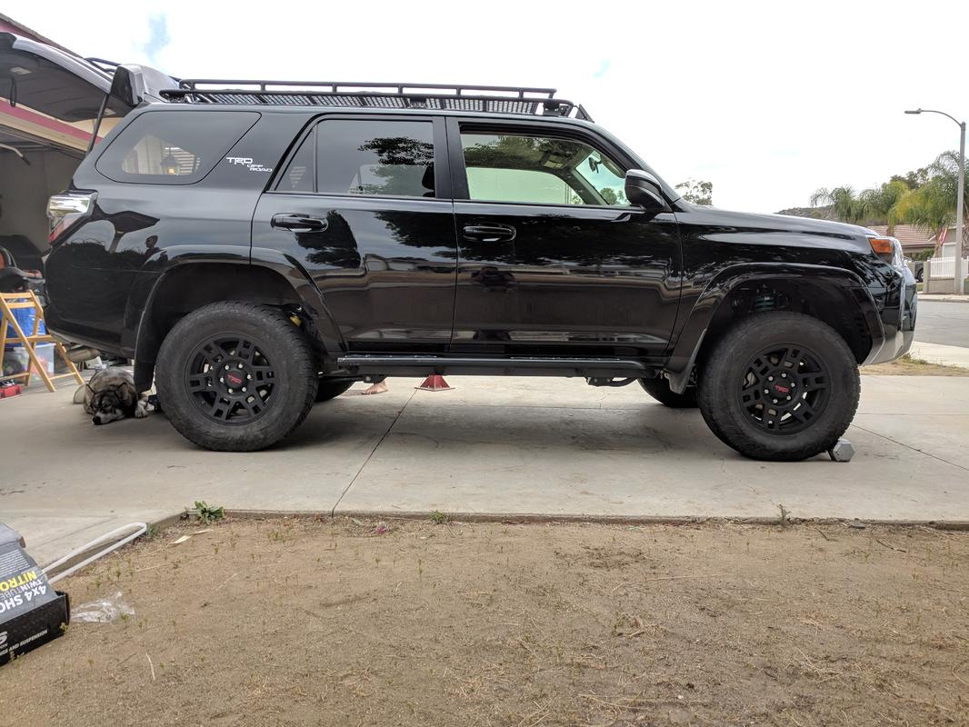

Finally got some free time to install. Big thanks to [MENTION=96425]JSparky[/MENTION] and @dobinsons_mike for answering all of my questions and helping out.
For the fronts we used
C59-726 - 100-220LBS heavy load front weight, 2" lift. 385/380mm, 18mm wire, 730LB
For the back we used.
C59-723 - Stock rear end, 1.25" to 1.5" lift, offset height coils for KDSS leveling. 420/405mm, 17mm wire, 228LB
I have some drawers I built with camping gear in there along with the roof rack and sliders so far. I still need to install the c4 lopro bumper and winch.
