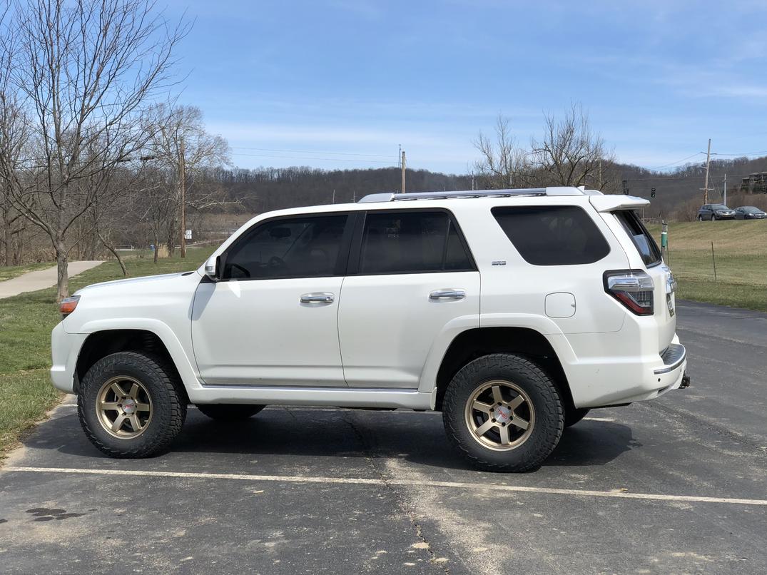

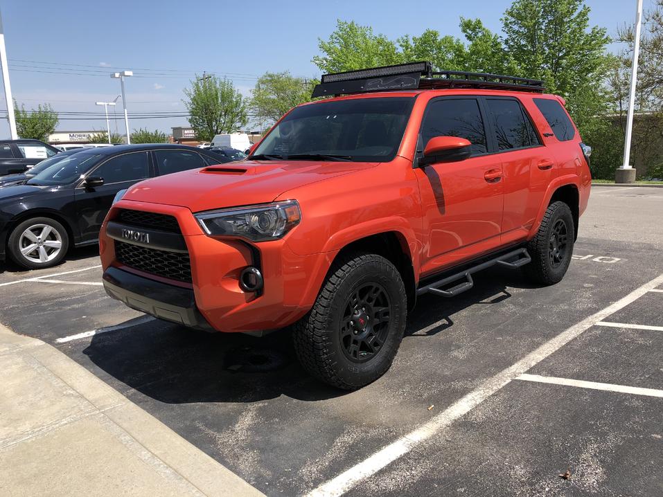

I just traded my ‘13 SR5 listed in my signature and picked up a 2015 Pro. I forgot what the stock suspension felt like and I’d like to keep that feel until I figure out what bumper option I’m going to go with for my winch, line up some skids & sliders. Eventually I’ll get a lift that provides similar lift as my SR5 has, but I may step up from 5100’s and springs.
What springs could I go with to somewhat level out the front, using the stock Pro struts? Are the 1” springs no more? What’s the ideal amount to raise the front, keep stock feel, and not over-extend the stock Pro struts?

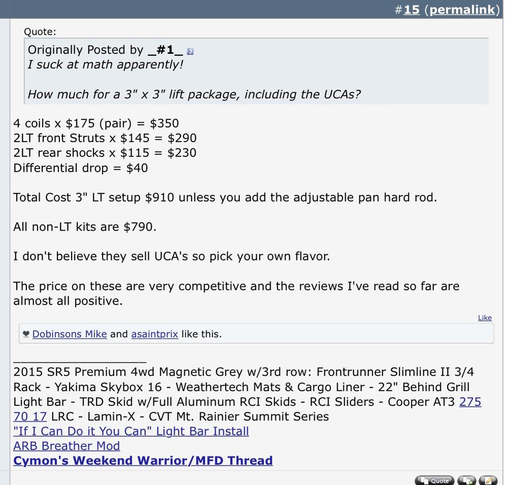

Read post 15

Read it. it just gives pricing.

Post 15 mentions nothing about pricing.....so did you really "read it"?
