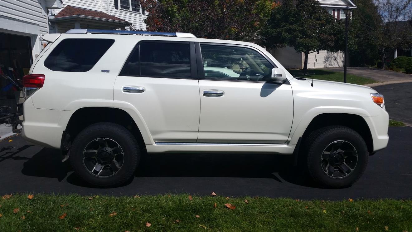

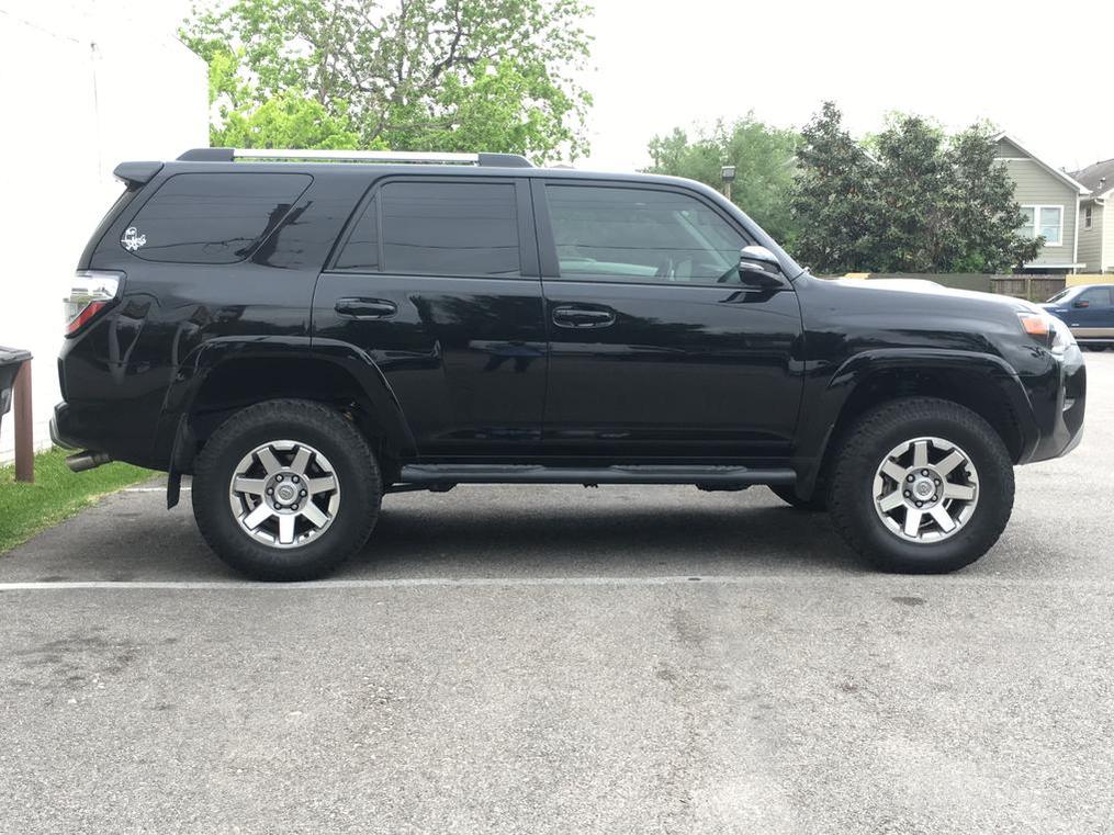

Hey man. I'd suggest the 2" front and 1" rear lift.
C59-300 front coils
GS59-700 front struts
C59-599 rear coils
GS59-705 shocks
That's the same parts these guys in these photos recently installed. Nothing too tall at all, adds some ground clearance, supports extra weight, and maintains 1" or so of rake for loading up.
It's a good lift height with stock sized tires, as it doesn't look out of the ordinary. And no other parts are required. That's $865 delivered in the 48 states.
