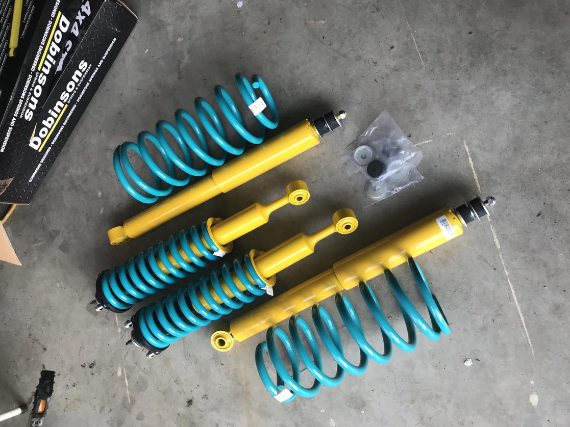

Well the lift finally arrived yesterday!!! looking forward to getting it installed and then getting tires...

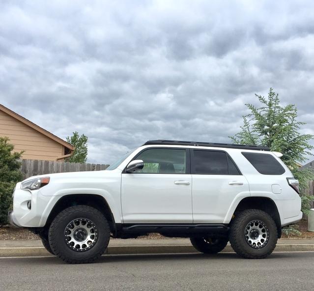

Yesterday I switched from C59-327 rear coils to the 329s after just 450 miles. I under estimated the weight due to my 3rd row seat, rear bumper with tailgate, gas cans, yada, yada, yada. I like a small rake but it went away with the 327s. I thought the ride would be harsh with the change but it rides perfect now. Before and after pics. Sorry for the crappy pictures. I’m no photographer.
