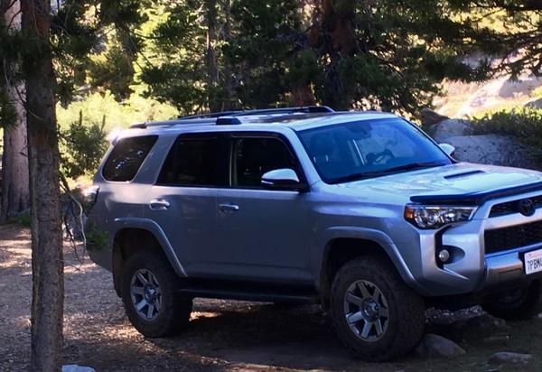

Here is a side pic
This is exactly how I want mine to sit. Looks go man, definitely taking notes on your setup.

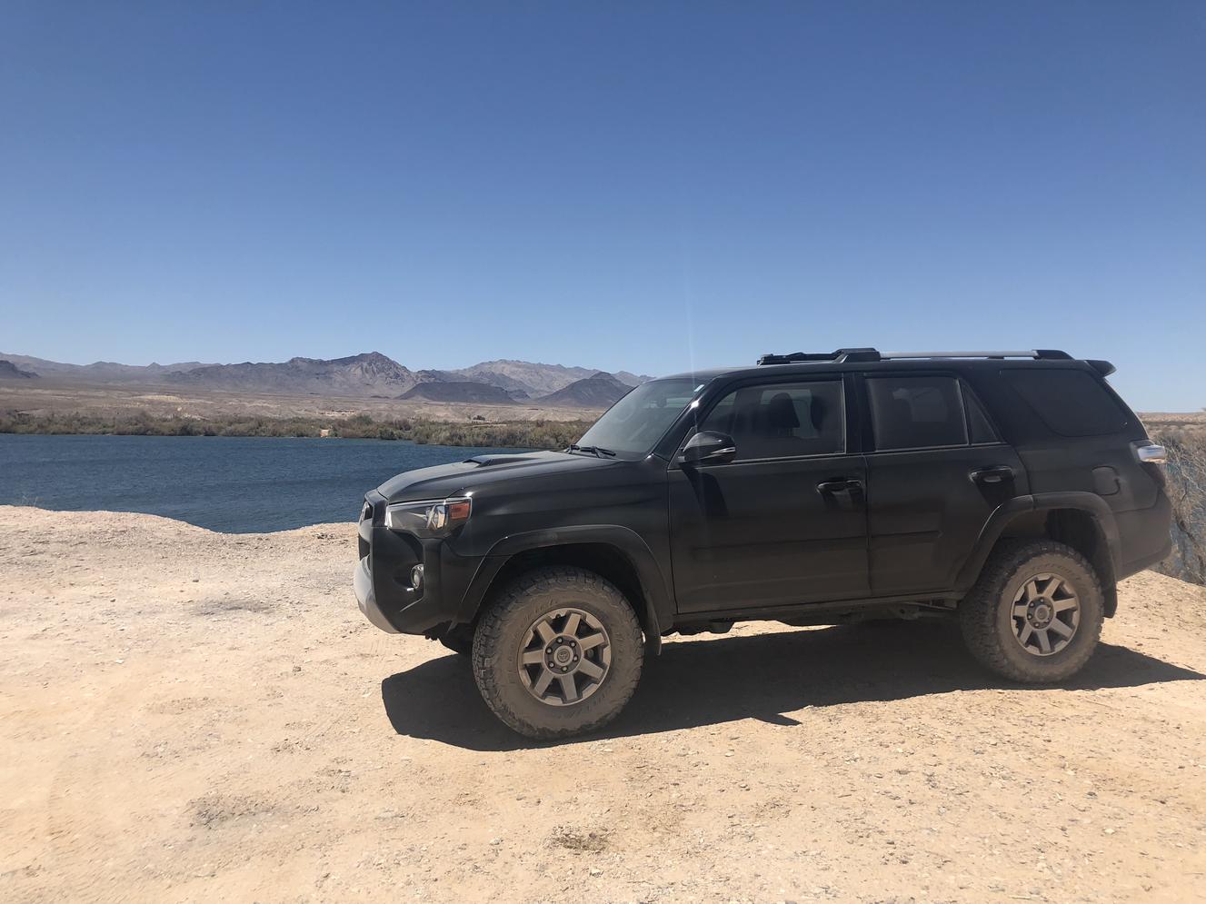

Thank you Mike for getting such a quick turn around, I did make my trip, here is a pic :)
Looks great! This is the exact set up that I plan on doing. did you upgrade your UCA with this setup?
I did not do UCA. Went with 2.5 inch instead of 3 inch to avoid having to do the UCA. Alignment came out ok, camber is a bit off but from what i was told camber doesn't affect tire wear so I'm ok with it.
