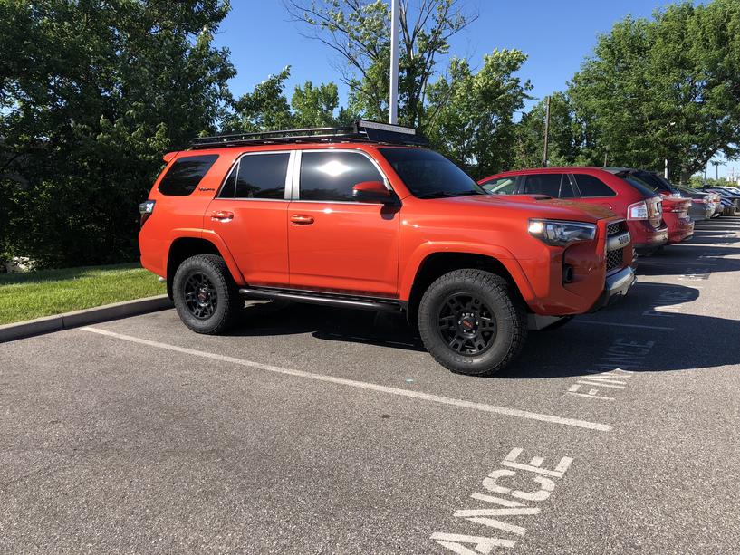

A big thank you to Mike for help with ordering springs for our TRD Pro T4R. We got the springs installed this weekend and couldn't be happier. Our goal behind this install was to improve the handling and ride when fully loaded down with a RTT, Hitch rack full of wood or coolers and all the rest of our gear when we go Overlanding. The ride is much improved. Way less nose dive, definitely stiffer but not harsh and certainly tell its lifted higher than stock.
We went with C59-748 Front & C59-327R Rear
Here are some pictures from the install. First photo is before on factory springs:
Comparrison of New vs. Old Springs.
These bolts seem to always tend to seize up but thanks to our installer ( [MENTION=174077]Texoma[/MENTION] on tacomaworld.com) they won't be an issue again now that they are greased up.
Install Complete:
Mike provided excellent customer service in helping us select the correct springs for what we were after and when its time to replace the factory shocks we will certainly reach back out to Mike and his team.
Thanks so much Mike!
-Mark & Lauren. :party:

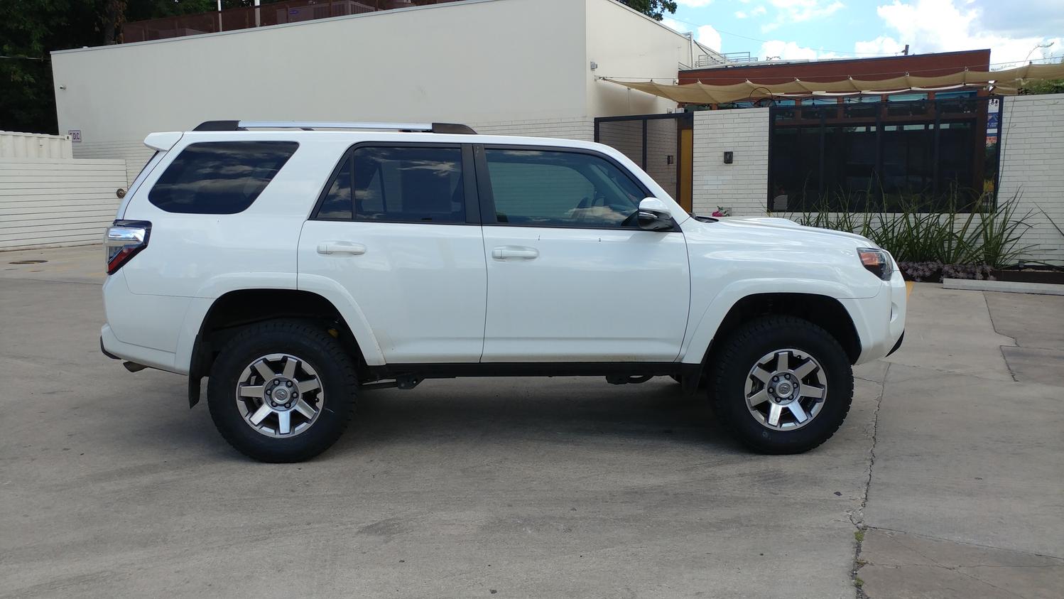

Installed my Dobinsons 2.5/1.5 setup last weekend. Everything went smooth. Running JBA UCA’s up front.
Thanks to Mike for always answering his phone, replying to all my emails and setting up a package for me based on my plans for truck!
Running 285/70/17 KO2 Jeep Rubicon takeoffs. Got them for hella cheap with a spare too!

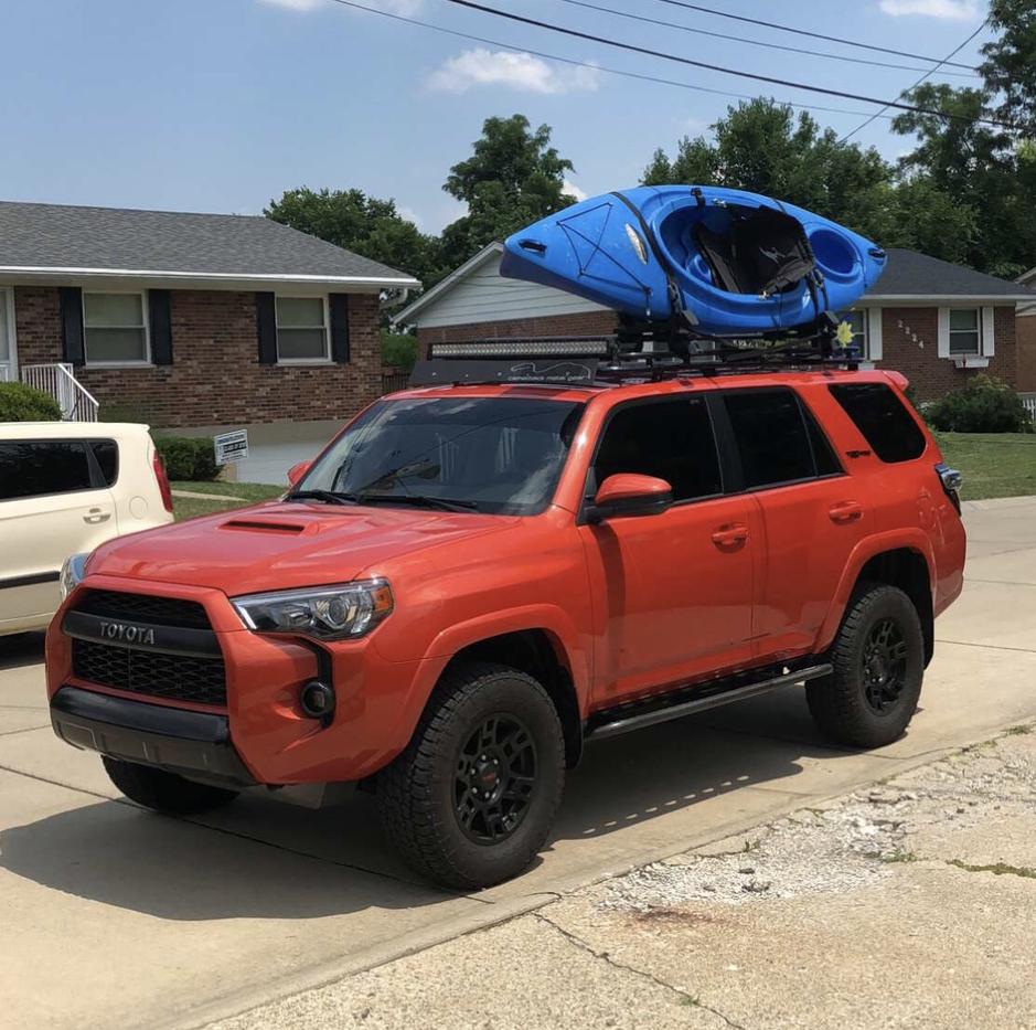

1" Pro springs (C59-748R) with C59-599 rear springs. This thing rides fantastic and Mike's customer service was great!

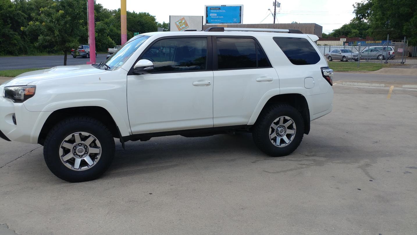

here is a side shot of the c59-325 rear springs w/ the shrockworks bumper and about 150 pounds of stuff in the back. I'm surprised it didn't sag that much. I still have to put on the 5th wheel, so we'll see how it sits after I add a bit more weight to it.

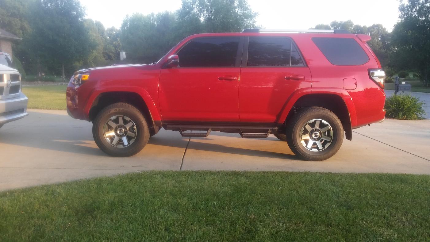

Got the setup installed and it's been driving like a dream!
C59-300 front coils (red)
C59-599 rear coils (red)

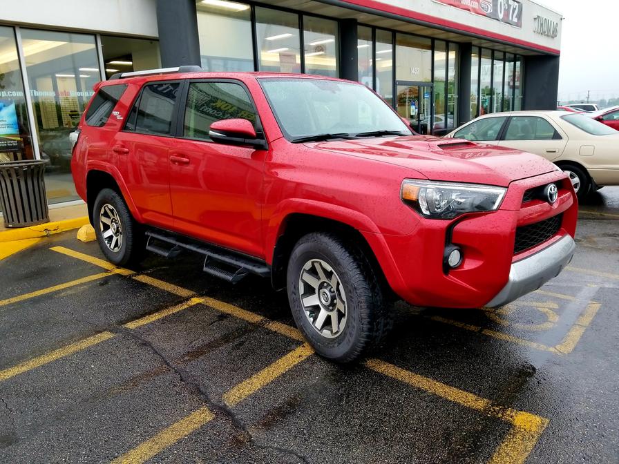

I completed my install a couple of weeks ago, but with Dobinsons shocks (see my signature for details). Absolutely the same driving experience, dramatically improved over stock. T4R OR models should come this way from the factory!
I'll also comment on the quality of parts and service via Mike at Dobinsons:
The parts are exceptional. Spring powder-coating is first class, very impressed. Ordered my struts pre-assembled and they were perfect. No adjustment needed, slipped right into place on the first try.​
Mike was also a pleasure to deal with, communicates well and makes time for his customers. Could not expect better service- thanks Mike!​
After pics:
