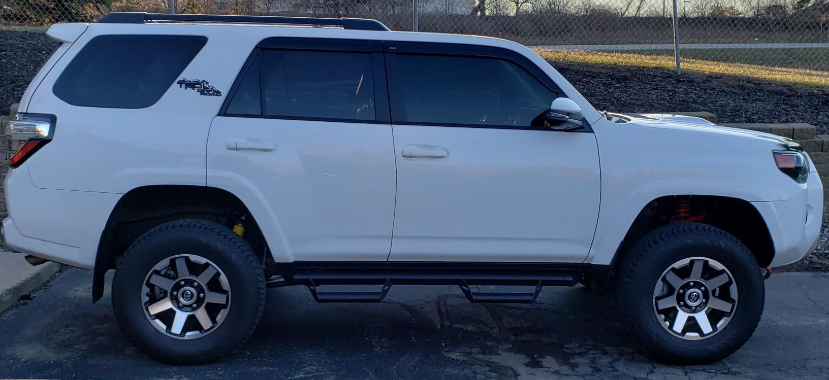

Dobinsons kit installed yesterday.
Front Springs:
C59-300 - Stock front end load, 1.75" lift
Rear Springs:
C59-505 - Stock rear end load, 1.5" - 1.75" lift. , 220lbs.
Front Strut Options:
GS59-574 - Twin Tube, fixed mount (not adjustable), long travel, adds 1" lift
Rear Shock Options:
GS59-701 - Twin Tube, suits 0-2" lift.
JBA UCA's
Stock size tires for a few days.

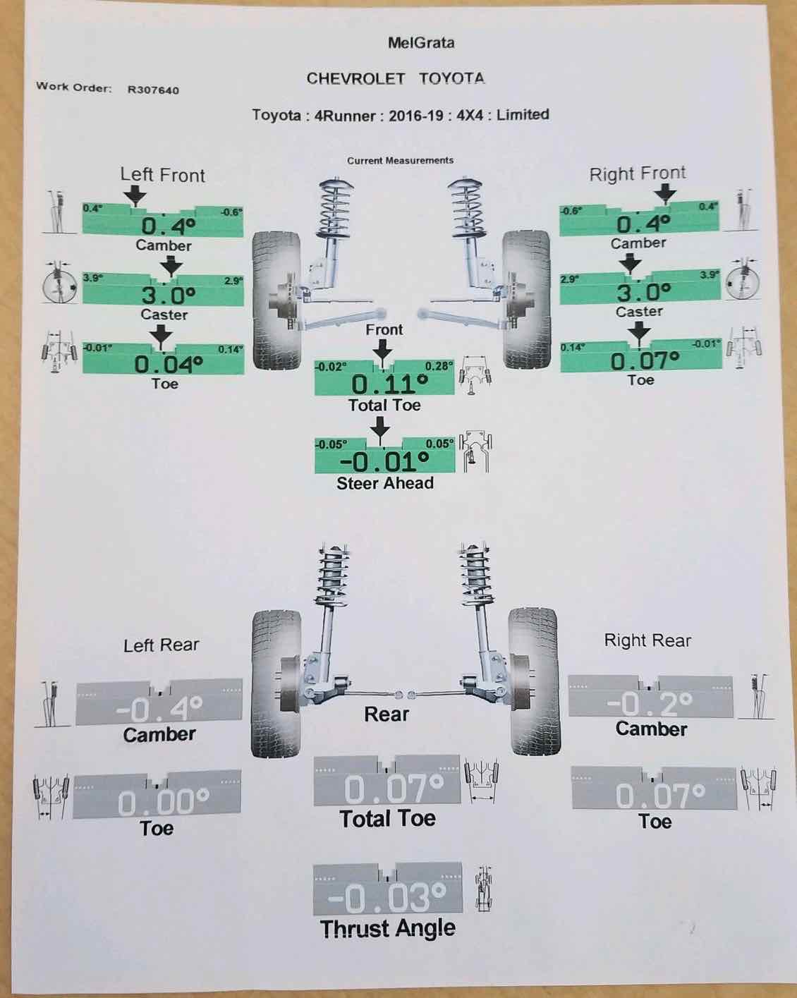

Included my alignment numbers. The tech told me that's the most caster he can get and if it were any higher he would suggest UCAs.

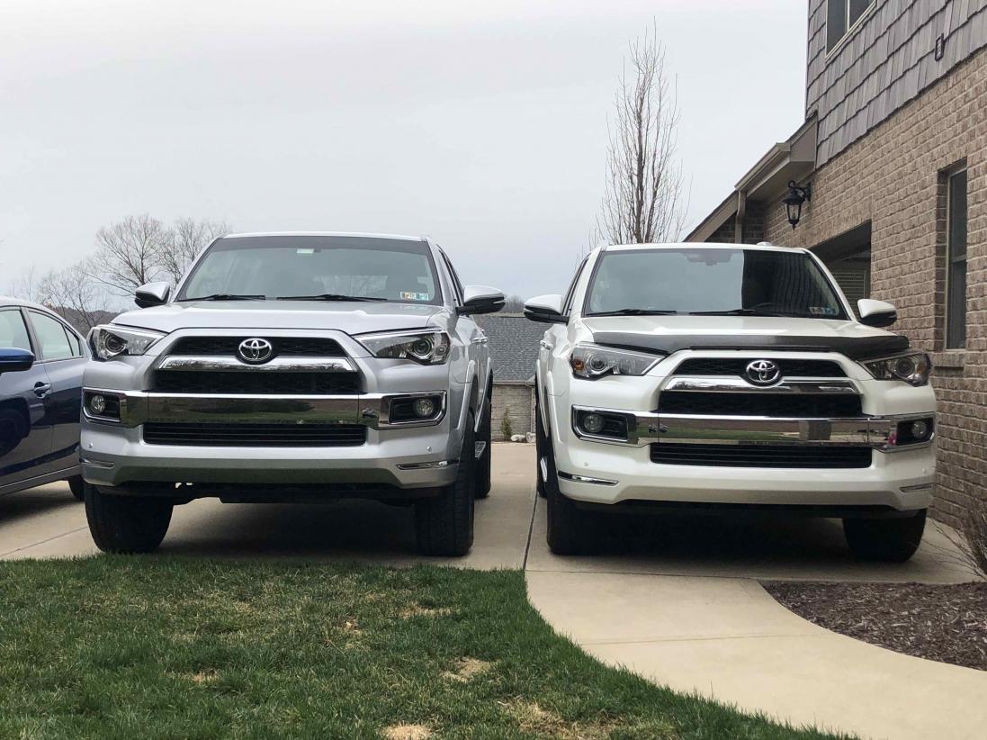

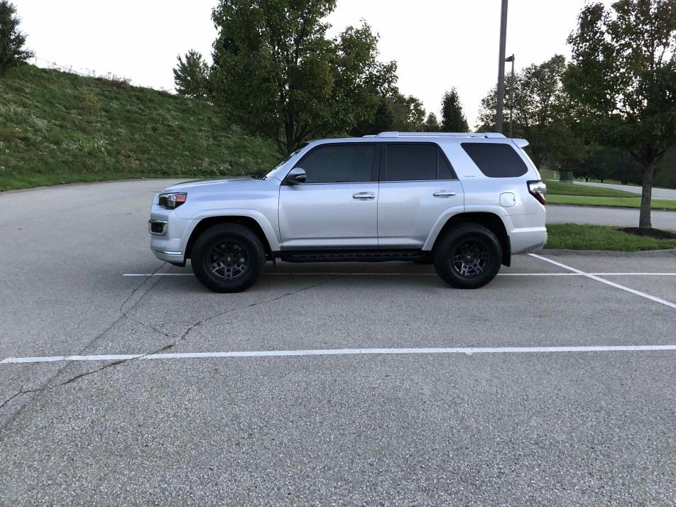

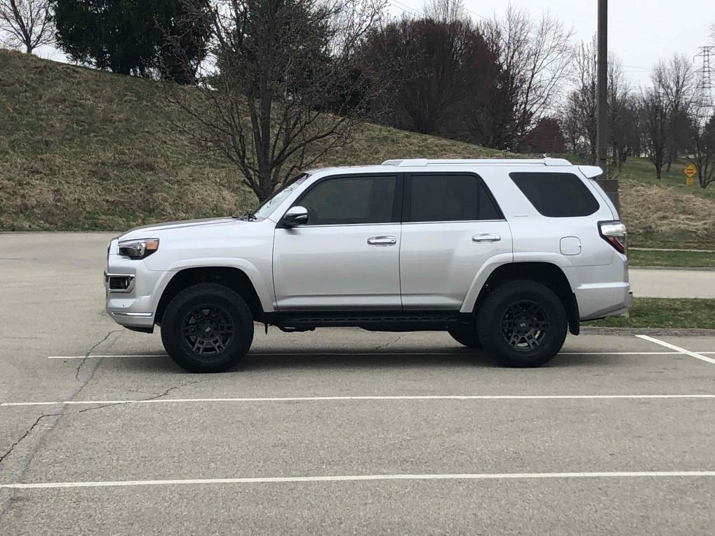

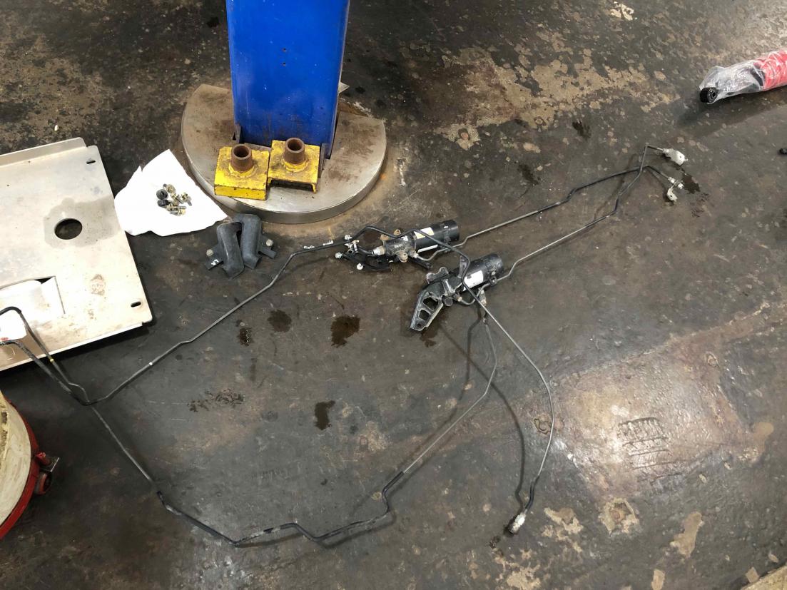

Also my tech was able to remove the XREAS system w/o loosing fluid. I could easily go back to the setup if I wanted too (which I don't). Included pics of the wife's LE next to my lifted LE. As well as before an after pics. And I can't figure out how to edit and put descriptions on the pics.
