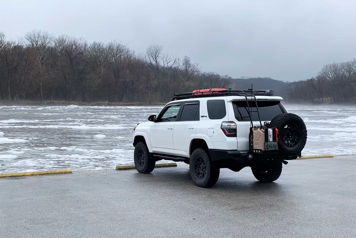

Loving my 314/327 combo.
Pairs great with my SSO Slimline / x20 in front along with Shrockworks rear bumper loaded up!

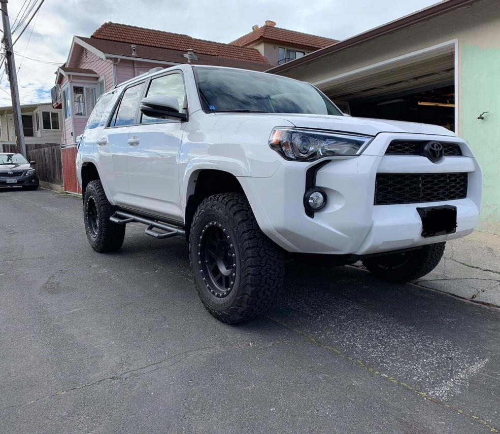

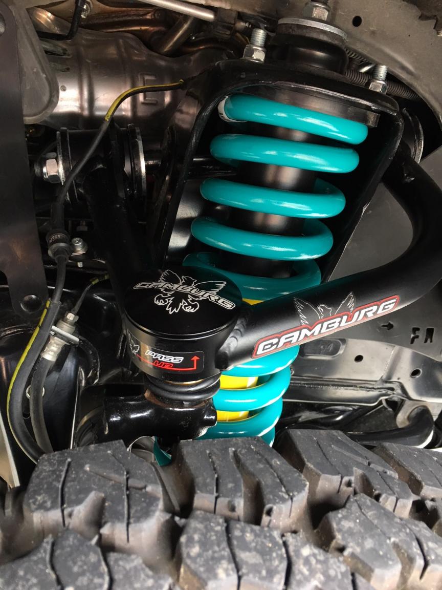

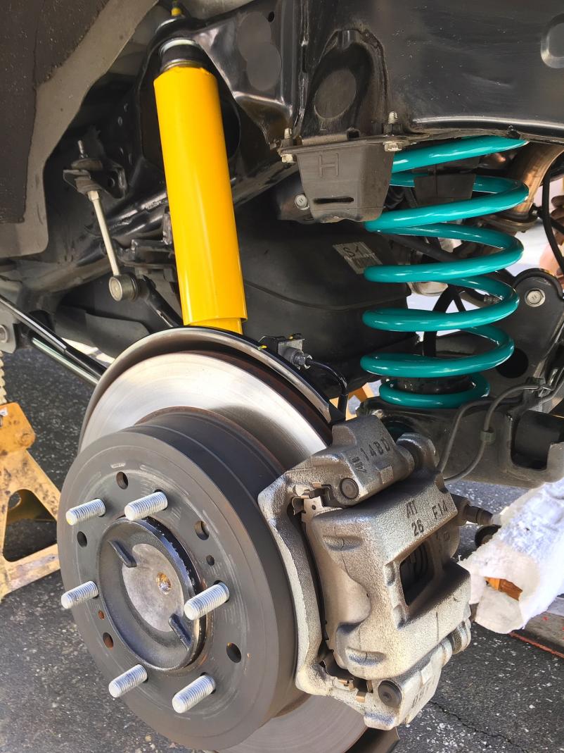

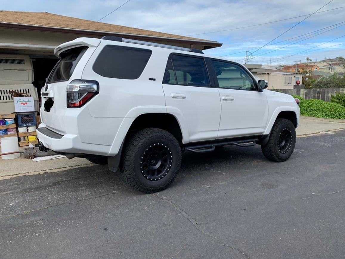

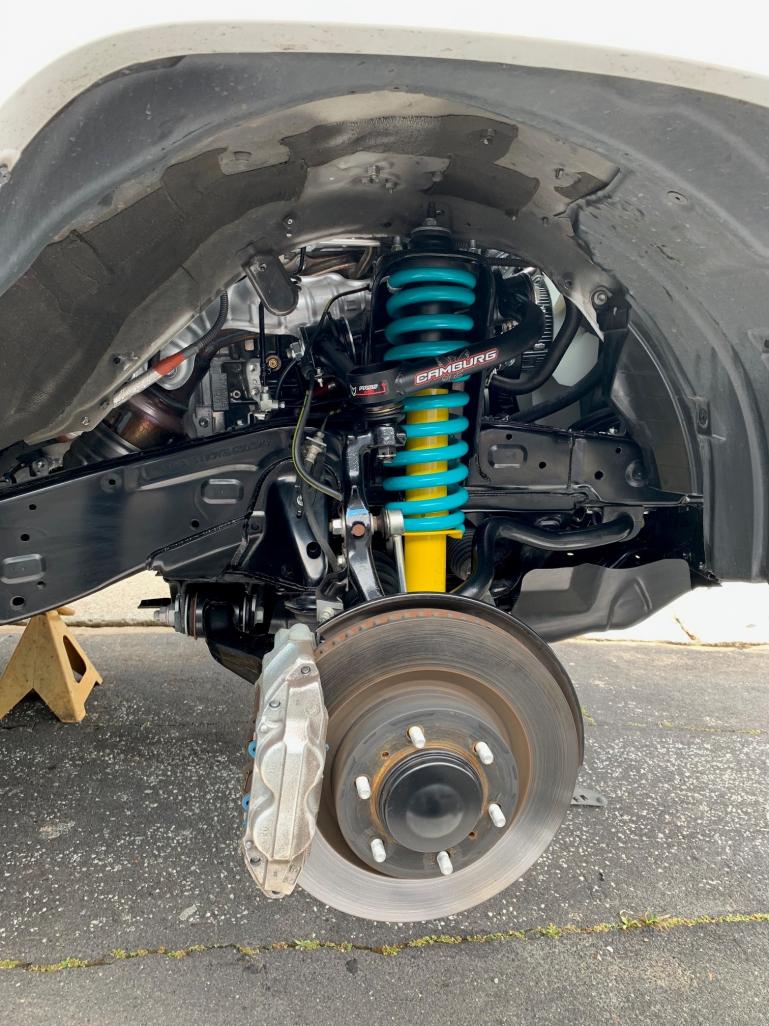

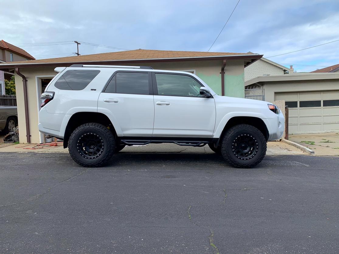

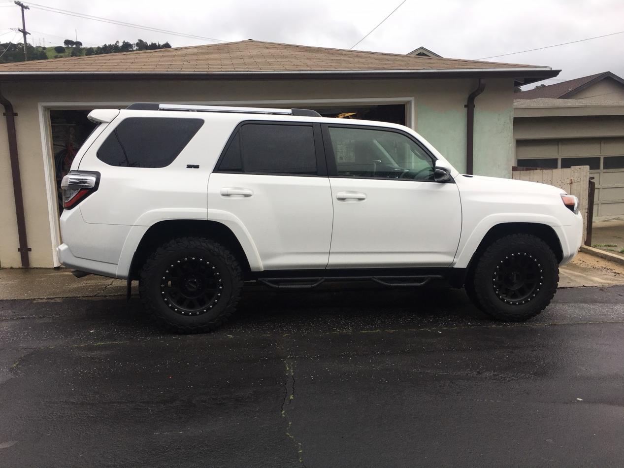

Just installed this past weekend on wife's 19' SR5P (w/third row)
Front: C59-302/GS59-700 w/ Camburg BJ UCA
Rear: C59-505/GS59-705
Tires: BFG K02 275/70/17
Wheels: Method MR306 17 x 8.5 4.75bs
Only have about 100 miles on this setup but so far so good! Top pic is with stock suspension.

After not being able to find a local shop that was willing to do the alignment, I took it to the dealership. Luckily they weren't much more expensive than the independent shops.
I wanted to thank Mike for his great customer service and recommending which parts I should order to achieve exactly what I was looking for.... mild lift, maintain 265 tires, and better performance on and off road.
The ride is so much better that my wife even noticed the difference.. and she normally only cares about how fast cars go.
I'm running 265 Falken Wild Peaks and have SSO sliders...
Here's a side by side pic of mine on the left and a buddy's stock on the right.
[/url]IMG_1776 by stgo2019, on Flickr[/IMG]
