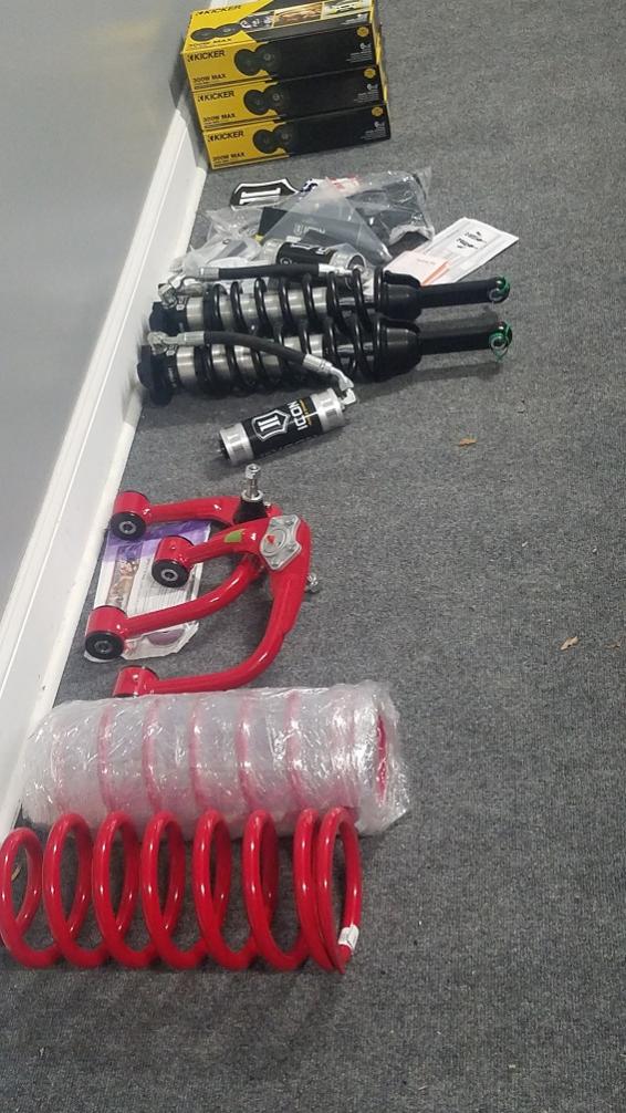

Just got my Dobinsons installed and they are fantastic! I got mine coated in red (sacrilegious I know) but now they match my JBA UCAs. Mike was fantastic helping me choose the right spring for my (future) needs. Quality product and service for sure!

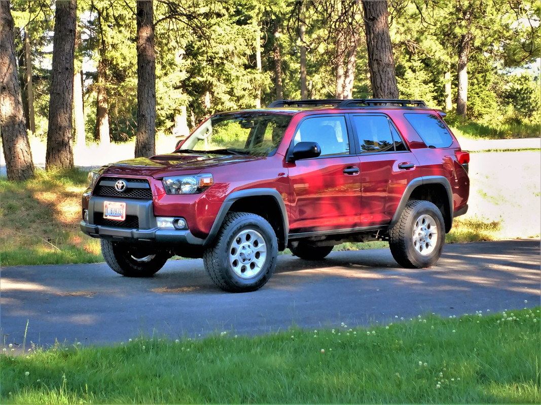

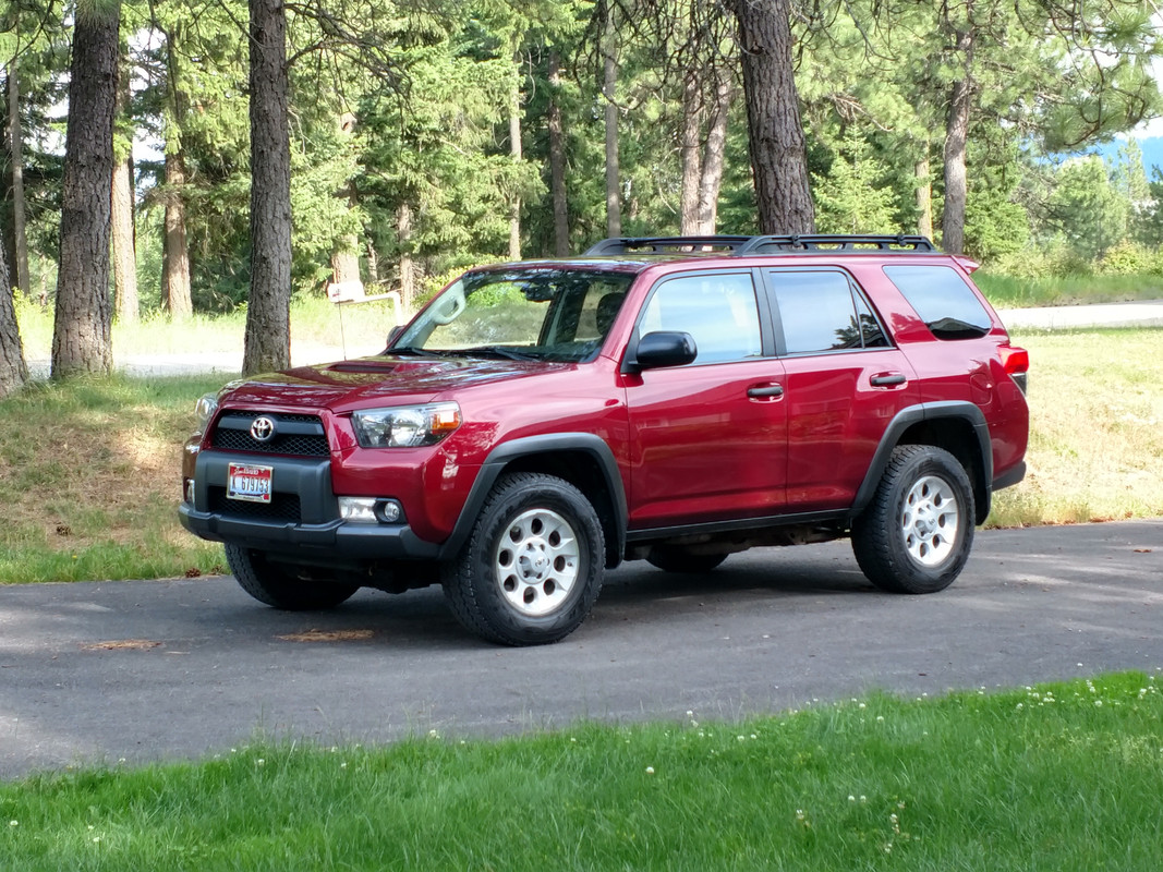

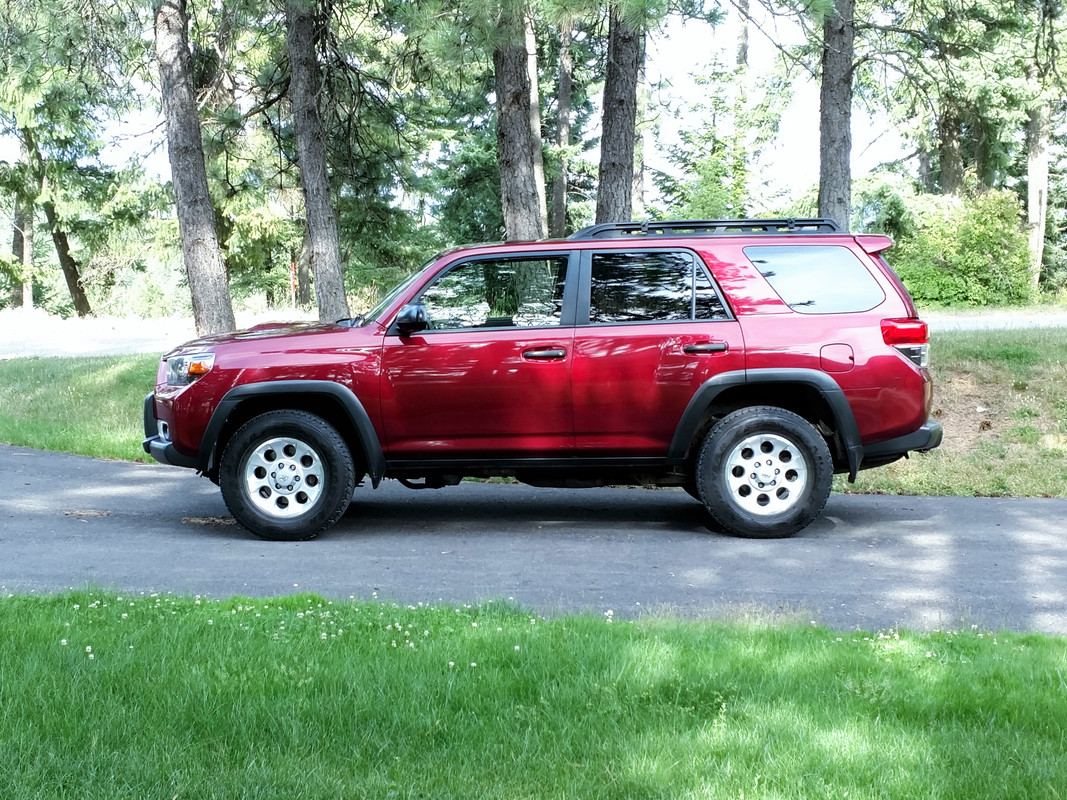

Finally installed!
Back in early January, I asked Mike@Dobinsons for some recommendations. I wanted a slight lift, wasn't concerned about eliminating the rake, and wanted an on-road ride at least as good as stock. Usage was mostly on-road/highway, with Forest Service and Ranch roads, light trails, some towing of a light boat and ATVs on trailers. My new-to-me T4R has 94K miles on it, much of it in the NE, so install was a messy, rusty endeavor.
Can't emphasize enough just how on-target Mike's recommendations were. Only about 15 miles after the install and no alignment yet, so they may be some settling, but here you go. Ride is more compliant than stock, smoother overall with less "jolt" on both high and low speed bumps and upsets. Less likelihood to "hop" over washboard. Less body roll even with the KDSS.
Currently on E-rated Goodyear Wrangler Silent Armor 265/70s. May have to run 285s after all (or at least a beefier 265)!
C59-300 over GS59-700 in front
C59-723 with GS59-705 in rear
Firestone Ride Rite airbags installed in the event I tow heavy.
Before/after
DF-34 1/4 to 36 3/8
PF-34 1/8 to 36 1/2
DR-36 7/8 to 38 1/2
PR-36 5/8 to 38 1/2
Before/after side and quartering:
