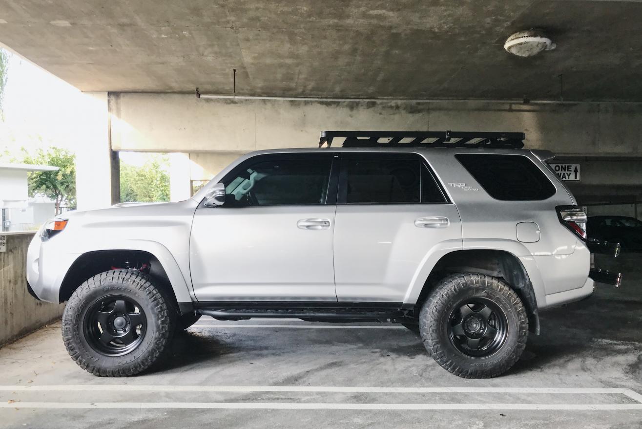

Here's an updated pic
F C59-302 2.5" lift
R C59-xxx 2" lift not sure what model springs I have
285/70/17 Falken AT3W
