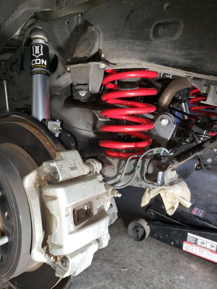

added Dobinson c59-505 rear springs
C59-505

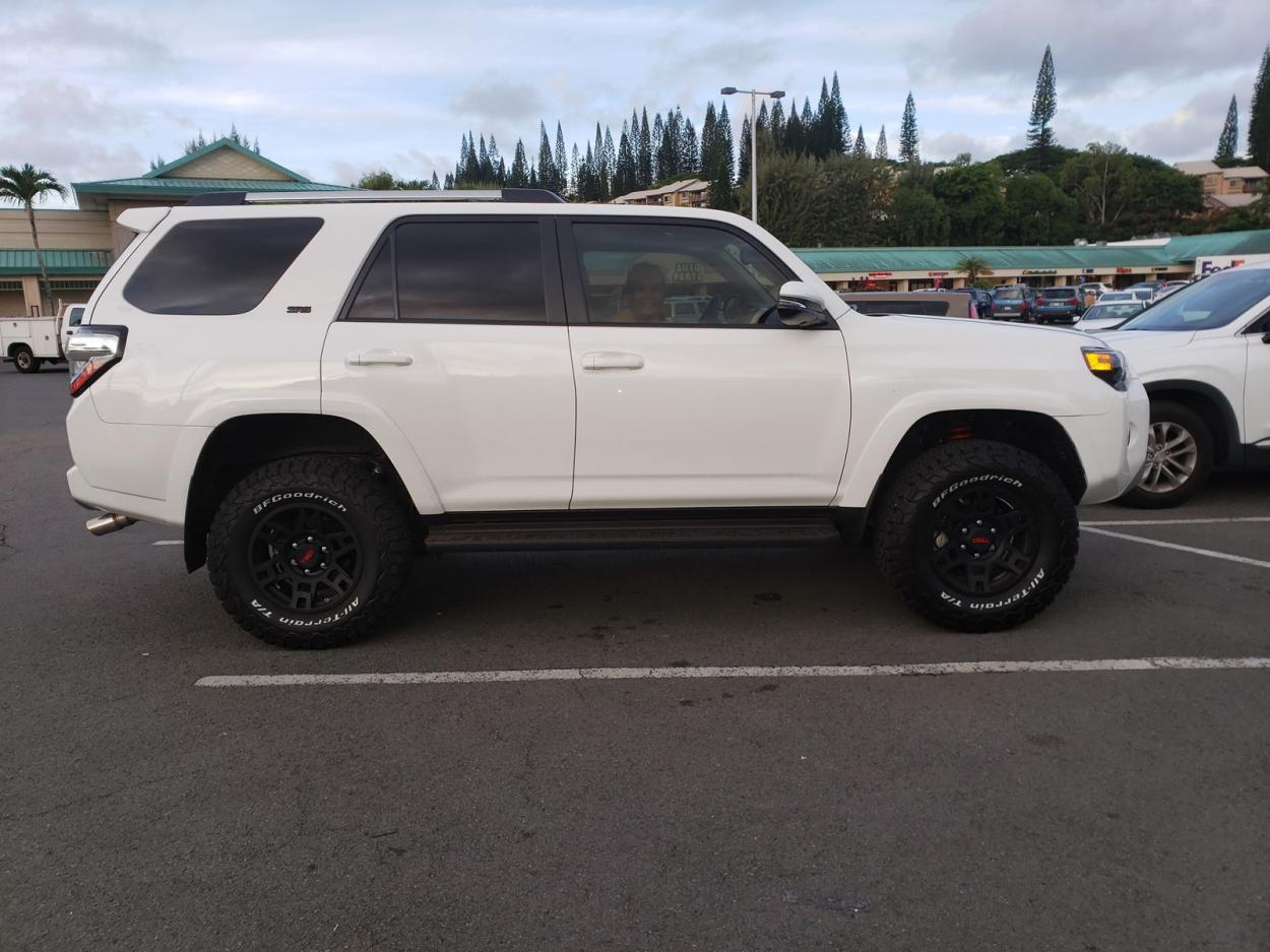

Thanks, do you have any pictures of your current setup with with 302s?
I've got 300/574 struts in the front and 327/701 in the rear... My driveway is sloped ever so slightly downward, but the truck definitely has a notable rake to it
