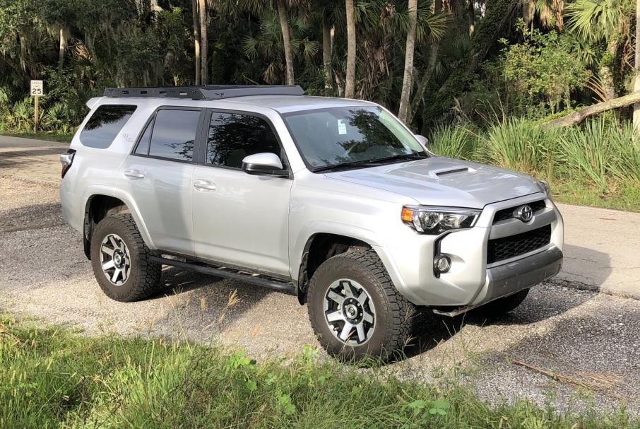

For those wondering what 275's look like with the 300/599 combo, here you go.
Rides great, looks amazing. Super happy overall, thanks Mike!
