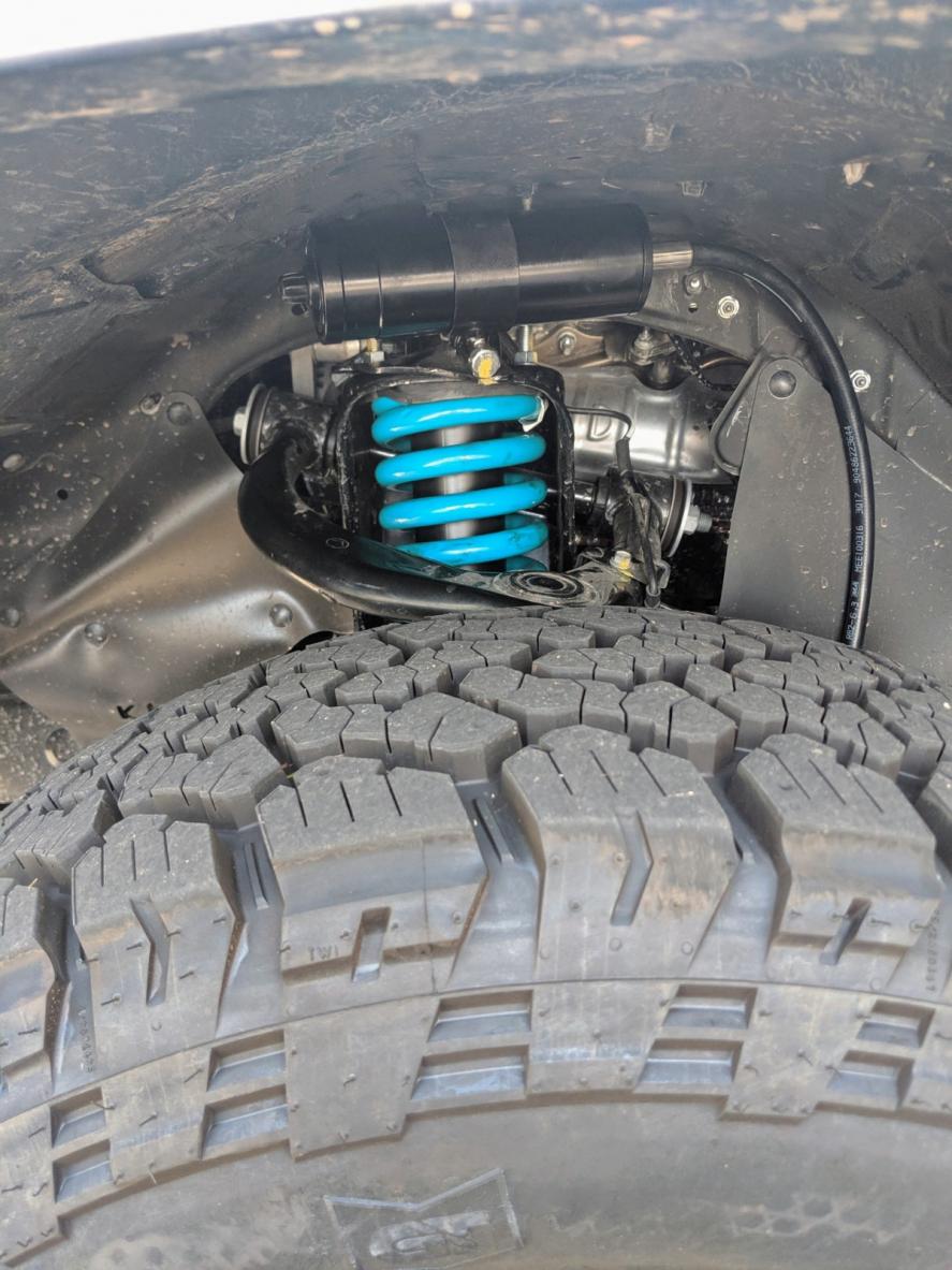

Make sure you do a full travel/flex test before going out. I don't think that reservoir mounted on top will last, as the UCA might hit it on full up travel!! That wouldn't make for a very fun experience. Most mount them forward on the frame rail, nearest the bumper.

Mike, definitely will! the shop, that I fully trust, tried different locations including the the suggested spot for the kit and ended here at the top of the strut tower because the other locations were getting super close to the tire at full lock. Ill talk to the shop about mounting it forward. Thank you very much for letting me know.
It might work there, but the UCA's do have a pretty big upward range of motion, so that would be the main thing to check with a flex test.
Just called them and they did a full flex test on the car and said I was good. I am going in next week for a safety check anyway next week and I will discuss further with them and talk about moving the reservoirs. Also I think they were going to contact you through email soon. Thank you so much for the messages, this is one big reason I went with Dobinsons because of the customer service. so thank you!
