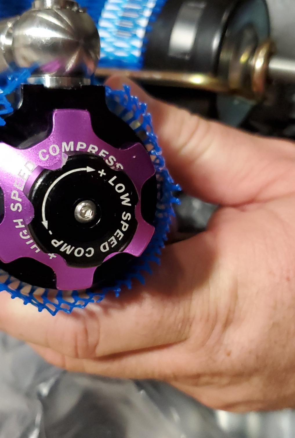

Still waiting for all the stock to arrive so that we will be able to sell it for all the major models. But here's the lowdown.
10 stage high speed compression adjustment
20 stage slow speed compression adjustment
15 stage rebound adjustment
On the struts, rebound adjustment is from the top stud, quite simple to get to above the strut tower.
On the shocks, rebound adjustment is in the lower mount.
High and slow speed adjustment is both handled at the reservoir front and rear.
All in all, they look a lot like the standard MRR shocks we have had for some time, but they include full swivel fittings on the reservoir hose, both ends, to avoid it becoming loose and ease of installation and orientation. But with all the adjustment, you could literally tighten them up so much to essentially stop all movement or soften then up to suit it however you like. The range of adjustment is massive which is excellent for those going from no load to heavy loads, or those that want it softer on the highway than while offroad.
4runners will still not use a piggy back mount for the reservoir.
