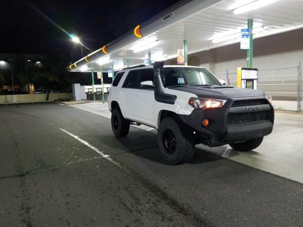

I never got around to ordering new springs to level. I moved and that must have done the trick because now the truck is sitting much better.
Very please with the ride. Won't be swapping springs till I add steel. Just need a fresh alignment.
