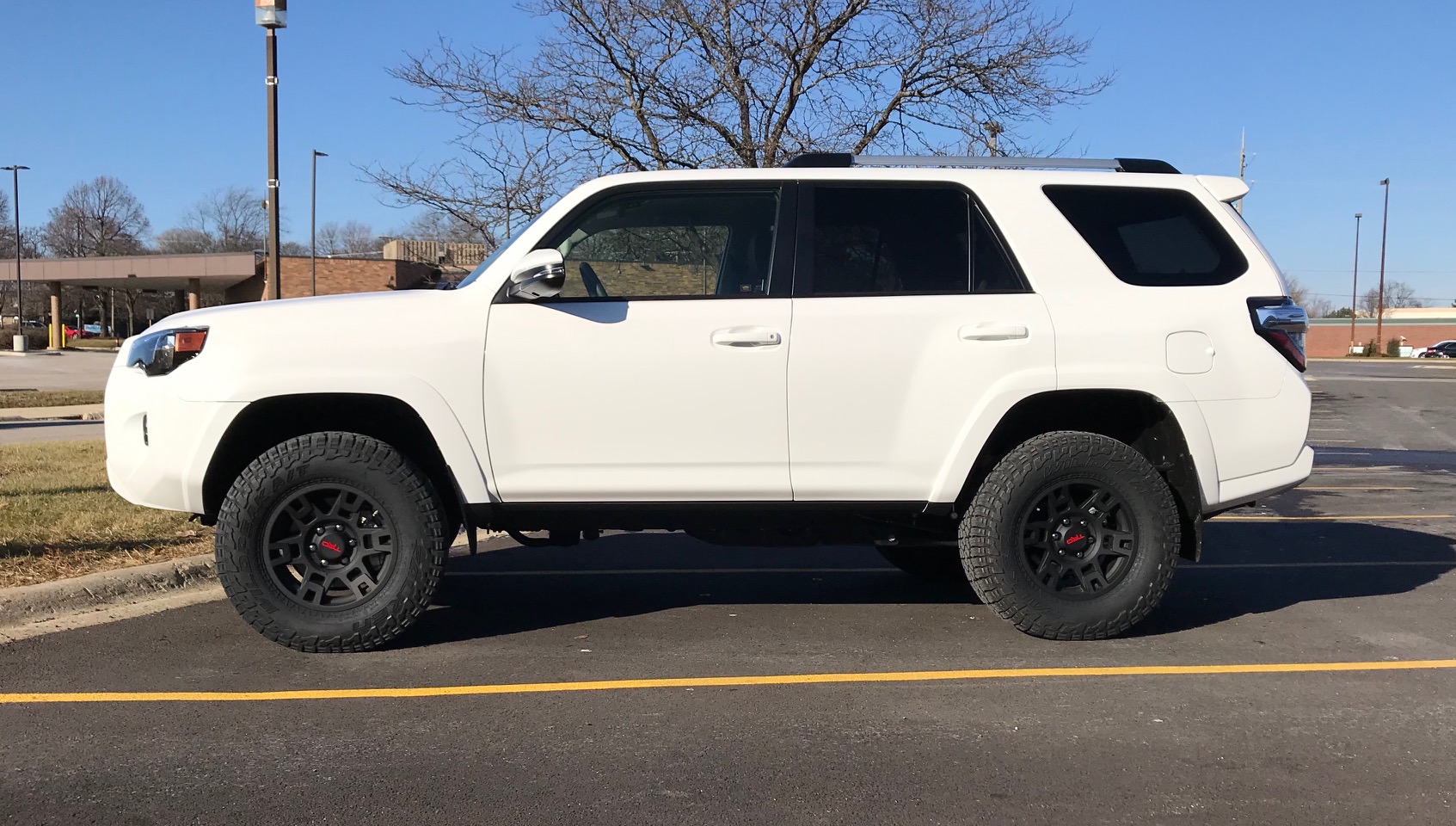

Just installed the Dobinsons C59-300, C59-599 springs. Tires are Falken Wildpeaks in a 275/70R17 flavor. I love it. :)

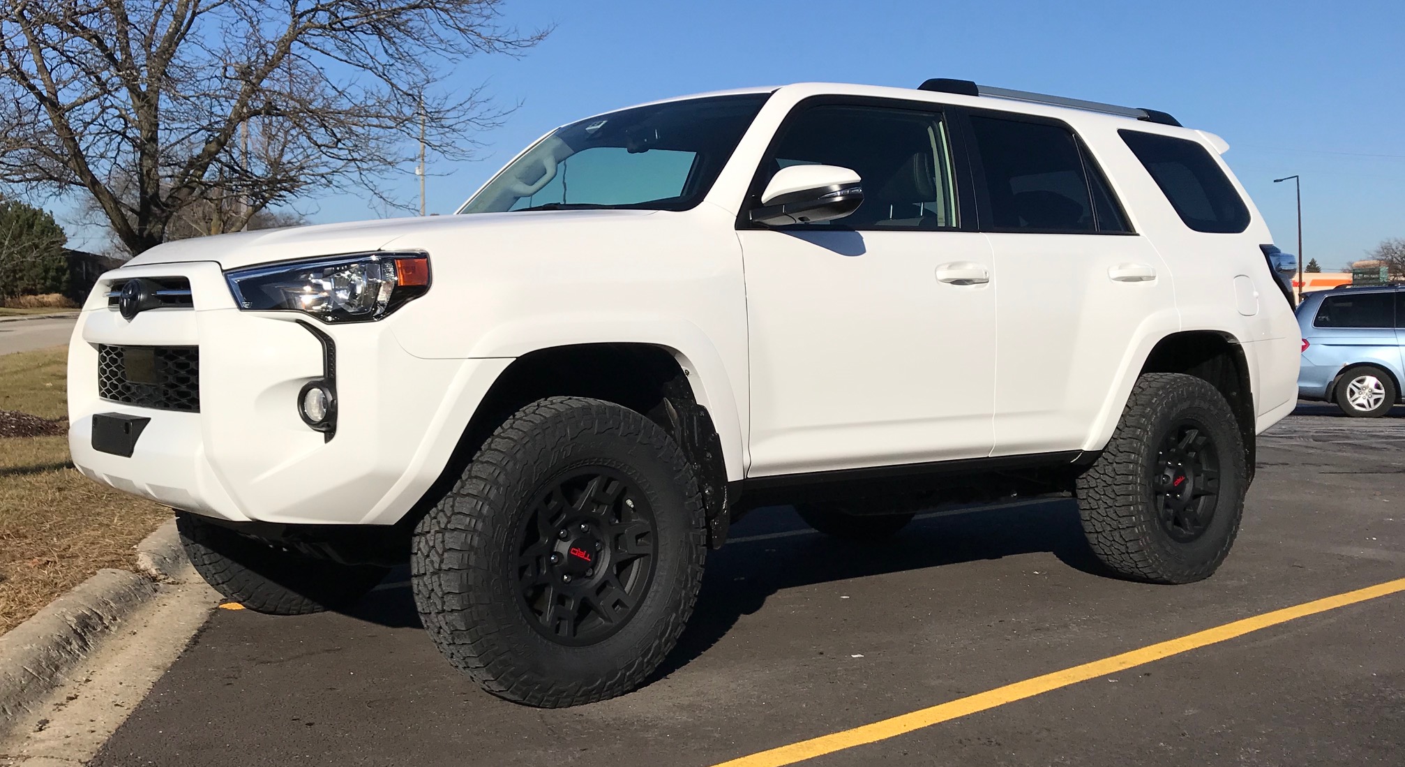

Center of hub to bottom of fender measurements added below.
Post lift
Front L- 22.5" Total Gain- 2.25"
Front R- 22.75" Total Gain- 2.5"
Rear L- 23.5" Total Gain- 1.5"
Rear R - 23.75" Total Gain- 1.5"
302/505 springs and 700/705 shocks with Dobinsons UCAs. 275/70/17 Wildpeaks.
