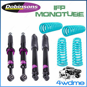

Is it possible to order a Monotube setup without the remote reservoir?
They make a non res mono tube. It’s called an IFP. I wanted them a year ago but I can’t remember if they didn’t have them in the US or if was the cost.
Thanks man! Those are exactly what I was hoping they carried as an option. I’ll wait for Mike to come back to see if they sell those here, but having gone through quite a bit of this thread,I don’t think many here have had real world experience with this particular set up though I guess the ride (for what I am looking for) would be quite similar to the mono tube RR shocks...
