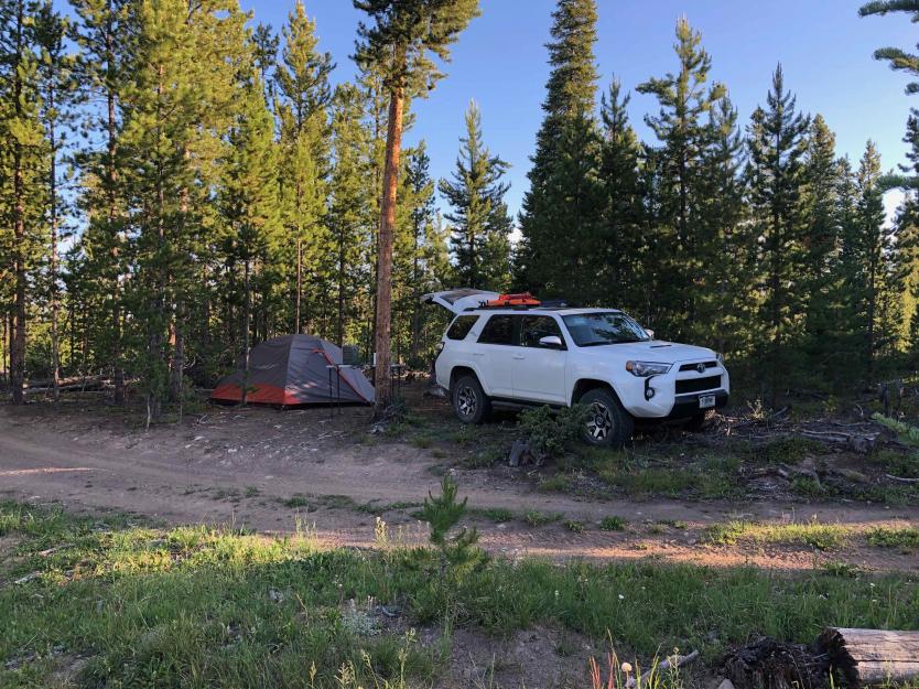

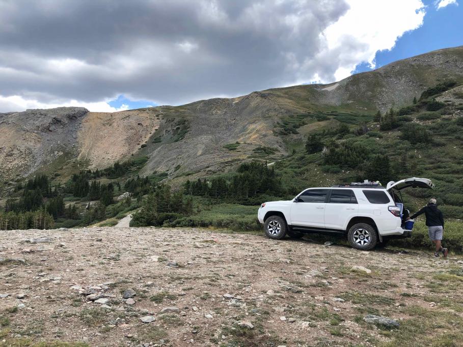

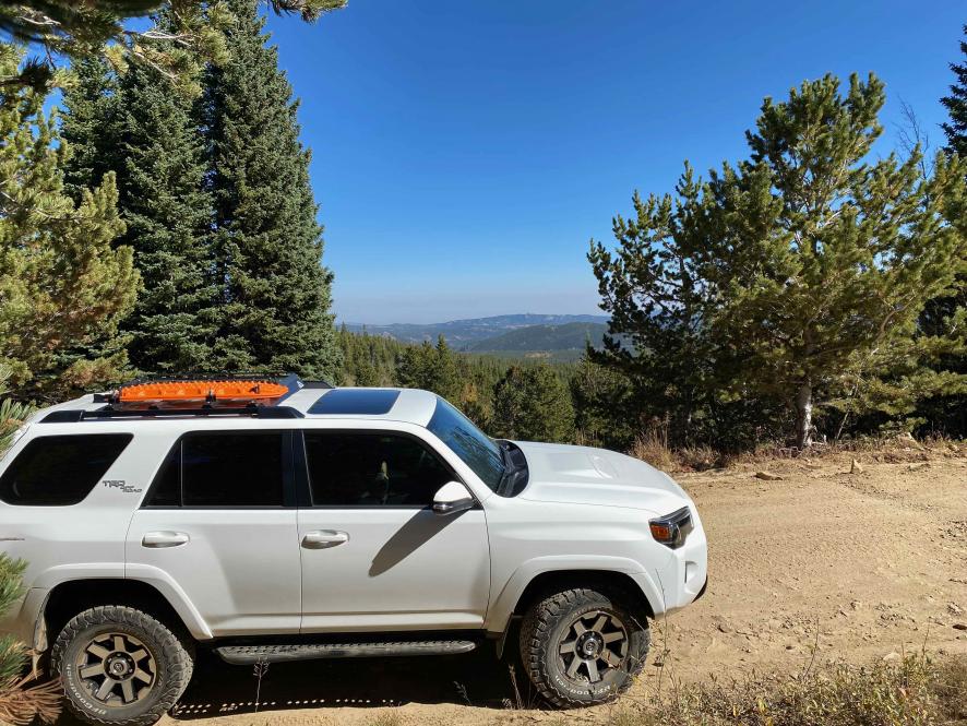

Do you happen to have some side pics with your new lift? Not many pictures with 296 upfront.
Here's what I got. Really happy with the lift. No power loss from bigger tires, and I get this truck everywhere. I did purchase aluminum skids, if I did it again I would go with steel because I do hit pretty hard sometimes due to the lower lift.
Truck looks great! Nice to see a change up from just the 3/2 lifts - it's subtle and looks how the truck should've come stock!
