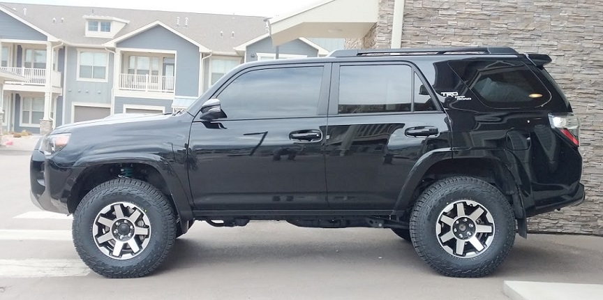

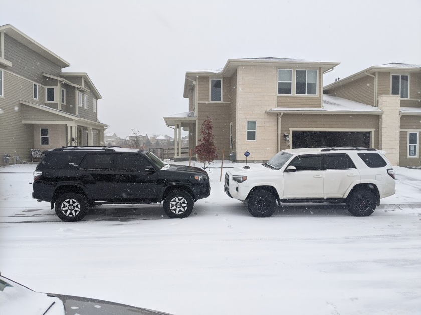

I'm running the C302s with KDSS and the coil perches set at the recommended 213mm. I'm actually thinking of bumping them up closer to 220mm to gain an extra 0.5" of lift and be around 23" hub to fender.
I've a good amount of miles on offroading with this and zero concerns with the KDSS being lifted.
My truck is the black one. The white has the C302 coils and C505 in the rear, his rear end is approx. 0.65" lower than mine with C725 coils
