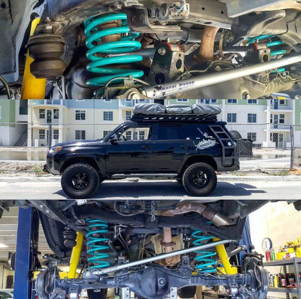

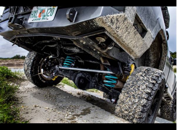

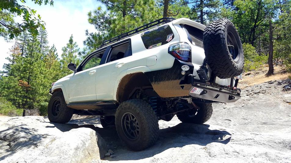

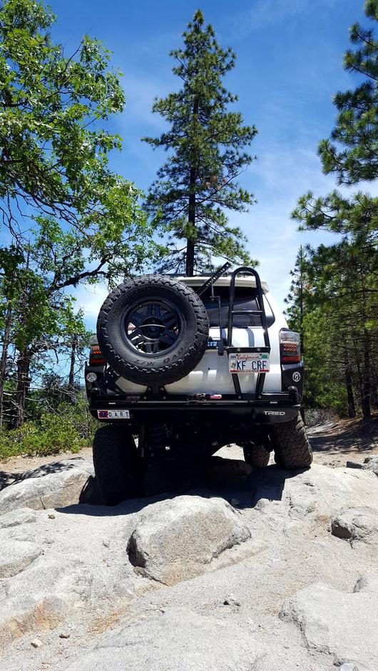

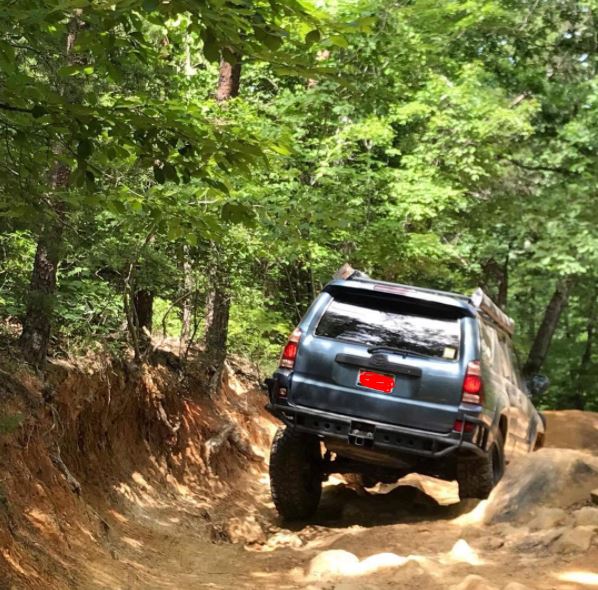

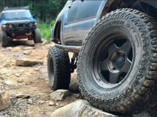

Here are some photos of the coils in action from various customers:

I see someone has an upgraded panhard rod, is that recommended with the lift?
We also sell those too, part number PR59-1423. It's not required though. It would be recommended if your axle becomes off-center from the lift added to it.

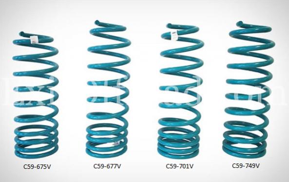

Bringing this thread back to life, just updated post #1 with the latest and strongest 4th rear 3" long travel option, the C59-749V, and also have this photo of each coil side by side.
They're sitting upside down of course, but you can see the difference between them.
Don't forget, they're offered in teal, black or red powder coat with no additional price difference between the colors.
C59-675V - Dobinsons C59-675V Rear Variable Rate Long Travel Coil Springs for 4Runner, FJ Cruiser, GX470, GX460
C59-677V - Dobinsons C59-677V Rear Variable Rate Long Travel Coil Springs for 4Runner, FJ Cruiser, GX470, GX460
C59-701V - Dobinsons C59-701V Rear UHD Long Travel Coil Springs for 4Runner, FJ Cruiser, GX470, GX460
C59-749V - Dobinsons C59-749V Rear Extremely HD Long Travel Coil Springs for 4Runner, FJ Cruiser, GX470, GX460
