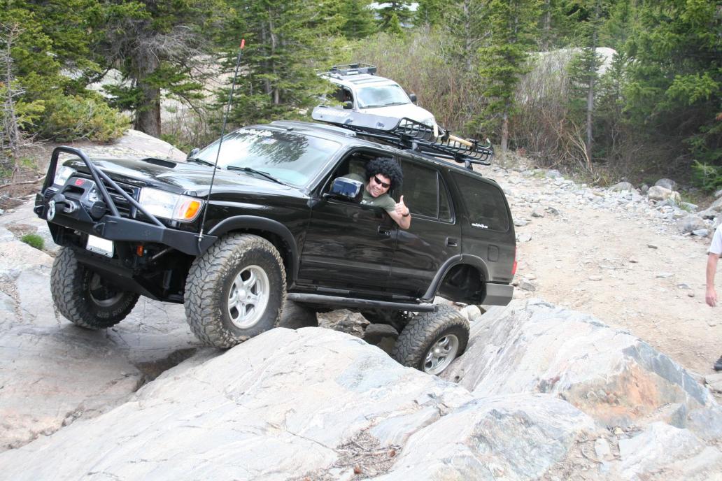

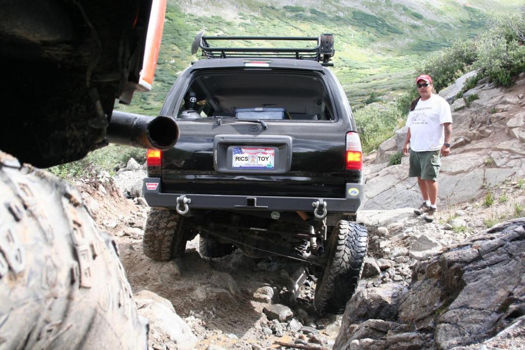

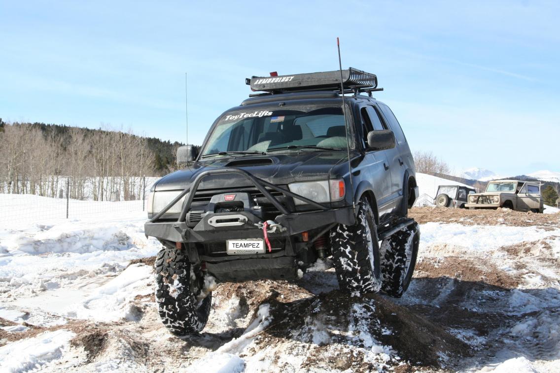

I installed the Dobinson LT shocks last night with Durobumps on Superflex HDs. Took out some jimmyrigged Procomps for a Tacoma that gave me the travel. Lost 1/4 to 1/2" it appears that the new shocks are not soaking up but its not settled yet. Had 3.6" lift with the HDs. Seems ride is nice but will take out this weekend and test more extensively. Need to change the brake lines.
thats pretty good, I really like the flex from my toytec lift
