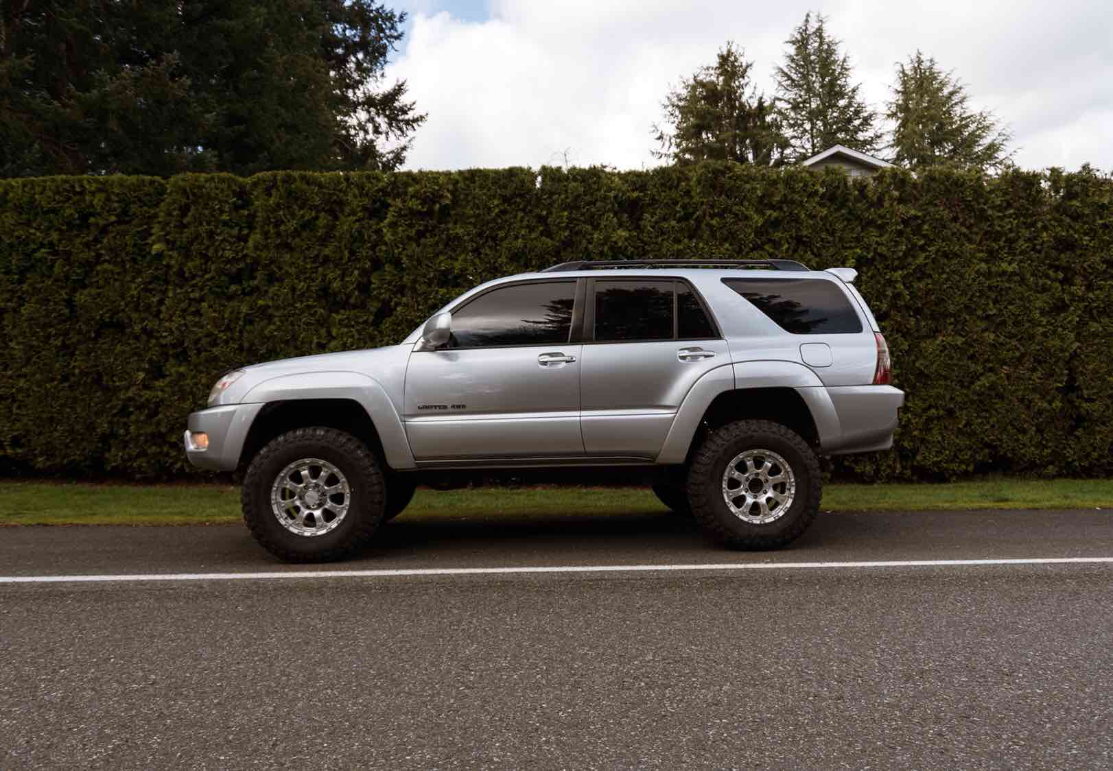

Finally got around to installing my suspension this past weekend. Tires are 295/70/17.
Up front: C59-300 paired with GS59-220 and a 1/4” top plate spacer.
In the rear: C59-677v paired with GS59-575. No weight in the rear. DSC_4274.jpg

that's all the height you got in the rear with a 2.5 - 3" 400lb+ spring and the longest shock they offer? I would've thought it would be much higher. front looks about right. I would be I would be hesitant going with anything smaller for a 3" front lift, even without those 1/4" spacers.
I was recommended to go with the C59-325 spring and GS59-705 shock in the rear for that same 3" lift up front (without the 1/4" spacer).
Maybe the C59-675v spring and the GS59-701 shock would be appropriate for the 3" lift up front?
Does that sound right? can anyone with familiar with the product shed some light on this?

No. There was just some anomaly with his situation that we couldn't work out why he didn't get the proper lift height.
I don't remember if that's what I recommended, but usually I wouldn't change it afterwards hahaha. That would be the right setup for a heavily loaded 4th Gen. Or you could go up to the C59-352 to gain additional height again on the front end, an additional 10mm of lift.
Your post is kind of backwards.
C59-325 spring and GS59-705 shock in the rear - That's for 2" rear lift, to provide a more level truck.
If you want more lift on the front, go from C59-300 up to C59-302. They're 10mm taller in free height and will add 20mm in lift.
